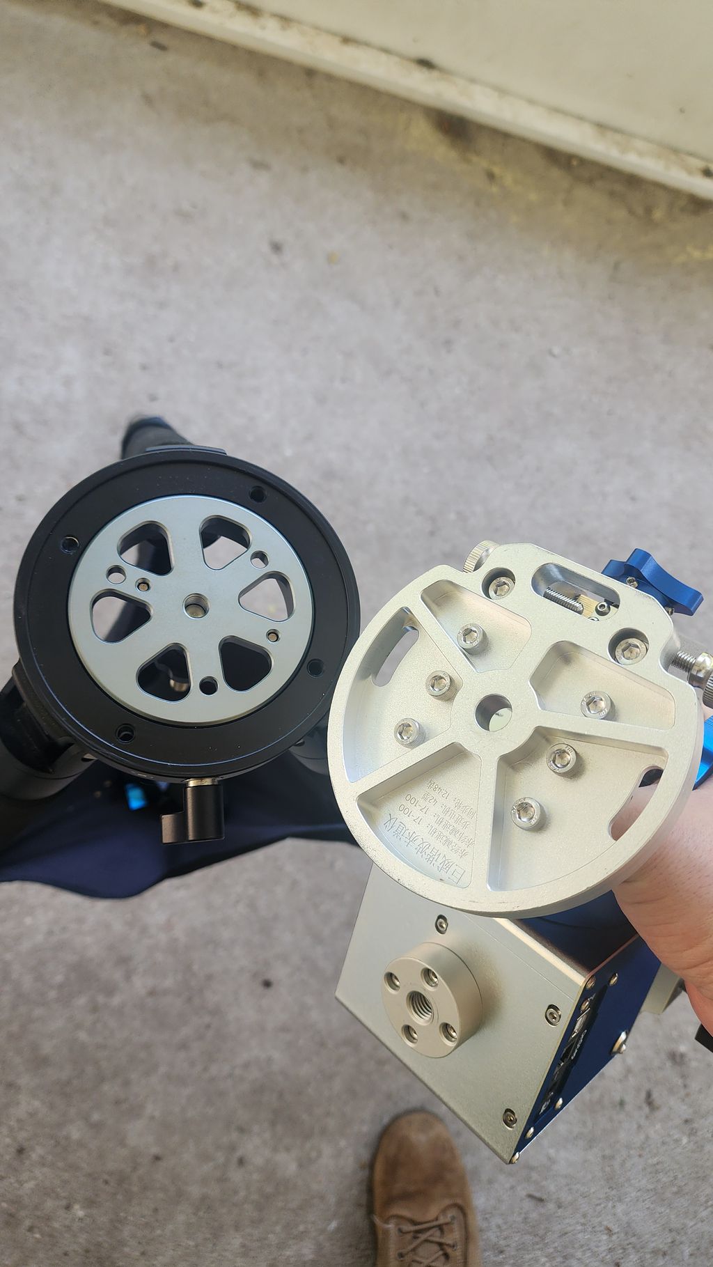

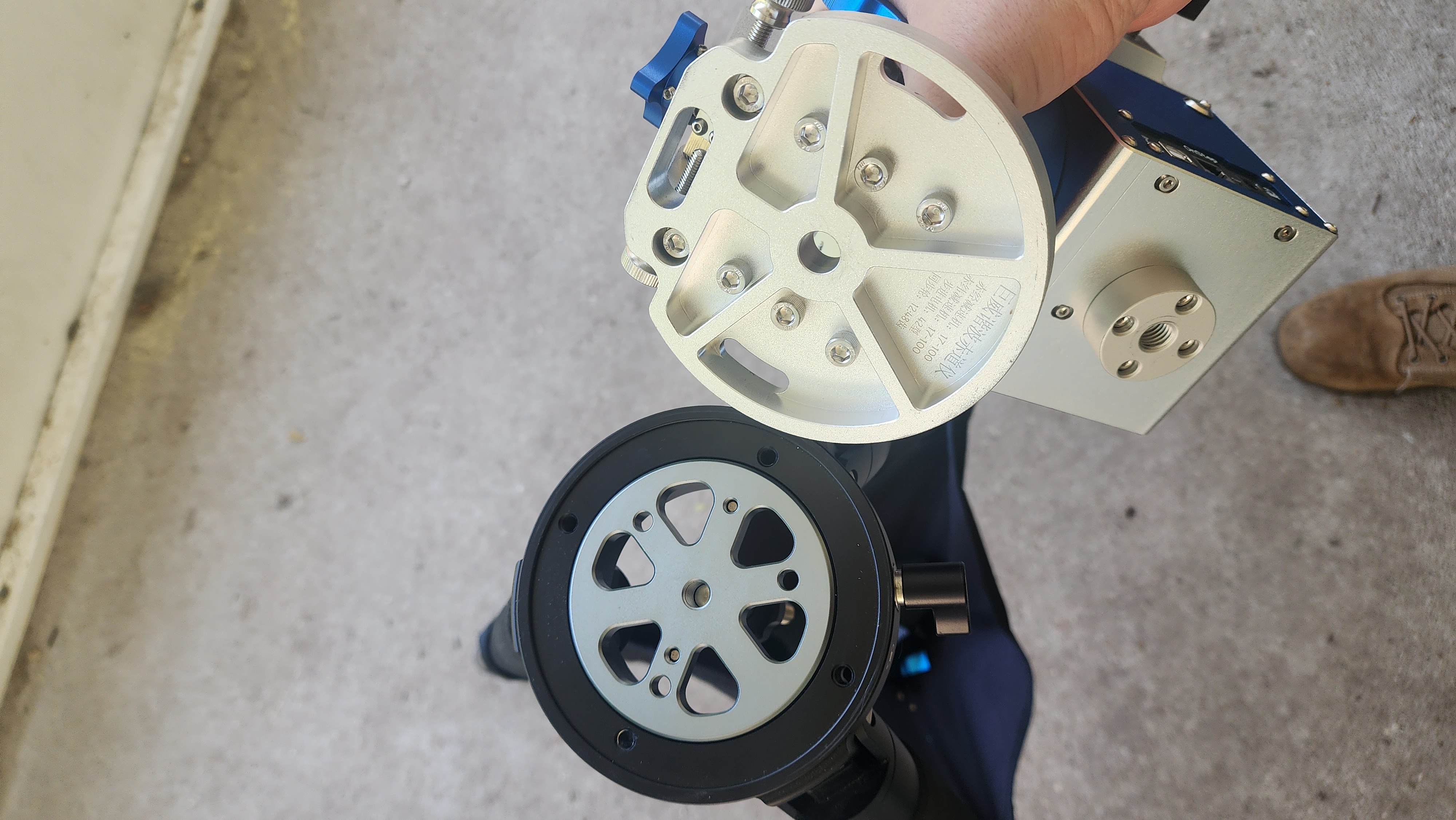

Here is the bottom of the Juwei-17 compared to the TC-40. There is nothing to mount to on the bottom of the Juwei-17, that's why you need either the pier extension or the adapter plate. The adapter plate will bolt to the puck piece of the tc-40 and lock in like normal. You will almost need the pier extension for any scope except very small ones, so I recommend that over just the adapter plate.  |

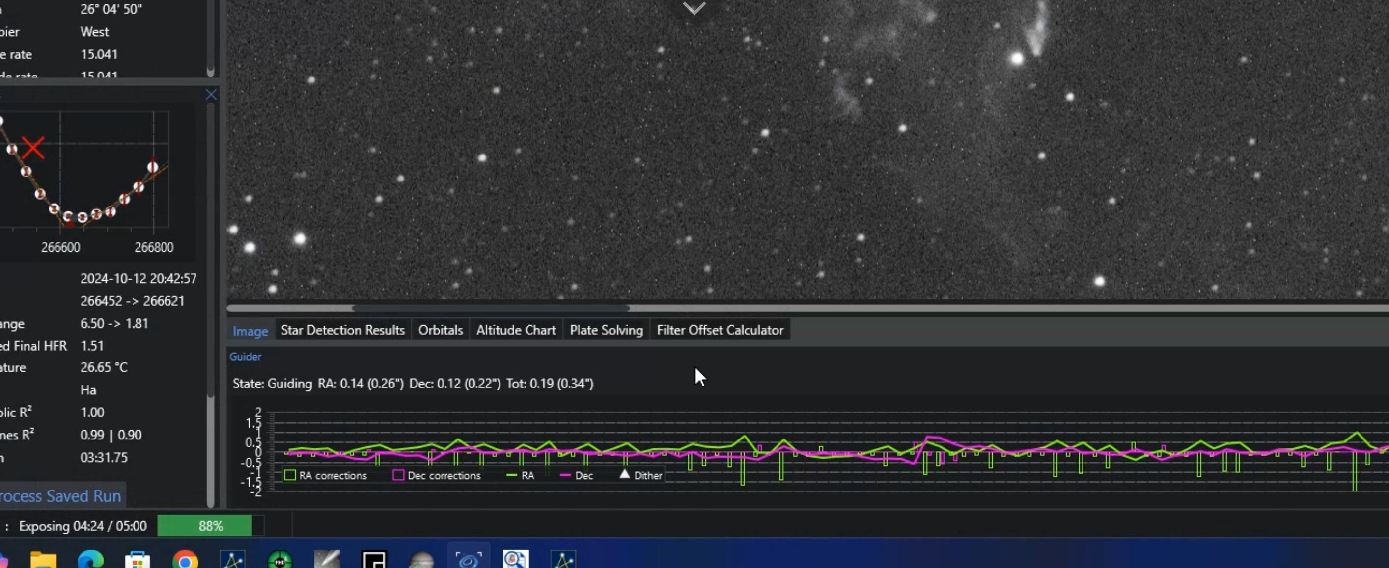

Guy my eye on these mounts for a payload of total 14kg. Any users on this thread with guiding stat's?

I would advise getting the pier extension either way which also comes with both the EQ3/5 adapter and the tripod adapter plate (at least mine did). So getting on my EQ5 tripod was a breeze. It doesn't add a lot of cost to the total package. Without a pier any relatively large scope with attachments will quite possibly crash into the tripod.

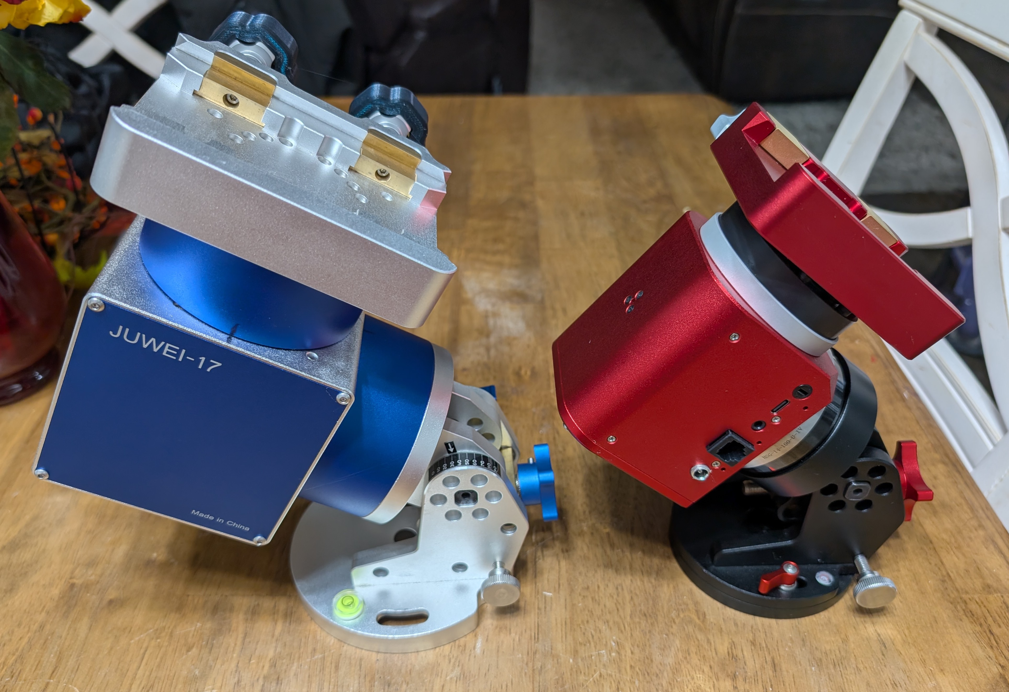

Great news, mine is also the blue. My Juwei-14 arrived this week, I went with red and black this time.  |
Great news, mine is also the blue. My Juwei-14 arrived this week, I went with red and black this time.  does the 14 have the same "footprint" as its bigger version? Might be an interesting future buy for me as well

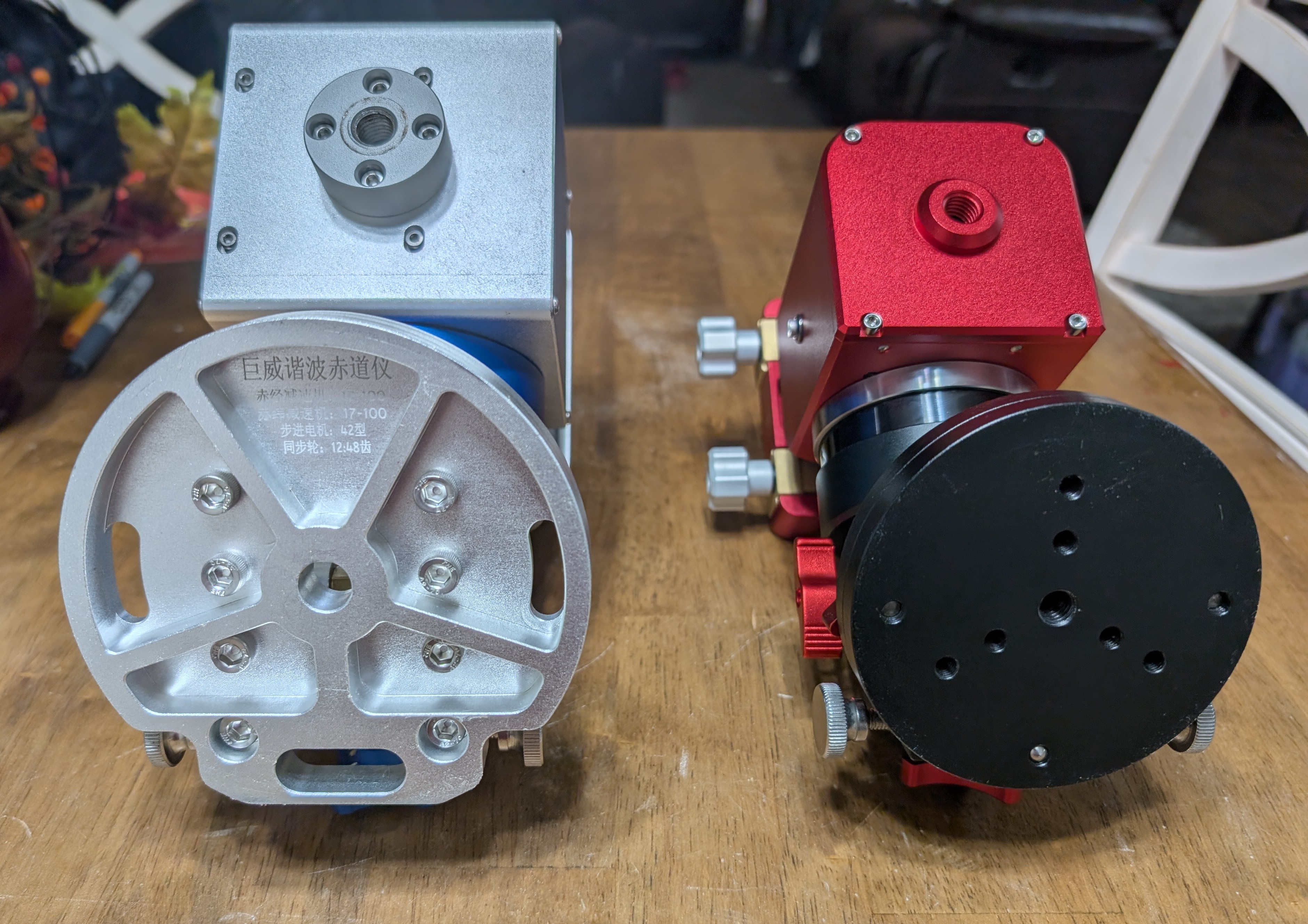

Great news, mine is also the blue. My Juwei-14 arrived this week, I went with red and black this time.  does the 14 have the same "footprint" as its bigger version? Might be an interesting future buy for me as well The base is a bit smaller and has a 3/8" threaded center hole and six other mounting holes separated 120° around the base. I got one of those cheaper carbon fiber tripods off Aliexpress to try out with it, I'm only putting 10lb of equipment on it anyways.  Here's a bottom comparison.
The base is a bit smaller and has a 3/8" threaded center hole and six other mounting holes separated 120° around the base. I got one of those cheaper carbon fiber tripods off Aliexpress to try out with it, I'm only putting 10lb of equipment on it anyways. Here's a bottom comparison. If I'm getting this straight, the Juwei 17 swivels onto the tripod base itself, while the 14 has the bottom part divided in two, and the top part swivels onto the bottom part, am I correct?

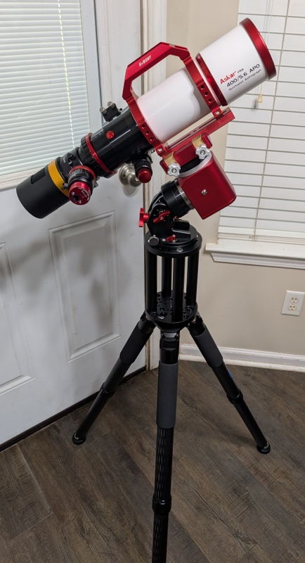

Got the J14 rig completed with one of the Bexin tripods off Aliexpress, feels solid. I do wish the mount lined up exactly with a leg, but there's always a trade off going cheap, this tripod doesn't have any way to adjust the pointing direction since the plate just screws into the mount with a 3/8" bolt.  |

Thanks for letting me know. Theirs is marked at nearly the same price I bought my current mount for. Please let me know how the J14 performs if you get clear skies! Just wanted to stop back in a let you know my J14 works great for my intended purpose of a super lightweight rig. I put it on a tc-40 tripod and can carry it with one finger around the yard. I'm only planning to use it with my Askar fra400 and it only has a vixen size saddle, but it works great for me. I can easily manage 300s exposures at 400mm with the Askar. https://www.astrobin.com/du77tc/ |
