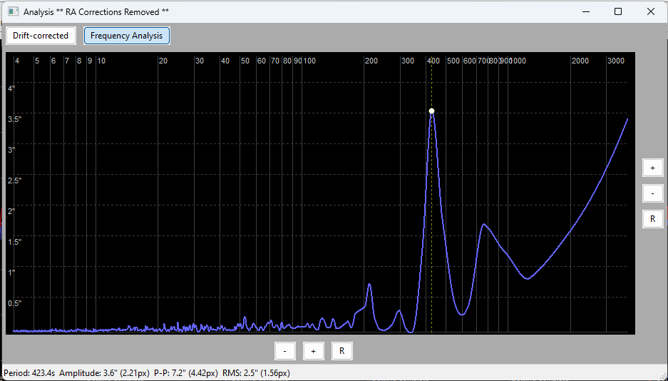

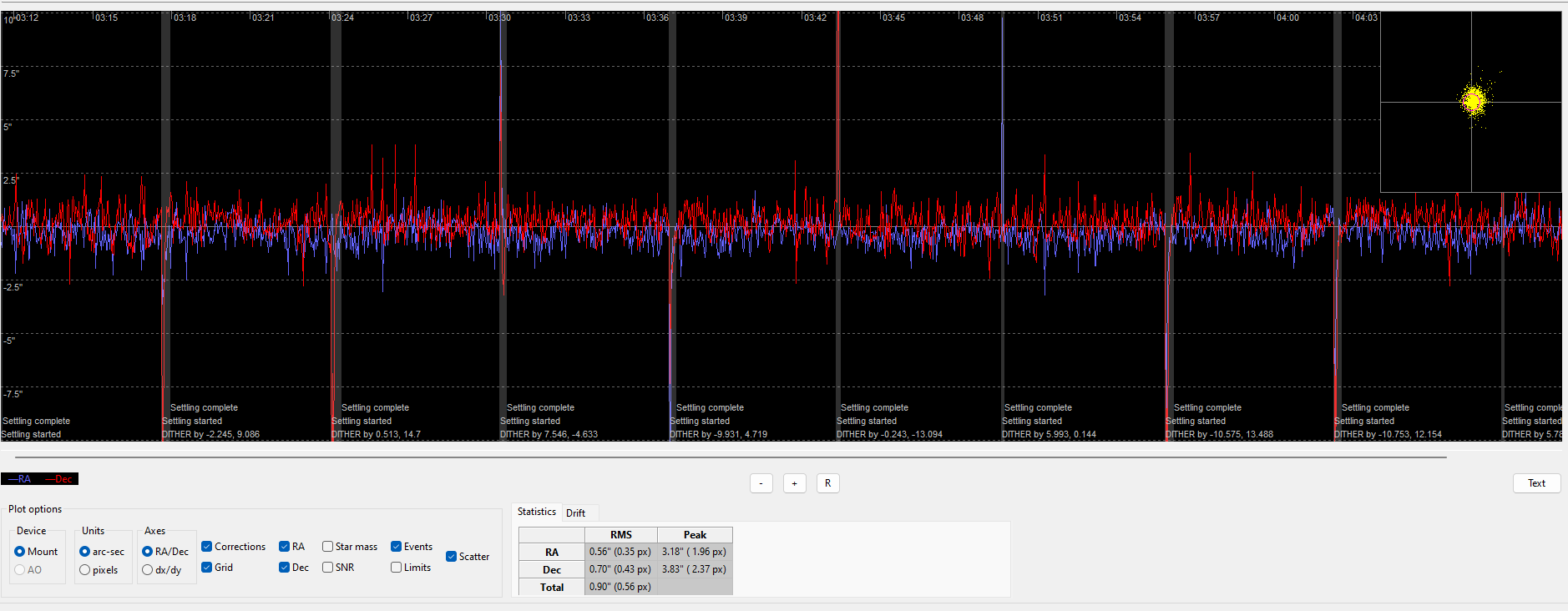

fess9999 0.00
Hi Carlo,
Take a look at the screenshots. There is a periodic error, but it's manageable if you are polar aligned well. I am getting my RMS about 0.5-1 arcseconds. The result is quite consistent. 5-6 mins exposures cause no issues at all with guiding (I use OAG though).
Azimuth and altitude knobs are tight enough to keep overall alignment error under 20-30 arcseconds. There is some backlash in the altitude knob, not critical and controlable.
