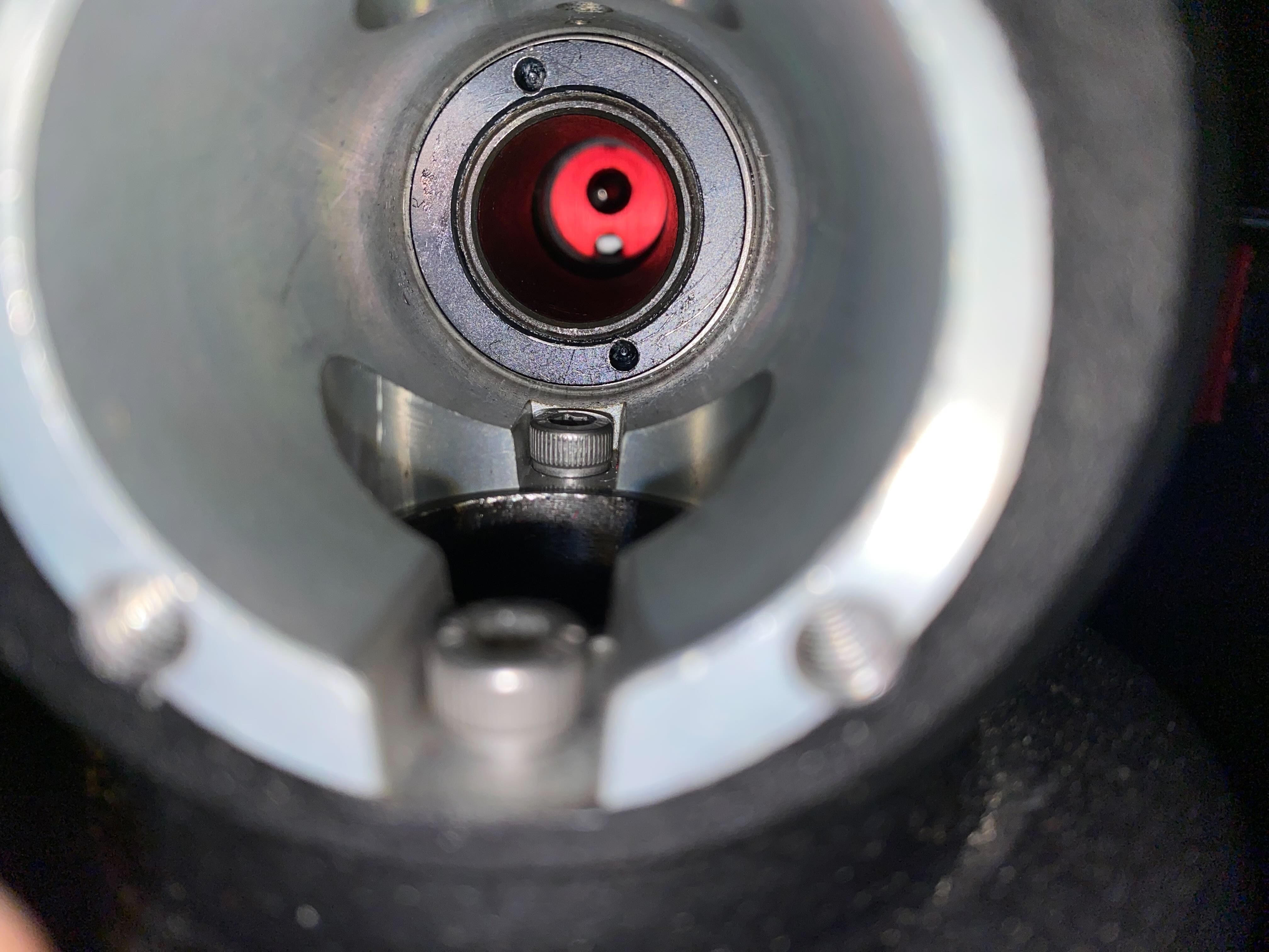

No, the shaft is held inside the dec. housing  by two tiny ball bearings bearings, set in a distance of about 40mm.

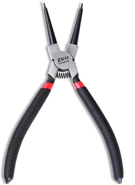

At the end of the shaft there is a nut to to tighten the bearings together and  without a spacer between the bearings, it is possible to tighten the bearings to hard axially. I made a quick sketch and took a picture of the nut with my iPhone
Everything is held in the correct position by the nut an the nut is easy to adjust if you can get a pair of straight snap ring pliers.
A bit sloppy and fast drawing, but I hope it is possible to understand,
PhotonPhanatic 4.53
Roy Hagen:
Thanks @Roy Hagen that's helpful.

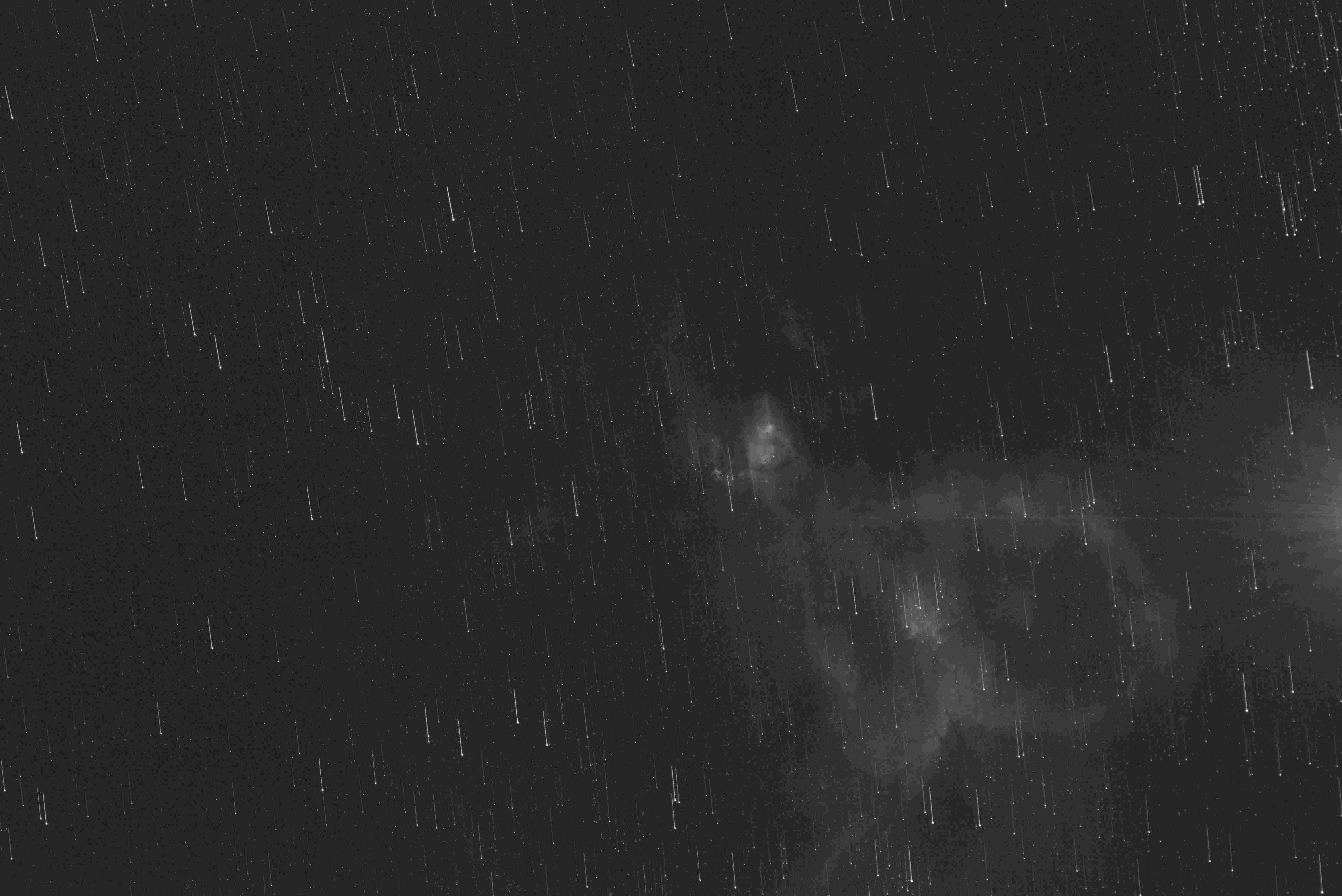

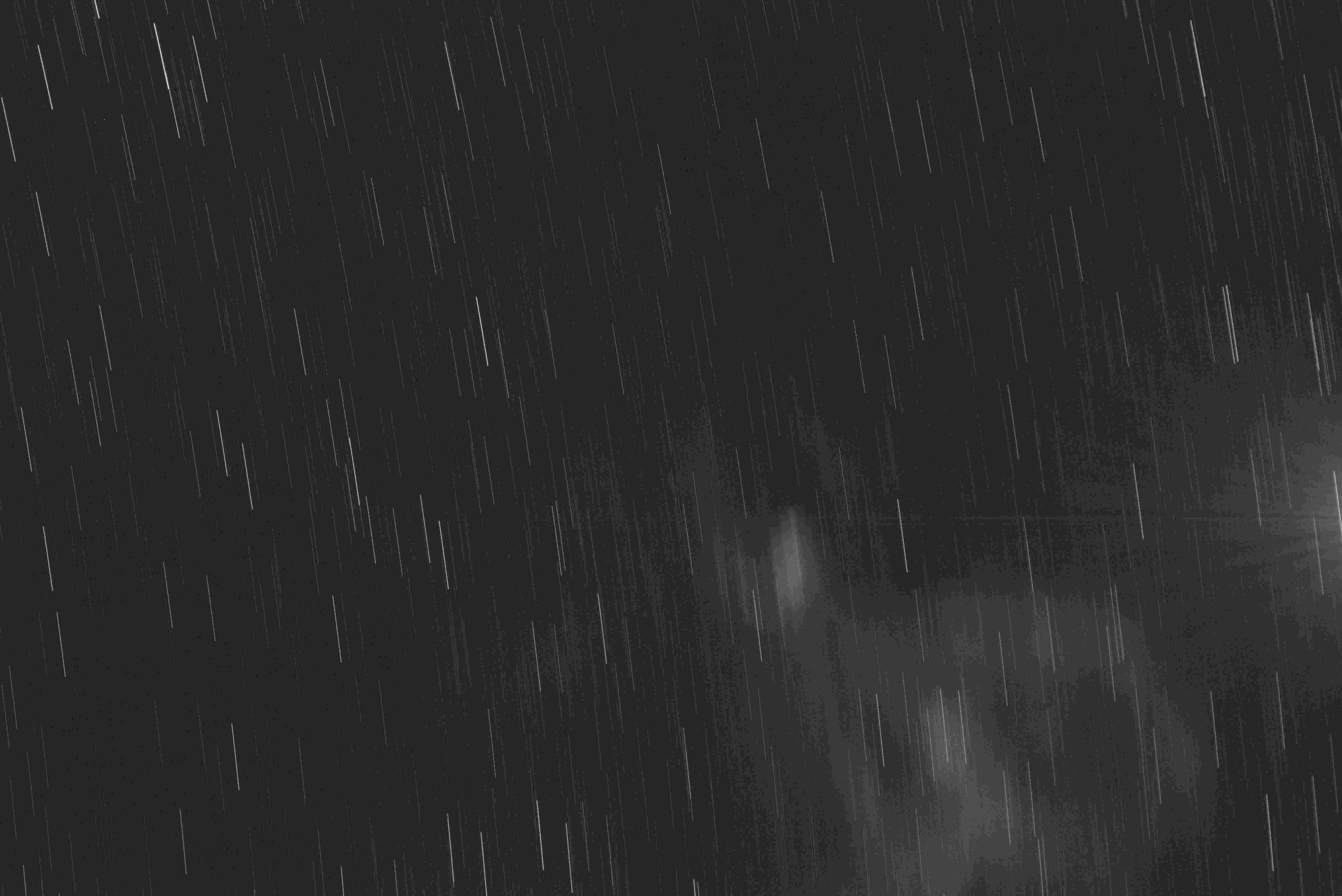

Your thread has prompted me to get my CEM25-EC out and try to fault find again. Very similar problems to the above - everything starts of okay and then as the imaging progresses RA tracking faults start to arise. I've stripped the mount and cleaned it thoroughly with no improvement. I also have a problem where the mount and ASIair do not communicate the RA/DEC settings for a given imaging session. Like you I have replaced the battery but GPS performance can still be a bit iffy at times. I am convinced the problem lies in the handset or interconnecting wiring but so far I've had no luck tracking it down.
Support for the CEM25 is pretty much non-existent in the UK. The appointed repair agent doesn't even respond to enquiries. The 8408 is "Unavailable" and when you can find one the price is extortionate - buying one could just represent good money after bad.
Good luck and I will monitor your progress and report anything I find which may be of value/interest.
These two images show the problem:
Tracking starts okay and then stops:
Tracking doesn't start at all:
