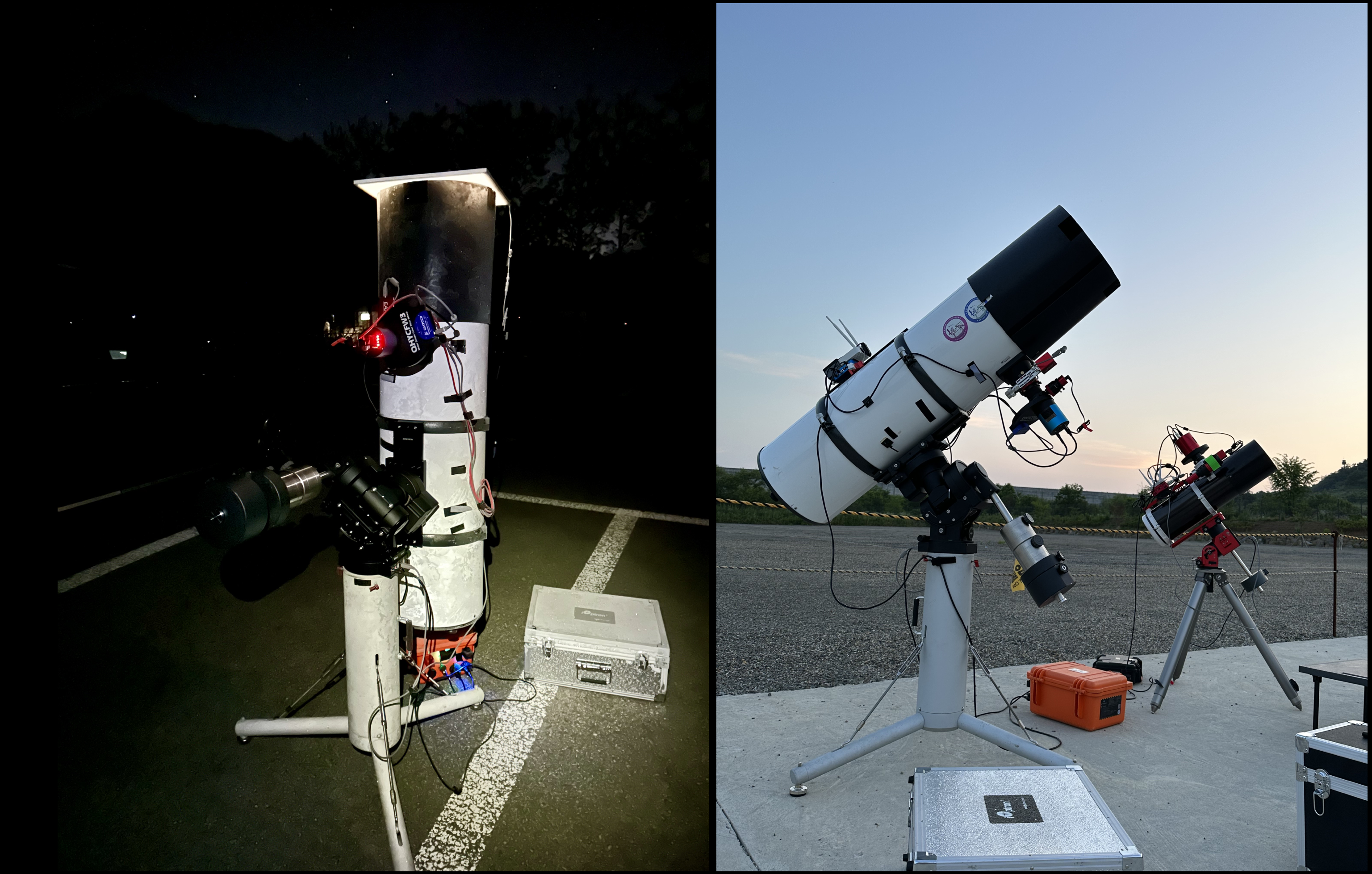

I use an Orion (OK) OO VX12 on a CEM70 and the CEM70 copes OK with it.  See some examples in my gallery.  The VX12 is one of the lighter 12 inch scopes but with top plate, rings guide scope and a long dovetail the total weight  is well over 20 kg.  Nevertheless I have had good guiding-  although much of what I have done with the VX has been short sub lucky imaging - subs as long as 3 min have been fine (when not too windy).  The thing is to be very careful about getting the balance spot on and the order you do things when loading all that weight on – there is the potential for damage if the clutches aren't off when they need to be etc.

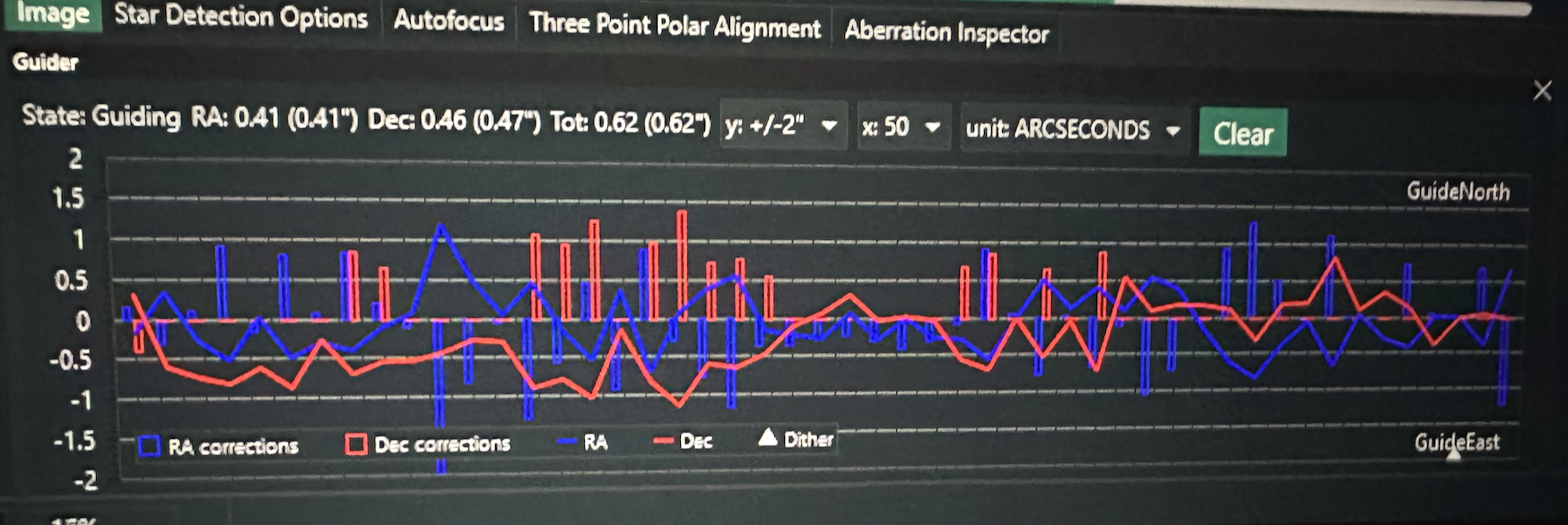

That’s exactly the setup I’m using.
The guiding accuracy varies depending on the seeing conditions, but during the good summer seeing, it averages around 0.5 to 0.6 arc seconds.
If you’re using a lower pier height below the mount, mounting telescope shouldn’t be too difficult.I have many photos taken with that system.
If it is anything like more than a whiff of wind you're done with your guiding accuracy. And I have a much larger mount.
