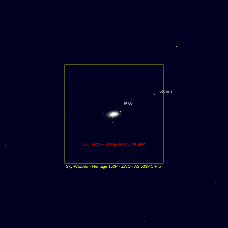

Question is, why do all that? It seems like an awfully long detour to end up pretty much where you started. You are basically changing weight distribution and trading collimation frequency for collimation difficulty. But in the end, you will have the same type of scope (reflector with spikes, without CA, with significant stray light issues), the same weight and the same practically achievable resolution. Personally, I do not see the point. The only concrete reason for making the change is if you are aiming for specific targets that are framed better by a 1500mm-ish instrument with the camera binned at 2x2 instead of a 700mm-ish instrument with the camera at its native focal length. For example, consider how M63 is framed by a typical 6" Newt (yellow) vs a typical 6" RC (red). If you bin the RC, you end up sampling almost exactly like with the Newtonian, but sub size is 4 times smaller and you don't have to crop and throw away 3/4ths of the field (assuming of course you don't care about it). In my opinion, the benefit is marginal. You can simply use the ROI feature of your camera.
