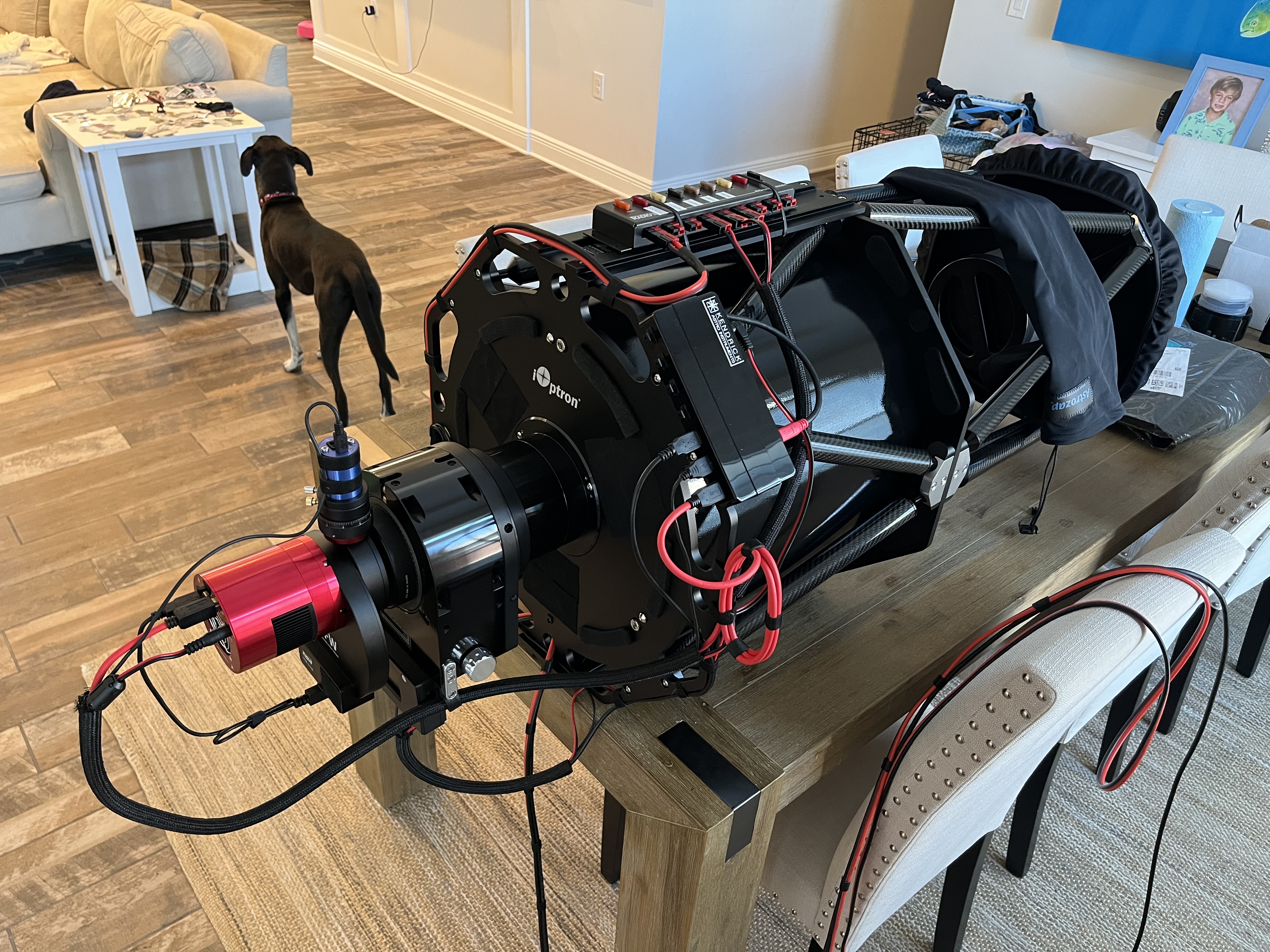

Hi Dan, I’ve been working in getting my ioptron RC14 all rigged up. Just waiting on my pier to be constructed. I am using the 3” flattener designed for it that doesn’t change the focal length. I have use the same setup for the RC 10 truss version and it worked out really nicely… see my astrobin photos. I don’t find these scopes difficult to collimate as long as you collimate the 3 components in order; focused then secondary and lastly the primary. I am hoping that my pier will be ready by April and then I should be up and shooting away
Z3ph0d 2.15
It must be really hard to have that sitting on the dining table and just waiting for the pier!
I had a look at your images and if that is what you can do with 10", then I can't wait to see the images with the 14" :-)
Btw, are you using a laser collimator, and if so, which one?
cgome004 2.71
Its killing me! I've had it sitting there since Dec. I use the RC8 for a long time, then moved up to the 10'' and used that for about 2 years. Now I'm at the 14" and can't wait to start imaging. I use the Howie Glatter https://agenaastro.com/howie-glatter-2-635nm-high-brightness-red-laser-collimator.html wich comes with the dot attachment but I also use the concentric circle attachment to get the primary mirror collimation pretty close https://agenaastro.com/howie-glatter-holographic-attachment-concentric-circle-pattern.html .
I do my final adjustment to the primary with a star defocus test under the starts. You will also need a cheshire collimator to do the secondary https://www.highpointscientific.com/apertura-2-collimation-cap?utm_source=google&utm_medium=cse&utm_term=APT-CC2&utm_source=google&utm_medium=cpc&utm_campaign=20618277309&utm_content=&utm_term=&gad_source=1&gclid=Cj0KCQjws-S-BhD2ARIsALssG0aeFJIE3LNQEEvLvKhr5ZfrTfpGpA-KtTtXjja_L6Bjr3YFovwUca0aAkbNEALw_wcB
With this you'll be all set to collimate any RC no matter how misaligned the optics are!

With my truss RC10 I didn't use them, with my setup being permanent in my roll off obcservatory, I find that I can just roll to roof off 1-2 hrs before sunset and I have plenty of time for temperature to equilibrate. While cleaning my scope I found dust and dead bugs that get in there and so I chose to just cover them up. The foam and tape are somewhat breathable as well
