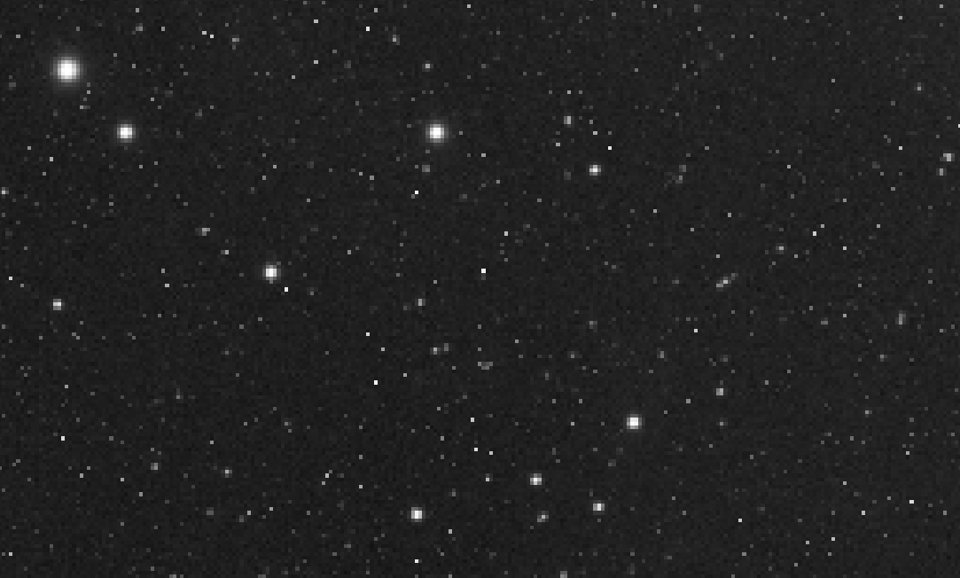

I recently acquired a new telescope and while first light was successful, I am a bit concerned about star shapes in the corners of my image especially as it's not a cheap scope and I am using a small sensor by today's standards. My imaging train is: Ed127 => altair 0.8x flattener => zwo oag-l => filter wheel => 12mm spacers => zwo 1600mm. All together, this gives me a backfocus of 61mm not accounting for filters. On the altair website, the backfocus for this reducer should be ~61mm for slightly smaller telescopes. Earlier that night, I started with 14.5mm of backfocus but that showed clear signs that the camera was too far from the flattener. These stars look the opposite but not as bad. They look like the camera is too close. At f/6 I would not have thought this mattered since the difference is only 2.5mm. Could these stars be caused by something else like tilt? I know my processing wasn't the best but this was my first time doing mono so it was quite a challenge. https://astrob.in/full/1rjna2/0/?real= |
Hey Arpad, so it looks like most of the stars in the corners lean upper left to lower right, except for the bottom right side. To me, this looks like tilt, not necessarily a back focus issue. If it was back focus, the stars would be radiating from the center, or circling the center. Also try without the reducer/flattener to see if the star shapes stay the same.
I disagree that it isn't necessarily backfocus error. You can't just look at a single image and tell that. In fact, its almost guaranteed that it is a combination of both tilt AND backfocus error.
I highly suggest you run NINA, and download Abberation Inspector, and then run that. It will tell you exactly how much tilt and backfocus error you have. In my experience, the ES127 with 3" field flattener did NOT produce sharp stars to the corners at 55mm, and did need the backfocus adjusted (i had to shorten mine by 1.5mm!) before I had sharp stars to the corners. YMMV thats why you need to check. You're always gonna have a tiny bit of tilt, its just about deciding how much is acceptable to you. The abberation inspector plugin will be so helpful here for guidance, because it'll tell you just how much tilt there is.
Btw your stars are not that bad. Also, wind and poor tracking can cause elongated stars too, and where you are pointing when you take the image matters as well. It's pretty nuanced but you will figure it out.
Also you should probably just throw the book out on what the stars "should" be doing when you change backfocus. My 'stars' told me my sensor was too close, and for the longest time I couldn't figure out why I couldn't get sharp stars to the corner, even though I added more backspace (because again, the charts told me my sensor was "too close. but, it was actually the opposite).
It wasn't until I ran abberation inspector that I realized I need to remove backspacing, not add it. And then I had sharp stars in 3.5 corners. I had tilt in one other corner but I didnt care because it was borderline imperceptible after I fixed the backfocus error.
So TLDR just because the downloaded chart seems to tell you one thing, does not mean that it is.

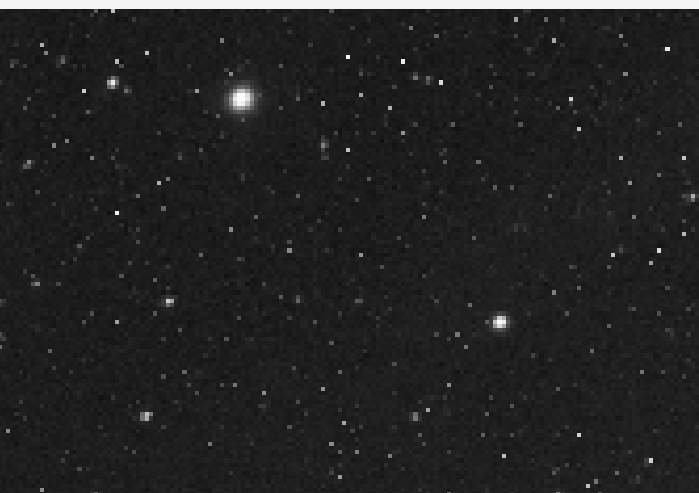

 Example image of one of my corners, i was able to get pretty good for 3 of them. Slight eggs here...  Sometimes its worse than others. A lot of things can cause elongation in stars that can present itself looking like maybe its tilt or backspacing. Wind, poor tracking, long exposures in general, etc. Do your best to eliminate any variables you can. It can be a real challenge, but you should be able to get it pretty close. Regarding guide stars, PHD2 can guide on those stars no problem. They have astigmatism due to the 45 degree mirror, and will typically have some abberation no matter how flat your field is behind the reducer. You will never get them perfect. Hope this helps. Abberration Inspector and NINA are life changing tools that I would suggest to every astrophotographer in my opinion.
