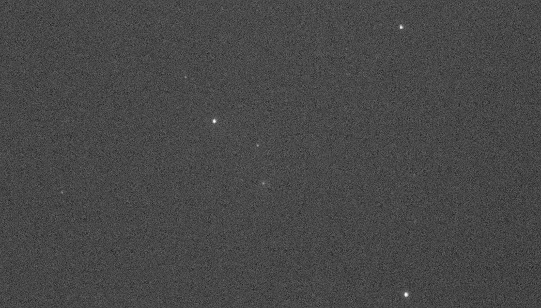

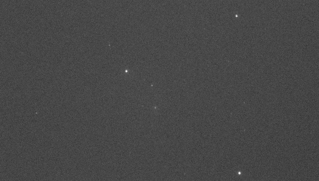

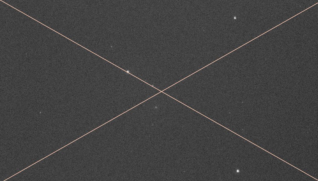

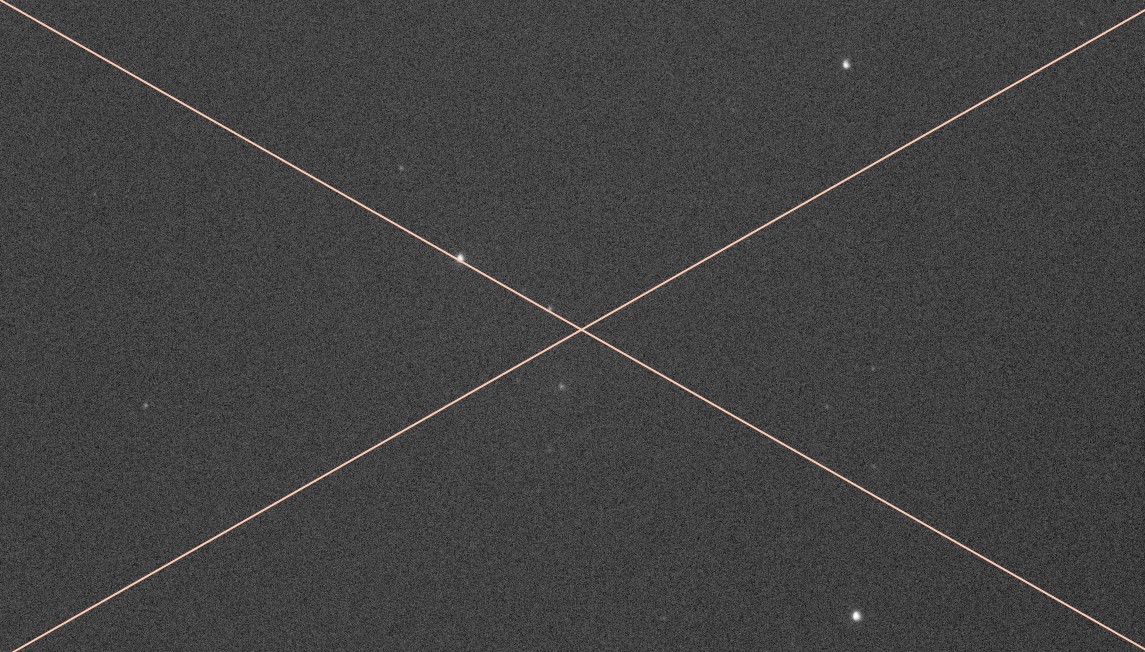

I've some troubles with Siril. I photographed the Embryo neblula (NGC 1333) without guiding, so my sub exposures are only 15s long. If I try to register the images, Siril only registers half of the images. I don't understand, why Siril can't align the stars in the images:
Why is this image registered but
this image isn't?
The console only says "Cannot align the stars".
I use the 2 or 3 star alignment method, because every other method worked even worse. I use the bright star in the middle of the image and the bright star in the upper right corner.
Kind regards,
Sternwarte Orion
Quark-Coder 0.00

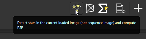

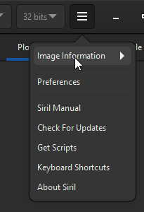

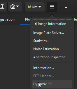

Go to dynamic PSF. Click Star Detection. By changing the threshold and roundness threshold, all stars should be selected. Then do a global star alignment
p088gll 2.15
I think you will get the best answer when you post your question directly in the Siril forum. The Siril developers usually react quickly and have excellent answers.
https://discuss.pixls.us/c/software/siril/34
Goetz
astrobagchi 0.00
Hi, from the images that you have posted, looks like very few stars. That may be the reason Suril is not able to align. If you are familiar with Deepskystacker, increase both star detection threshold and FITS brightness threshold and see if you get any better results. If not, you may have to increase exposure.
TJ
paddy36 1.51
Hi Sternwarte Orion ,
The signal to noise ratio is too low, so increase the time of acquisition for having more stars and signal as well..!
Paddy36
I shoot at 15 sec. all the time and have never had this problem but I do see it if I go much shorter, that's with a dual band filter. The best solution is to increase the star detection threshold as quark-coder suggested.
