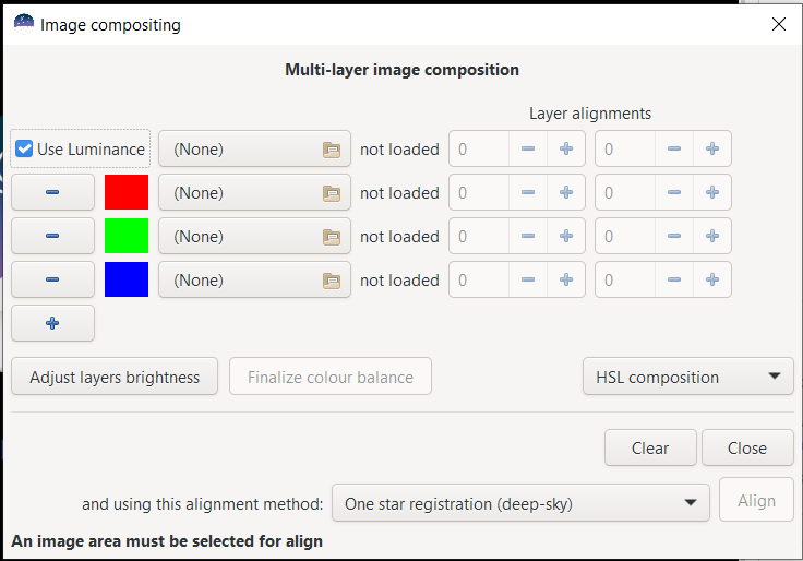

I have a question regarding processing.
How do I merge red, green, blue, and luminance using Siril? Are there any good videos on it?
I stacked each of the channels on its own using DSS, so now I have 4 TIF autosave files, the only thing I need is a way to merge them into one so it turns into an RGB.
Thanks in advance!
DesignBig 0.00
You can do it through pixel math or LRGB combine, there's a few videos on it from borealislife
https://m.youtube.com/watch?v=tMriBh8OJJE&pp=ygUPQm9yZWFsIGlzIHNpcmls
SimonBur 0.90
You can do this in Siril. I’ll send a screen when I get home.
Majungai78 1.51
Hello Alien Enthusiast! It's easy to make an RGB combination. I invite you to consult the following link in the SIRIL tutorials: https://siril.org/tutorials/rgb_composition/ It is important to first use the LINEAR MATCH tool on the RGB layers, in order to balance the colors . For LRGB composition, the simplest method is to use the RGB composition tool, adding luminance ("Use Luinance" box). Good treatment!

I apologize for adding to the thread with a follow-on question. I have used the RGB Recomposition successfully (once!) with L,R,G and B files. I wonder how people are combining HaRGB with this tool?
Ecliptico 2.41
John Pancoast:
Majungai78 1.51
In the same way ! Just replace the luminance with the Ha layer… But we can do much better, by creating a synthetic red layer with pixelmath and mixing the red and Ha layers with a simple formula: x*Red + (1-x)*Ha ; the values of x can range from 0.5 to 0.8. Be careful, apply LINEARMATCH on this synthetic red layer!

setnes 0.00
Alien_Enthusiast:
Since you have luminance, you need to pre-stretch the mono images first.  After that you can combine them using the "Image Compositing" tool.  This means that any actions you wish to take on linear data would need to be done on the individual channels prior to stretching.
If you did not have luminance and only had RGB channels, you could recombine linear data and stretch after combination.
