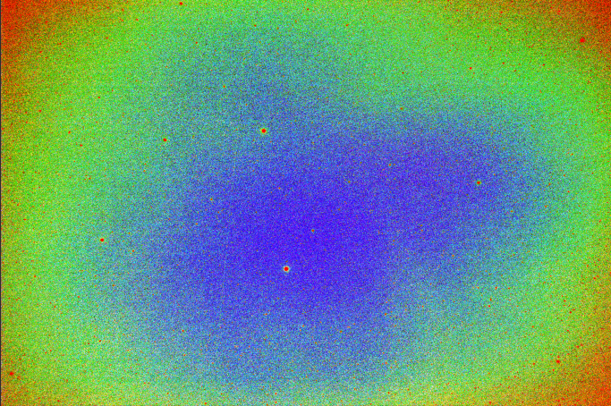

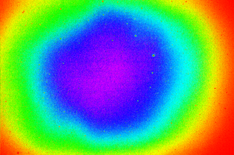

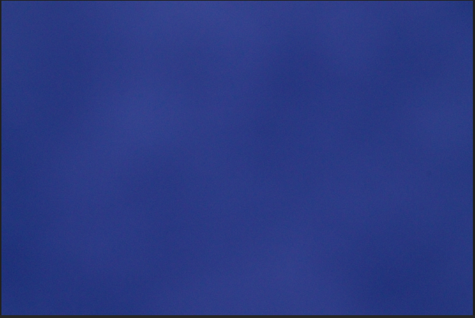

=MsoNormal I shoot with a Canon DSLR/Tamron zoom, and collect lights, darks, flats, and flat darks each session. I shoot from a somewhat light-polluted suburban location (Bortle 7?). Here is an example sub of CrB using the Histogram autostretch view in Siril (with and without false color) before any processing:=MsoNormal  light sub=MsoNormal  light sub (false color)=MsoNormal =MsoNormal As a novice, I still use Siril preloaded OSC_Preprocessing. My stacked results always have the same defect, a substantial circular gradient from center (dark) and radially outward (full white).=MsoNormal  calibrated stack=MsoNormal  calibrated stack (false color)=MsoNormal =MsoNormal I have always assumed it was a complex mix of light pollution, amp glow, my cheapie equipment, etc. I can substantially flatten the image using background extraction (BE), but to get the corners and center close, BE introduces many rolling hills and valleys which end up as multiple orange and blue patches in the background. Extensive playing with smoothing, polynomial v. RBF, sample placement, subtraction v. division, and drizzle does not make much of an improvement.=MsoNormal =MsoNormal I am wonder whether the real culprit is an incorrect calibration with the flats, causing inverse vignetting? I can see the vignetting in the flats, but it is minimal compared to the what shows up in the stacked image.=MsoNormal  flat sub=MsoNormal  flat sub (false color)=MsoNormal =MsoNormal Has anyone else encountered this problem?=MsoNormal Is there a solution, such as adjusting Siril preprocessing values to decrease how strongly the flats are divided during calibration, etc.?=MsoNormal =MsoNormal Many thanks for any help or advice.
Have you checked if you had any light leak?
Did you use the same ISO setting?
I would suspect an issue with the way the flats are being taken, I had a similar issue until I tried doing sky flats and it started working much better.

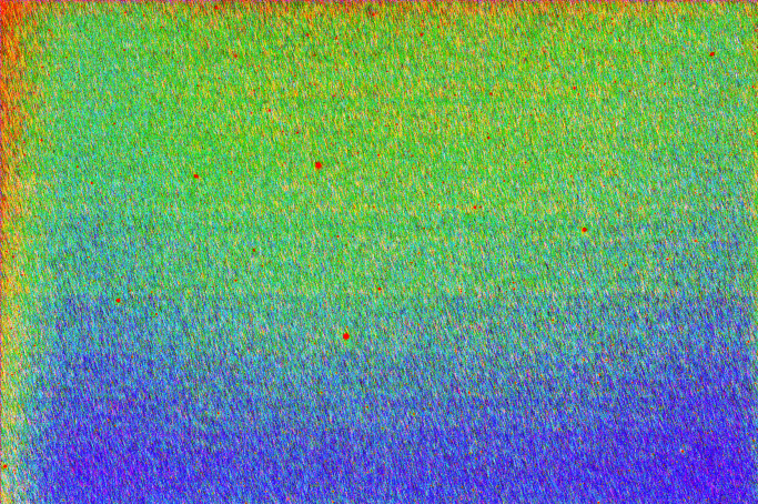

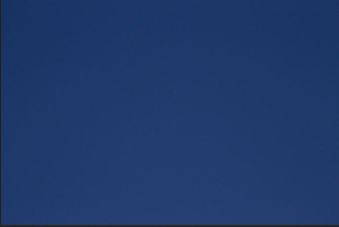

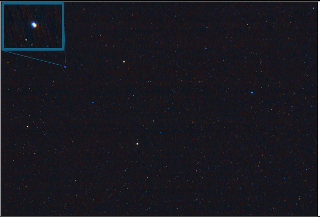

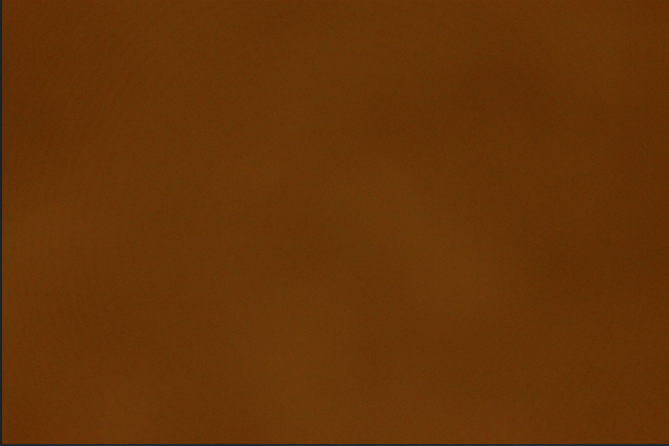

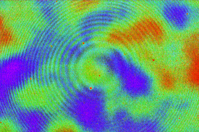

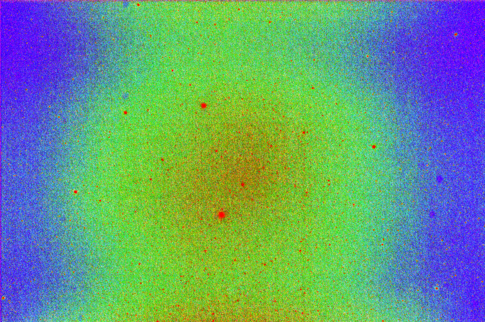

=MsoNormal Thank you everyone for the great comments and questions. I should also point out that I am still using Siril 1.2.6. All the images included in my below answers to your questions are screen captures of Histogram view in Siril with or without false color, unless indicated, to maximize the defects.=MsoNormal  =MsoNormal =MsoNormal Médéric Hébert & Tony Gondola: Regarding light leaks, I leave my viewfinder covered during all my shoots. With my setup, I don’t have any way to dither, so I shoot darks with same settings immediately after lights. Here is a dark sub (linear, Histogram view, and Histogram view with false color: =MsoNormal  dark sub (linear)=MsoNormal  dark sub (Histogram view)=MsoNormal  dark sub (Histogram view with false color)=MsoNormal I don’t see anything that looks like a light leak, but if there is a better test, please let me know. =MsoNormal =MsoNormal AlexFilothodoros: Yes, I use the same ISO, also F11, for all lights, darks, flats, and flatdarks,. According to Canon specs, ISO invariance at 1600; however, the same specs show a substantial drop in dynamic range from 800 to 1600, so I shoot at 800 where the ISO is nearly invariant. That decision may spark a parallel discussion?=MsoNormal =MsoNormal Cyril Richard: Thanks for the link to flat correction explanation. I had read that section of the manual, and in fact, it was those ADU graphs that made me wonder if my concentric circle “gradient” was really inverse vignetting. In any case, I did not see anything that would allow me to adjust how the flats are used in OSC_Preprocessing. Did I miss something?=MsoNormal =MsoNormal Travis McGeehan: I take my flats using an ipad set on very low brightness to avoid refresh rate issues. Using the AV setting and same F11 and ISO as all my other shots, resulting flats typically are ½” exposure. I then use M (manual) setting with that exposure and same F11 and ISO to make darkflats. I have previously tried the T-shirt and overlapping paper (and T-shirt+paper) methods, but even at infinity focus, there is a visible pattern (T-shirt weave, paper inhomogeneity) in my flats. The ipad appears to give a nice homogeneous image.=MsoNormal I may be misunderstanding what you meant by sky flats.=MsoNormal =MsoNormal Niall MacNeill: My flats have a histogram peak usually around 30-40%:=MsoNormal =MsoNormal  =MsoNormal =MsoNormal I don’t know where to find the actual ADU value for the flats or what is the saturation value. The stat [main] command for a sample flat gives: =MsoNormal B&W layer: Mean: 2805.638588, Median: 2795.0, Sigma: 250.700353, Min: 2223.0, Max: 15303.0, bgnoise: 316.180612=MsoNormal In any case, I also tried using flats (and corresponding flatdarks) with 2x exposure (e.g. 1”) and half-exposure (e.g. ¼”) at same F11 and ISO, but the Siril stack was virtually the same, leading me to assume that Siril normalizes the flats before calibrating the lights? =MsoNormal However, I need to do this again to make sure that I did not change anything else. Assuming that I reproduce my prior results, is there a way to manually input a weighing factor to decrease the flat correction? Thanks again!!=MsoNormal
Regarding light leaks, I leave my viewfinder covered during all my shoots. With my setup, I don’t have any way to dither, so I shoot darks with same settings immediately after lights. Best way to look for light leak is to take darks during the day in sunlight. Those don't look like they have leaks. But then again, you need light to leak in to see the leaks Since you are using a DSLR, one possible way for light leak is via the viewfinder.
When I take flats, I automatically use Nina. At the end of the sequence (end of the night), I wait for sunrise and then slew to the zenith. Nina then starts the sky flats with the optimal exposure time — those work best for me. Sometimes I also set the timer to just before sunrise so that the exposures aren’t too short. I’ve noticed that if the exposure is under one second, the flats sometimes don’t turn out well.
By the time I get up, the flats are usually already done without me having to do anything.
Médéric Hébert:

Hi all, It's been a few days, but I needed some time (and favorable conditions) to test the many helpful suggestions that I received. The culprit for me is the ipad. I have tried multiple iterations and combinations (low/high brightness setting, long/short exposures, glass to glass v distance between ipad and lens), and the result is qualitatively the same; the final corrected/calibrated stack always includes an overwhelming concentric reverse vignette effect  stack with ipad flats (see discussion above) As I mentioned, the unstretched flats look normal, but either they are not, or siril does not like them, or my camera is doing something strange that is not readily apparent in the images themselves. the intensity of the concentric pattern is lessened when the ipad is farther away:  ipad flat 2 feet (max distance) from camera but still strong, and very difficult to remove using background extraction. So, as suggested by many of you, I switched to sky flats. I tried paper (1-8 sheets with random orientations), t-shirt, and a t-shirt/paper sandwich. All the flats have a visible pattern showing the inhomogeneity of the paper, t-shirt weave pattern, etc. Longer or shorter exposures did not make a significant difference:  eight sheets paper, midday sun  8 sheets paper, bright 5000K bulb the pattern gets exaggerated in the stacking process, and also a strong circular diffraction pattern shows up:  stacked image using 8 sheet paper flats (histogram view/false color) The solution for me was simply to take images directly of the dusk sky before any stars appeared (no paper, no t-shirt), and adjust exposure time to get histogram in decent range (25%). 4 second exposure (f11, ISO1600) worked well, but I had to be quick, because as someone pointed out above, the lighting is changing rapidly even during the 2 minutes taking the flats. The flats are very blue, but that color cast did not appear to affect my stacks  flat sky dusk 4 sec f11 ISO1600  final stack without flats (histogram view/false color)  final stack with flats (histogram view/false color) suffice to say, background extraction was much easier. After some simple processing here is the result  head of Draco it's not great because I only have 8 lights. but the flats are working better, and I am already seeing some resolution of nu Dra. Many thanks to ALL!
