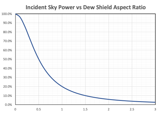

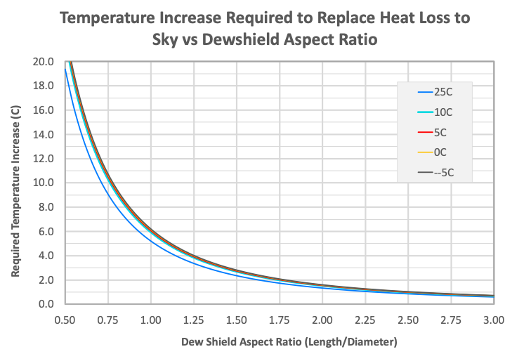

The single most effective way to protect a SCT from dew is to use a dew shield and to heat the shield itself.  For that reason, I really like metal dew shields because metal is better at conducting the heat to the inside of the shield where you need it.  It is easy to show that a dew shield that is just 1.5 times as long as the aperture of the telescope will block 90% of the heat exchange with the sky compared to using no shield.  If the conditions are pretty wet, that still might not enough to prevent dew; however by raising the temperature of the shield by just 2.2C, you'll replace the heat lost to the sky and eliminate the possibility of dew on the front of the plate.  It's best to put the heating strap about 1/3 of the way from the top of the shield.  I've attached some data plots so that you can see how things vary with dew shield aspect ratio.  Obviously longer dew shields are more effective but they are also MUCH more susceptible to wind.

Here's a plot showing the amount of heat exchange as a function of dew shield aspect ratio
Here are the results of a calculation to determine how much you have to raise the temperature of a dew shield to perfectly balance heat loss to the sky.
