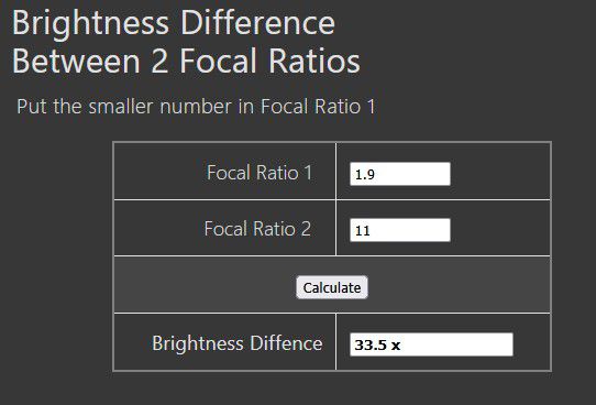

Huh?: well I've been loving long focal length! (F11 @ 3910mm) in Bortle 8 skies (with bad seeing) to boot - I've also done a lot of RASA 8 imaging (F2 @ 400mm) and although it was great, I enjoy the almost limitless amount of smaller targets that longer FL offers... the "fast" and "slow" labels placed upon focal length are somewhat meaningless...

dmsummers 6.80
Doug Summers:
I think folks get screwed up thinking only about focal length, when what's key is targeted resolution.
...the "fast" and "slow" labels placed upon focal length are somewhat meaningless...
Actually, fast and slow are very meaningful.   Try to take a 10 second exposure at f/11 on any target and see how many ADU are produced.   Similarly, do the same at f/1.9.   Then compare ADU, and see for yourself that optical speed matters.    Still unconvinced?  For confirmation, try a calculator (there are lots available)...see Astropix.com for an example:
Unless you're using Adaptive Optics, lucky imaging, on a mountain top, or otherwise blessed with constantly exceptional seeing, we're all seeing limited.   So, as long as you get to seeing limited resolution with proper sampling, that's as good as it gets (long or short focal length).   After that, large field or cropped, the target resolution will be the same and then optical speed differential takes over to create higher SNR per unit time.     The difference between f/1.9 and f/11 is shown below.   Are you sure you wouldn't rather just crop a "faster" field for those smaller targets?   ;-)    At the lower bound, we need enough pixels to see detail in small targets.  I don't use my RASA for ~1 arcminute objects (e.g. small planetary nebulae), but there are thousands of 3-4 arcminute objects that are within reach if you aren't adverse to cropping (e.g. pretty much the whole NGC catalog, plenty of the IC objects, etc.).   Like everything else, attention to detail is required to get the best out of any gear (fast or slow).
AstroRBA 4.98
When I say "meaningless" I mean that in the grand scheme of things, you simply make adjustments in aperture (to some degree), exposure time, gain, binning and processing etc., in order to effectively neutralize the difference and enhance the advantage of each particular FL; between, say, an F2 and an F11. I happen to like, and use, both for different reasons (different targets) and would not shut out either.
