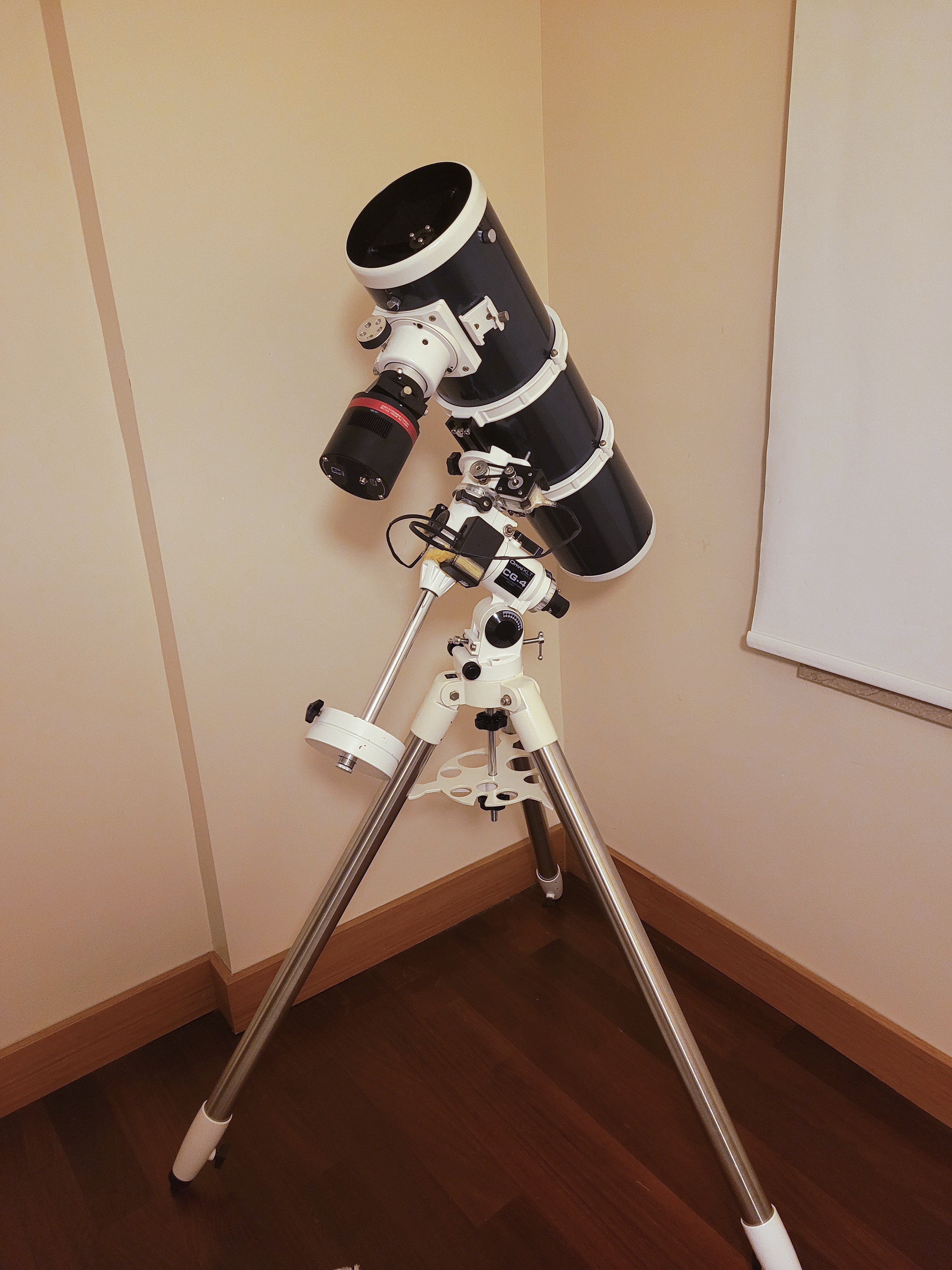

toygar_113 0.90
I built controller with Arduino mega which runs astroeq software. It connects to the computer with with USB cable and works with eqmod driver. You can also platesolve.
https://www.astroeq.co.uk/
If you don't want to built everything yourself I've seen some onstep upgrade kits on AliExpress.
As for polar alignment, I tried NINA three star polar alignment but huge backlash in dec don't allow very accurate results so I'm using PHD2 drift alignment now.
