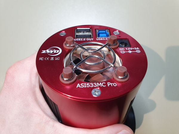

I can only speak for my mount but I don't have any vibration issue at all. I'm using 3s guiding exposures for both my Skywatcher 1000/200 PDS as well as my EdgeHD 9.25. I only adjust the gain a bit. I read that harmonic mounts like/need short guide exposures and I tried it but I haven't seen a difference. Maybe it's because of the encoder, I don't know.
I had some vibrations in the past which were caused by the fan of my ASI 533. Replaced the stock fan by a better one, that solved that problem.
I shot last night with the setup again at F/10 in varying seeing conditions. Guiding was 0.3” to 0.5”. I only checked the subs quickly but it seems that I can use almost 100% of them. With my HEQ5 (1000 mm, F/5) I had times where I had to throw away 50% of subs.

HansPS 0.90
Christoph Paulus:
Sorry for jumping in - it is not my intention to hijack the OP's thread - but may I ask with which fan did you replace the stock one? I have a similar issue with my 533MM (and indeed my 294MM).

Hans P. Strifeldt:
Noctua NF-A4x10 FLX
If I remember correctly it's a bit thicker than the stock one, so mounting was a challenge:
