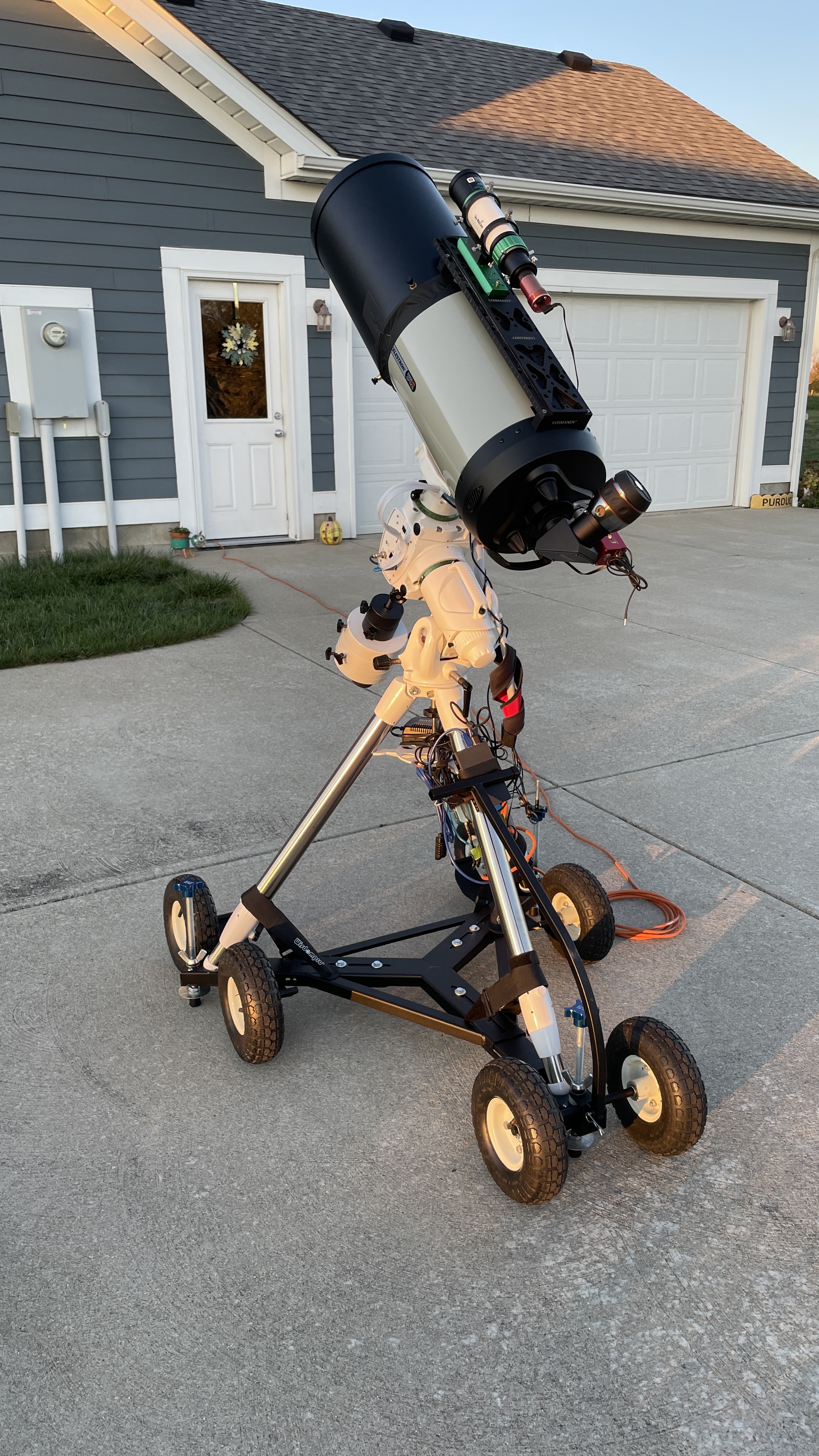

Renee: what do you think of the HP Z2 mini G9 as a mini computer for running NINA, Autostakkert, ASCOM, Ekos, etc. With the exception of AutoStakkert, that is way overkill. I believe most do the same that I do - have a mini-PC for running capture software and a separate machine for processing. I've used my MeLE Quieter 3C for over 2 years, running NINA, PHD2, Green Swamp Server, SharpCap, other capture software, and even occasionally Stellarium. The Quieter handles it just fine. I'm building a second rig right now and just purchased a Quieter 3Q, despite there being a Quieter 4 series out that's a little more powerful. I got the mini for <$150 plus a 1TB SSD for another $60 or so. I leave the whole rig out in all weather with the exception of actual precipitation, imaging in Indiana summers (high temps and high humidity) and Indiana winters (imaging down to about -5°F or so). You can see the mini-PC strapped to a tripod leg. The scope is in HyperStar config in this image. I run AutoStakkert and PixInsight (exceptionally demanding) on a machine I built specifically for processing (Ryzen 9, 7950X, 96GB DDR5-6000, 2*2TB NvME, 3060GPU). That machine handles processing like a champ.  |
Renee: The computer was donated - a friend gave it to me. Oops. Missed this part. Well, it should work just okay, although it's kinda big. If you can find somewhere to put it, it should work well enough. But, it says it's limited 40°F to 95°F, so depending on where you live, you might have issues running hot in summer or with it being too cold in winter. Like I said in my other post, I use mine all year round. It only has and only needs passive cooling. I've never run into a temp related issue, with the mini PC that is. I've had it running where I couldn't maintain my usual -10°C cooling setpoint in summer because the air was too warm, but the mini functioned just fine. I just had to raise the cooling setpoint for my camera to 0°C for those nights. On the -5°F nights, the sessions went off without a hitch.
Dan Kokinda:
Oops. Missed this part. Well, it should work just fine, although it's kinda big. If you can find somewhere to put it, it should work well enough. super jealous of your JMI wheely bar cart!! Yea I thought I would add that about it being donated. I am not a huge windows fan TBO. I had a connection that was able to hook me up with that computer, so I am obviously not complaining. It is the mini version (8.3 x 8.6 x 2.7 in). I was thinking of attaching it with velcro or something to the leg. A friend put a round wood stabilizer/platform between the three legs of their Celestron tripod. If I did this, I could potentially put it there.
Renee:
Dan Kokinda:
Yea I thought I would add that about it being donated. I am not a huge windows fan TBO. I had a connection that was able to hook me up with that computer, so I am obviously not complaining. It is the mini version (8.3 x 8.6 x 2.7 in). I was thinking of attaching it with velcro or something to the leg. A friend put a round wood stabilizer/platform between the three legs of their Celestron tripod. If I did this, I could potentially put it there. put linux on it!  |
