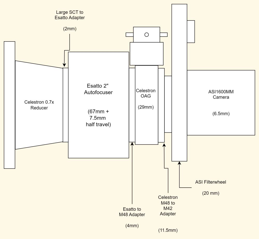

OK, so to add to my post above:
My current setup:
  • Edge 9.25HD OTA
  • Celestron 0.7x reducer
  • Esatto 2" Focuser with appropriate adapters
  • Celestron OAG
  • Celestron M48 to M42 Adapter
  • ASI1600
I have not had a lot of chance to image since the OAG was added, but here is an example image with the OAG in the image train:

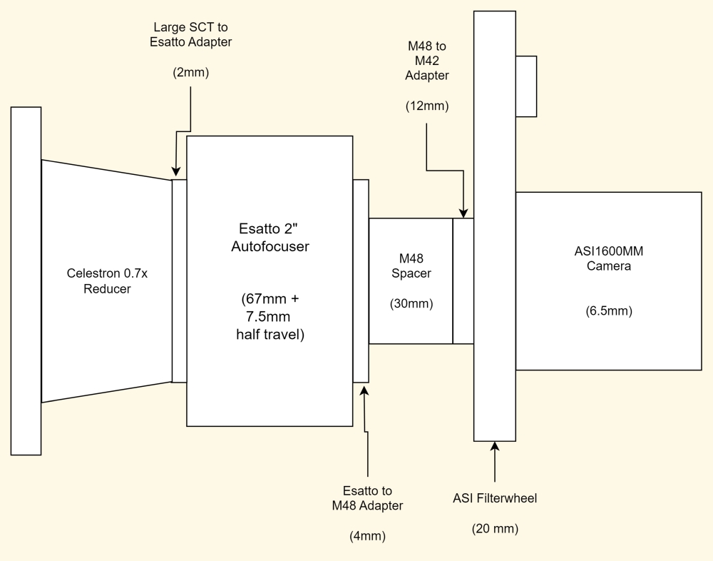

My previous setup:
  • Edge 9.25HD OTA
  • 30mm M48 spacer
  • M48 to M42 adapter
, but here is an example with this setup:
In both cases, I have gotten great results. Of course, this is with the 1600 sensor, which is only a 4/3rds size, so that may help.  Here is an example with the previous setup:
It is of course always nice to try to hit the backspacing exactly if you can. But that being said, it is maybe not as critical as a lot of folks would have you believe. Here is a technical article from Dr. Gaston Baudat, the founder and brains behind Innovations Foresight, the guys who make the ONAG (On Axis Guider). He went through the theory including the effects of seeing compared to the impact of imperfect EdgeHD backspacing. The conclusion that I got from it is you don't have to sweat every single millimeter of difference between the theoretical exact spacing and what you end up with...
See what you think after reading the article...
https://www.innovationsforesight.com/support/celestron-edgehd-back-focus-tolerance/
ML
There's a 146mm of backfocus but when I add up your current setup (first image), the one with the OAG I get 2+67+4+29+11.5+20 and, for me, 17.5 for the ASI2600 camera.  This comes out to  151mm, which is 5mm too long.  Am I miscalculating?
