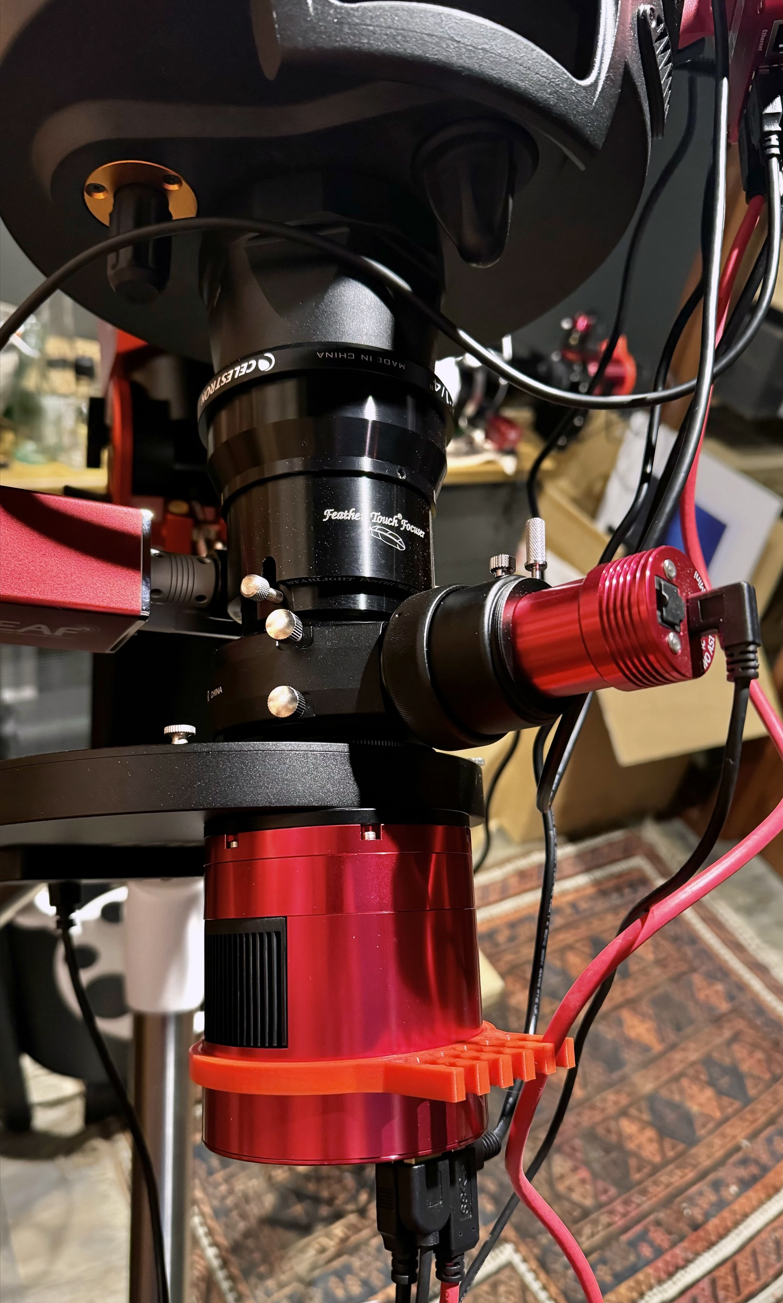

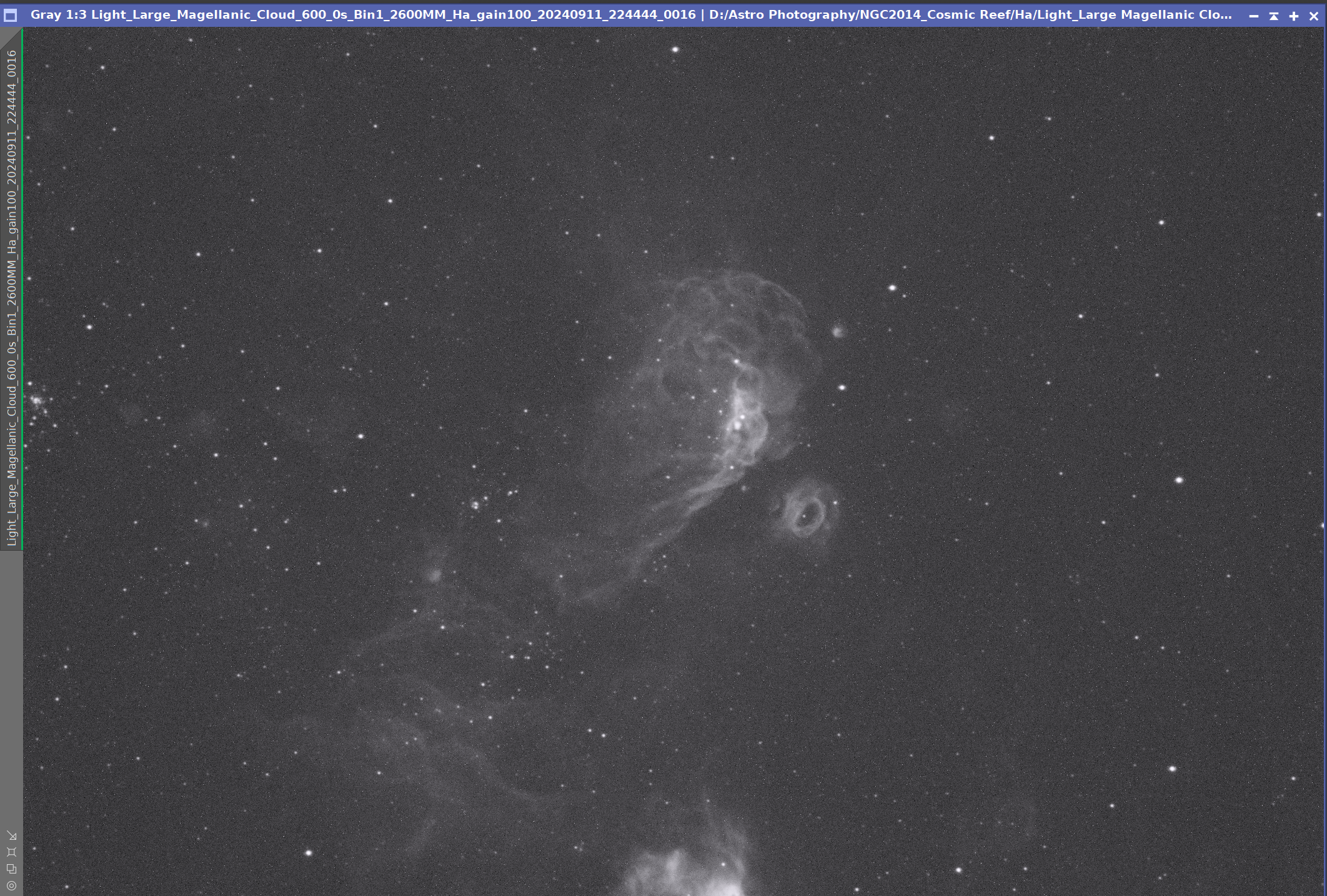

I am not an expert but I had first light for Celestron EdgeHD9.25, ASI2600MM and 0.7 Reducer a couple of nights ago and this is a sub from the first night of imaging with the Ha filter, 600 Sec and stars are pretty good all the way to the edge.
I use the Feathertouch Focuser and that works really well with or without the reducer and my mirrors are locked down all the time.
For backfocus, I worked it out to be around 146.71 (including allowance of 0.66 for filter) and the "Shorty" takes care of that easily with the EAF routine.

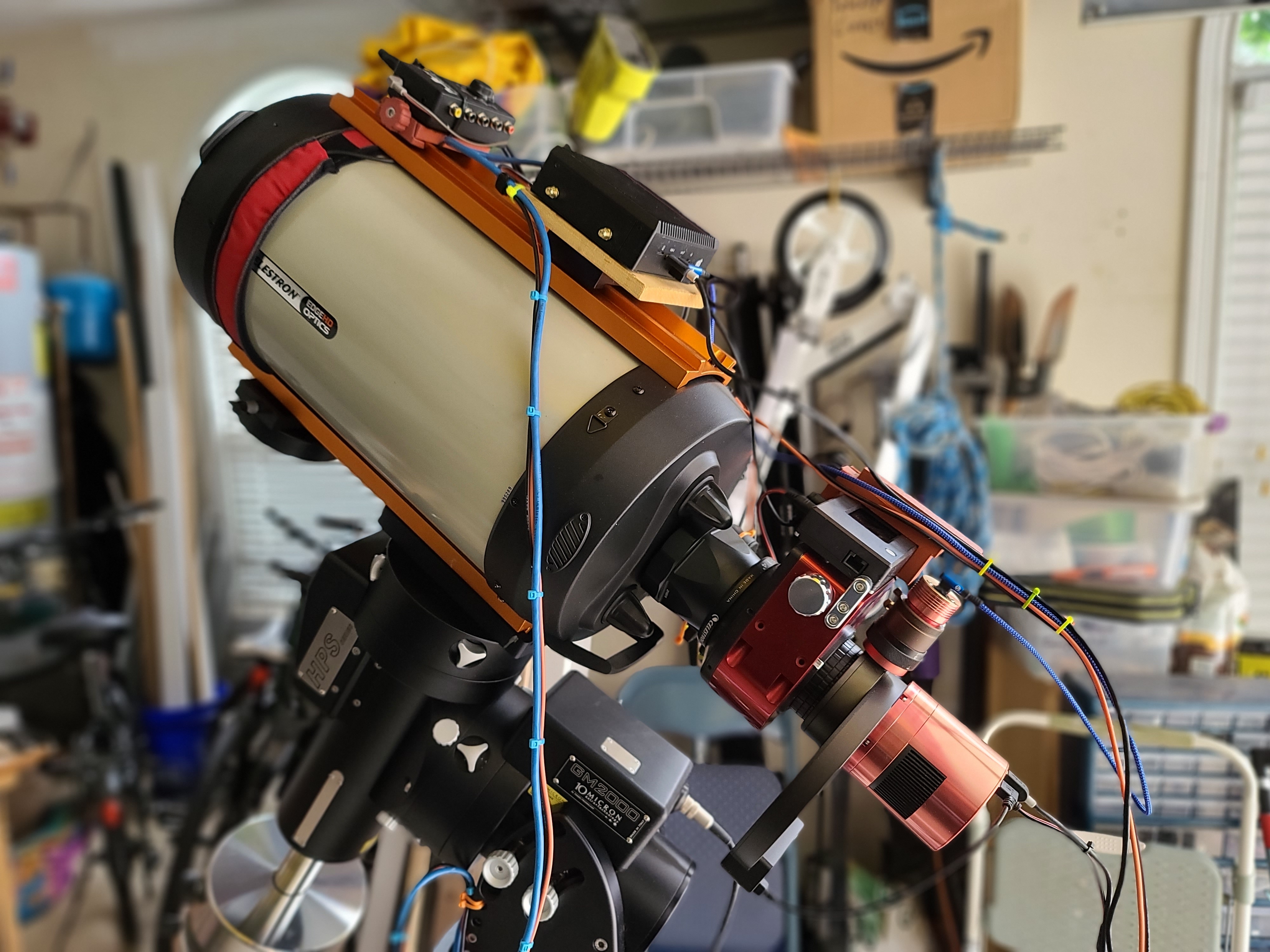

  • Edge 9.25HD OTA
  • Celestron 0.7x reducer
  • Esatto 2" Focuser with appropriate adapters
  • Celestron OAG
  • Celestron M48 to M42 Adapter
  • ASI1600
I have not had a lot of chance to image since the OAG was added, but here is an example image with the OAG in the image train:

Great set up. Exactly like mine 😀. Why do you need OAG with your mount?
pmont1 2.41
Thanks!  Although the 10Micron performs very good without guiding, there are times when I get slightly better performance with the OAG.
