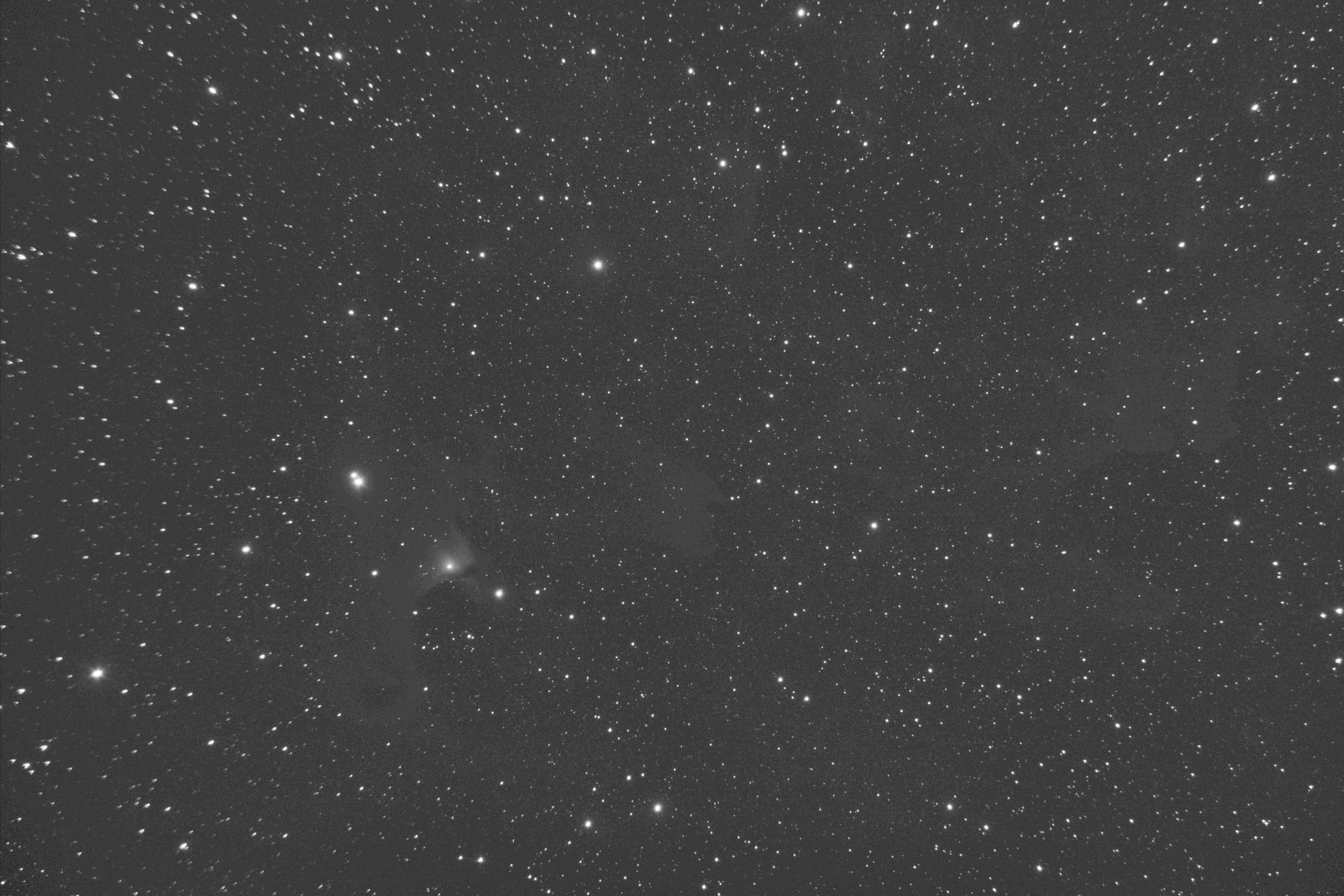

I have a brand new Celestron EdgeHD 0.25 with the x0.7 Reducer and the first time I used it with my ASI6200MM Pro full frame camera I could not achieve a flat field, even though I had the Celestron T-adapter and exactly 55mm back focus. I tried adjusting it a little using fine spacers (+1mm then +3mm) but things didn't improve. I wrote to Celestron for support and their answer was:
"This performance looks normal for a 9.25" HD with a .7x reducer; the performance in the corners at F/7 is not quite the same as at F/10.
I suggest using BlurXterminator (v4 AI) in PixInsight to help correct the off-axis star shapes."
Here is an example - this is single 600s subexposure of SH2-136 using a luminance filter and no additional spacers - so exactly the backfocus recommended. I may have some tilt plate adjustment still to do, but nevertheless is this really "normal"? Is anyone else using a full frame camera with the EdgeHD 9.25 w/0.7 Focal reducer and can confirm that this is the field flatness to be expected?
BTW, yes, BlurXterminator, using the "correct only" option, does fix it.

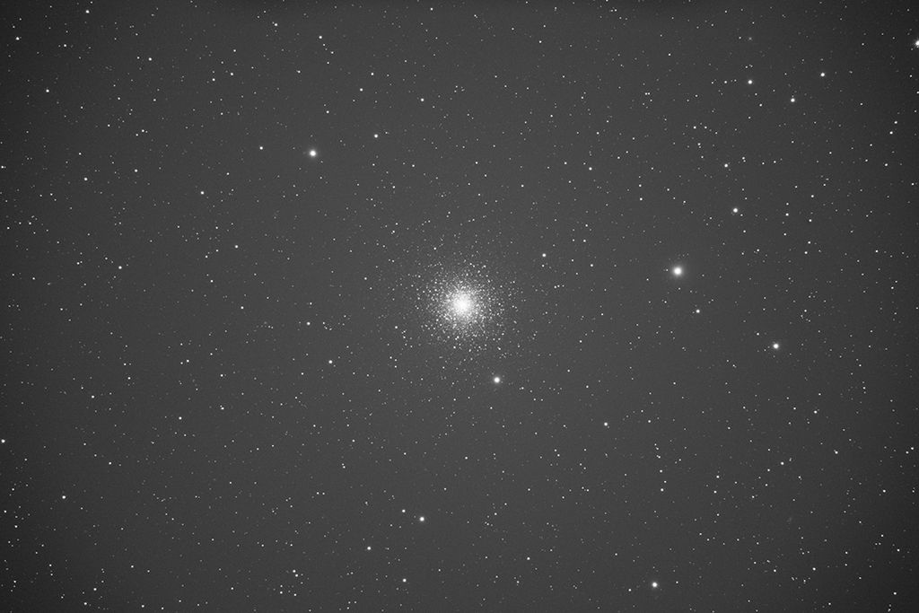

Hello - I image with the C9.25, .7 reducer and ASI 6200 camera as well.  I see similar distortion of the stars in the corners as you're showing but not to that degree.  I know there are some differences in our set-up but I thought I'd share my experience for information.
First, I have a Moonlite focuser in my imaging train.  I use a micrometer to measure out 147mm between the sensor and the focal reducer (adding 1mm for the filters).  That tells me the backfocus I should set for the focuser.  Then, when at the scope in the evening, I move the primary mirror and set focus using a Bahtinov mask.
Second, I have an ASG photon-cage and use NINA's aberration inspector to check for tilt and make the adjustments to get as flat an image as I can.
Here is a raw, sample image of the Pegasus Cluster with the Green filter for 3 minutes.  Not perfect, but I end up cropping for most images anyway.  I'm not sure if you could get much better with the .7 reducer.  I have also imaged at f/10 and gotten better stars in the corners but the FOV is less so kind of the same as cropping, lol!  I do bin 2x2 at f/10 to get .66 seconds/pixel.   With the reducer, I keep the binning at 1x1 and get .46 seconds/pixel.  Also, it is easier to adjust for tilt at f/10 since the critical focus zone is larger.

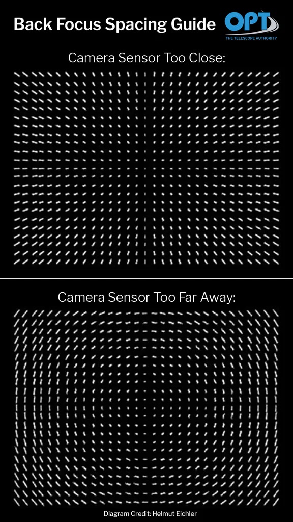

bdm201170 8.64
hi
i have the same setup
maybe some problem with backfocus , all corners  with the same pattern inwards
maybe sensor too close
CS, Brian

Thanks Brian. The only question is much more back focus do I need to add in addition to the T-adapter and 55mm?

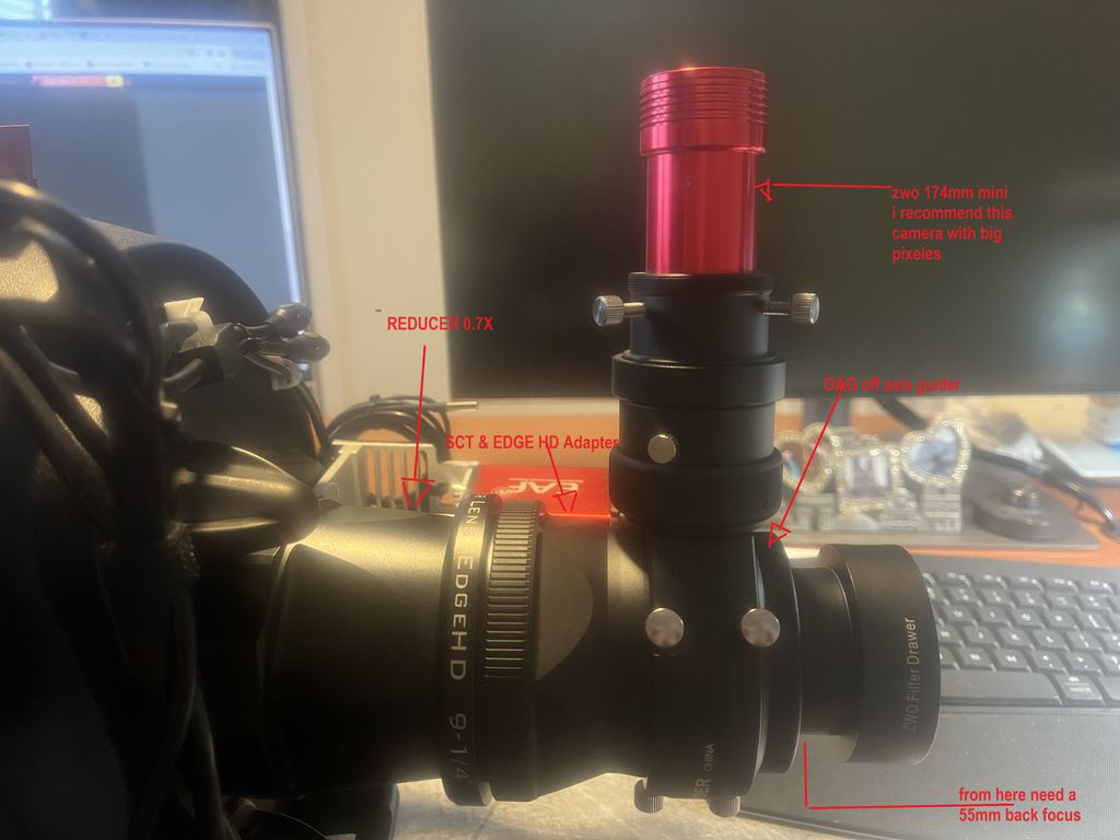

bdm201170 8.64
Chris Ashford:
Brian Diaz:
hi
CS, Brian
here is  my optical train

charles.tremblay.darveau 1.20
It seems like a combination of tilt and backfocus. You see that one corner (lower right) has better stars than others. I would add a bit of backfocus as Brian suggest and run the Aberration inspector in Nina. Collimation will also be more critical in full frame.

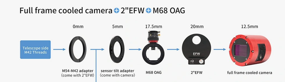

MaxFork 0.90
Chris,  I have almost same setup (EdgeHD 9.25, 0.7x reducer, ASI2400 full frame).  I see somewhat similar results, but I have elongated stars in one corner, pretty good stars center and other three corners.  Your image looks similar, in that you have sharpness in one corner but elongation in three.  It might be better to look at tilt before throwing $$ on spacers for backfocus.
More detail on my setup - 0.7x reducer - 91mm elongation tube (like Celestron 93636 but larger thread for FF sensor), then exactly as shown from ZWASI6200 page:
That gives me 91.5mm + 55mm = 146.5mm backfocus.  Note that the tilt plate is removed from the camera (leaving 12.5mm in image train), in favor of placing it forward in the image train.  Not accounting for that 5mm plate could complicate your calcs for backfocus.  Rudimentary tools in ASIStudio/ASIAir stronlgy suggest I have a tilt issue, as the mean star size is always  larger in that one corner.
One of these days. I will actually attempt to fix my tilt.
