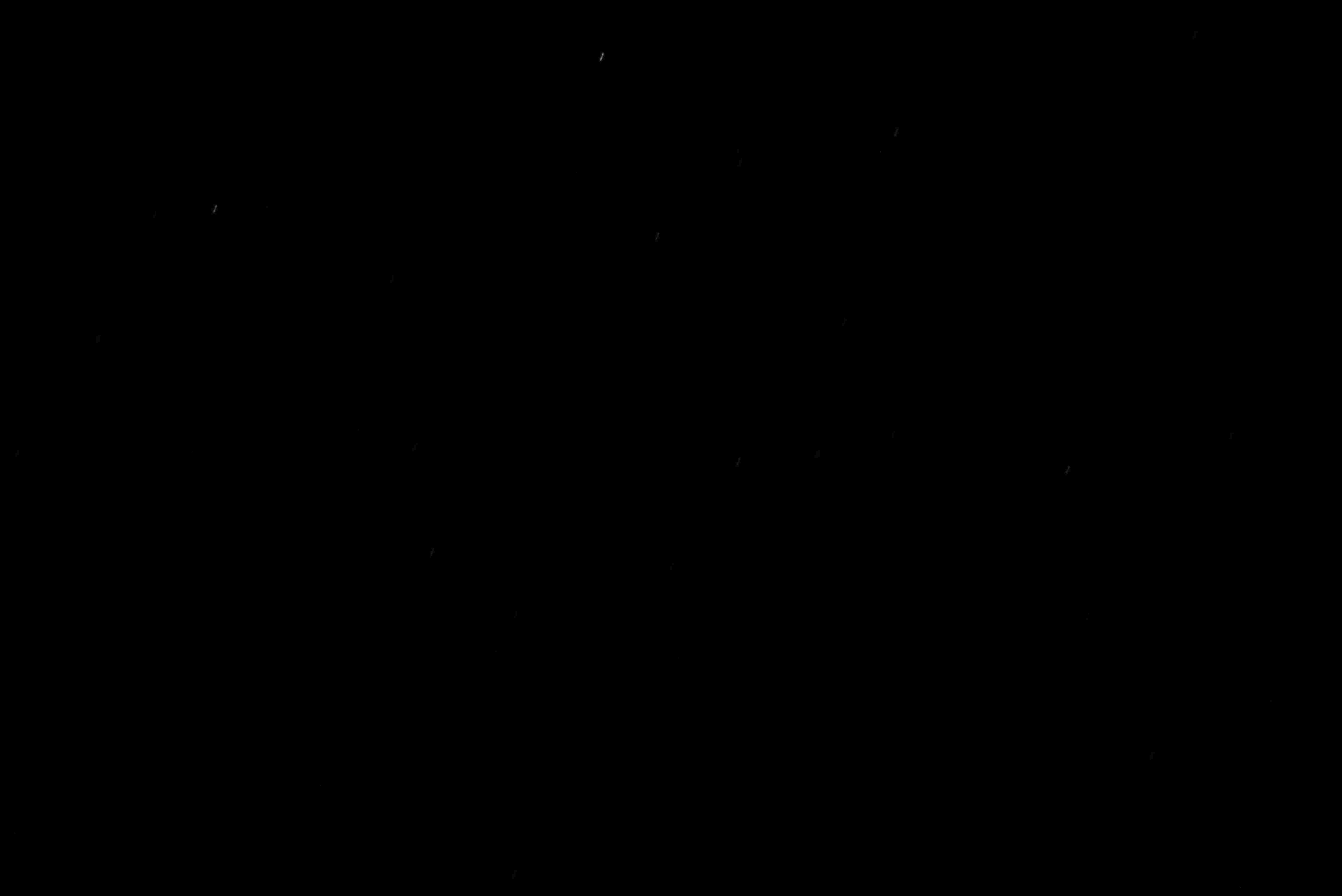

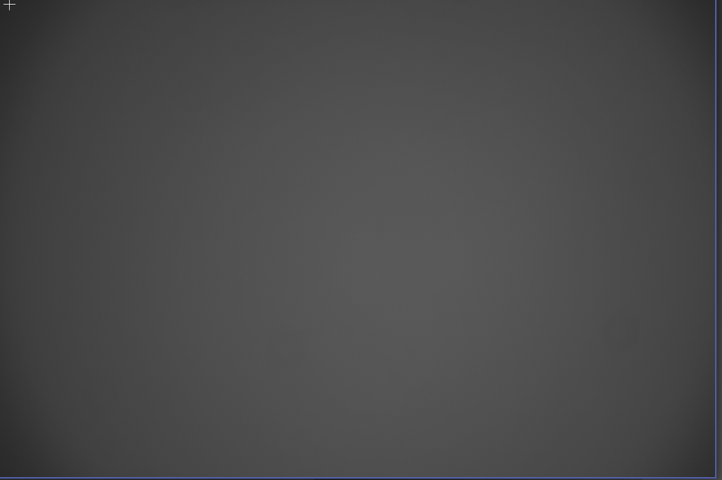

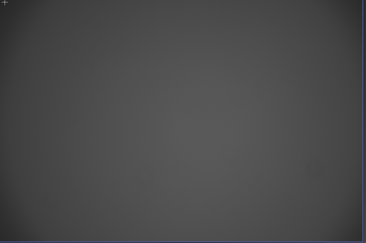

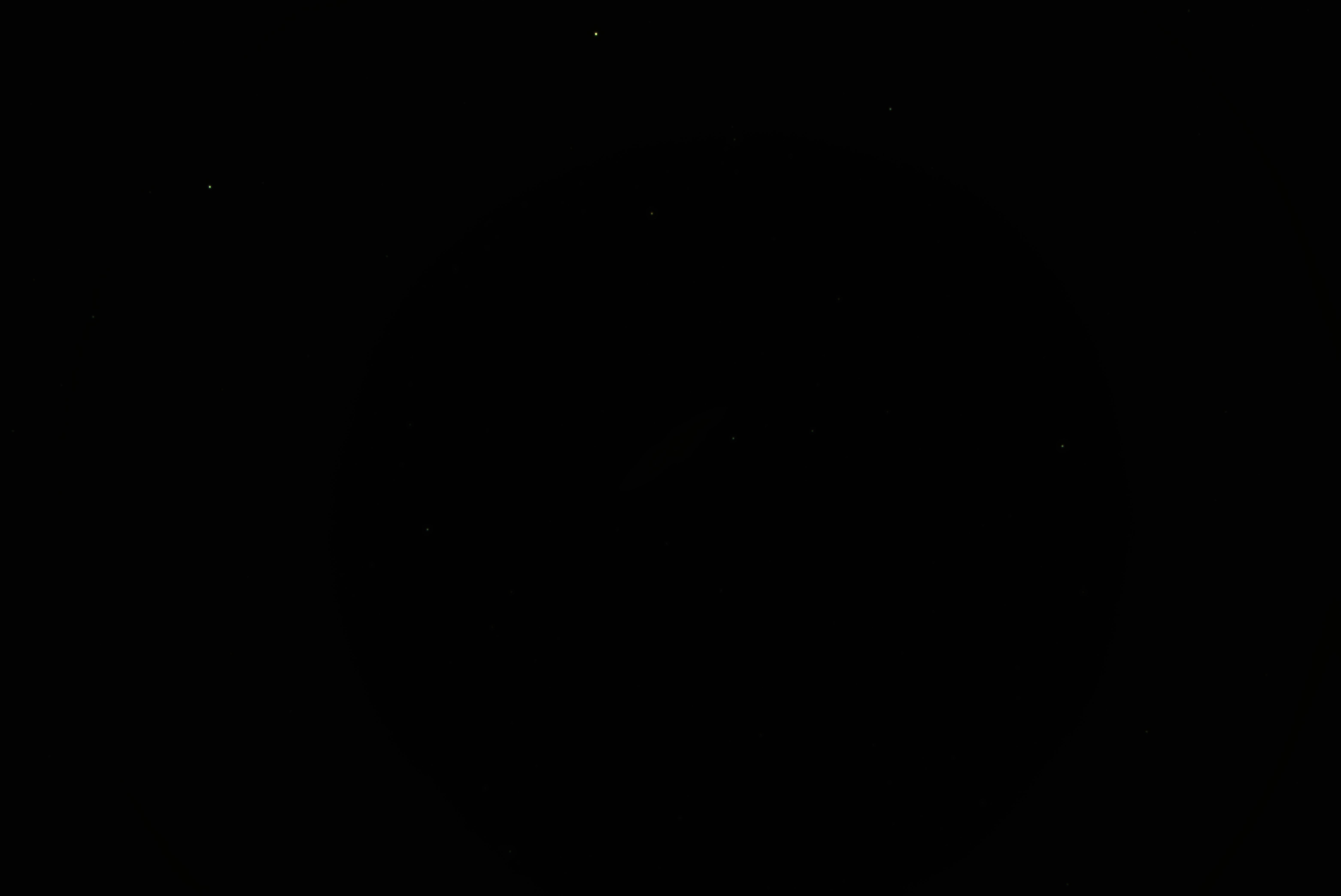

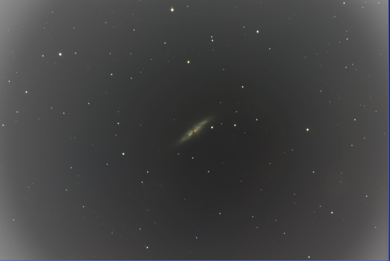

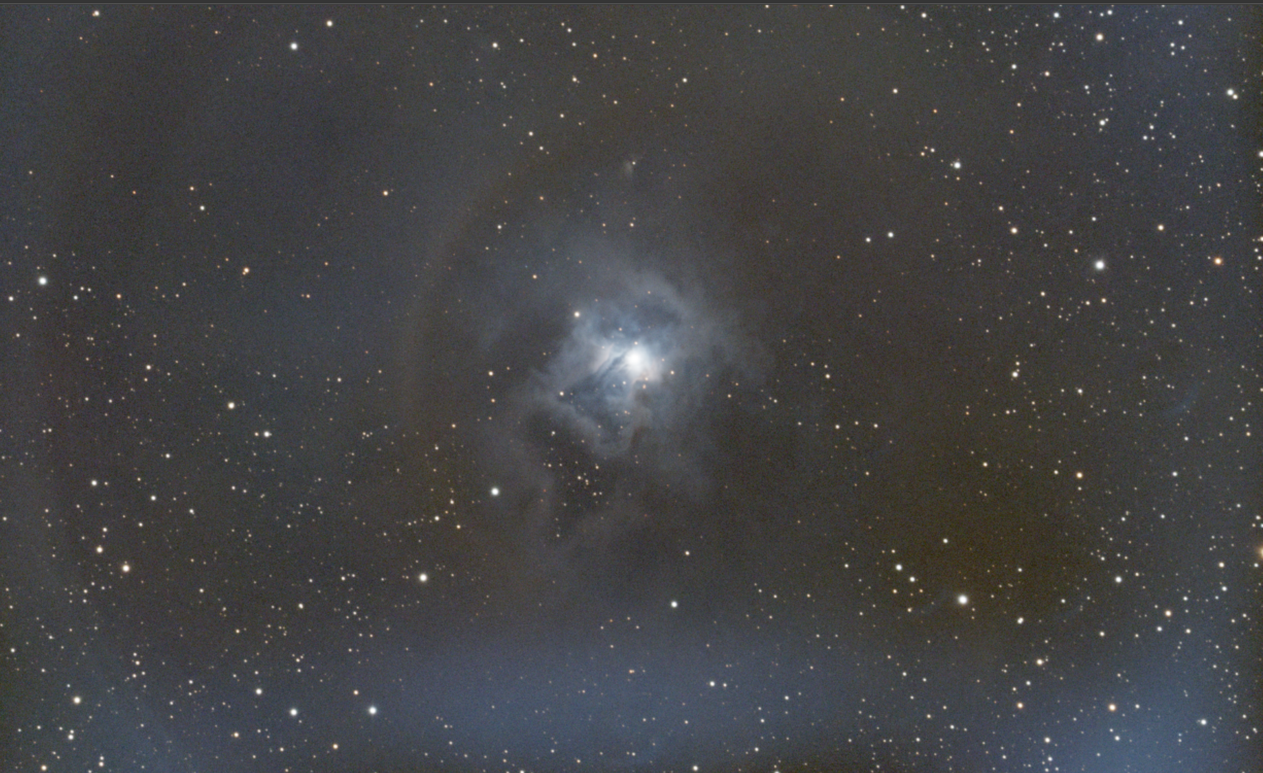

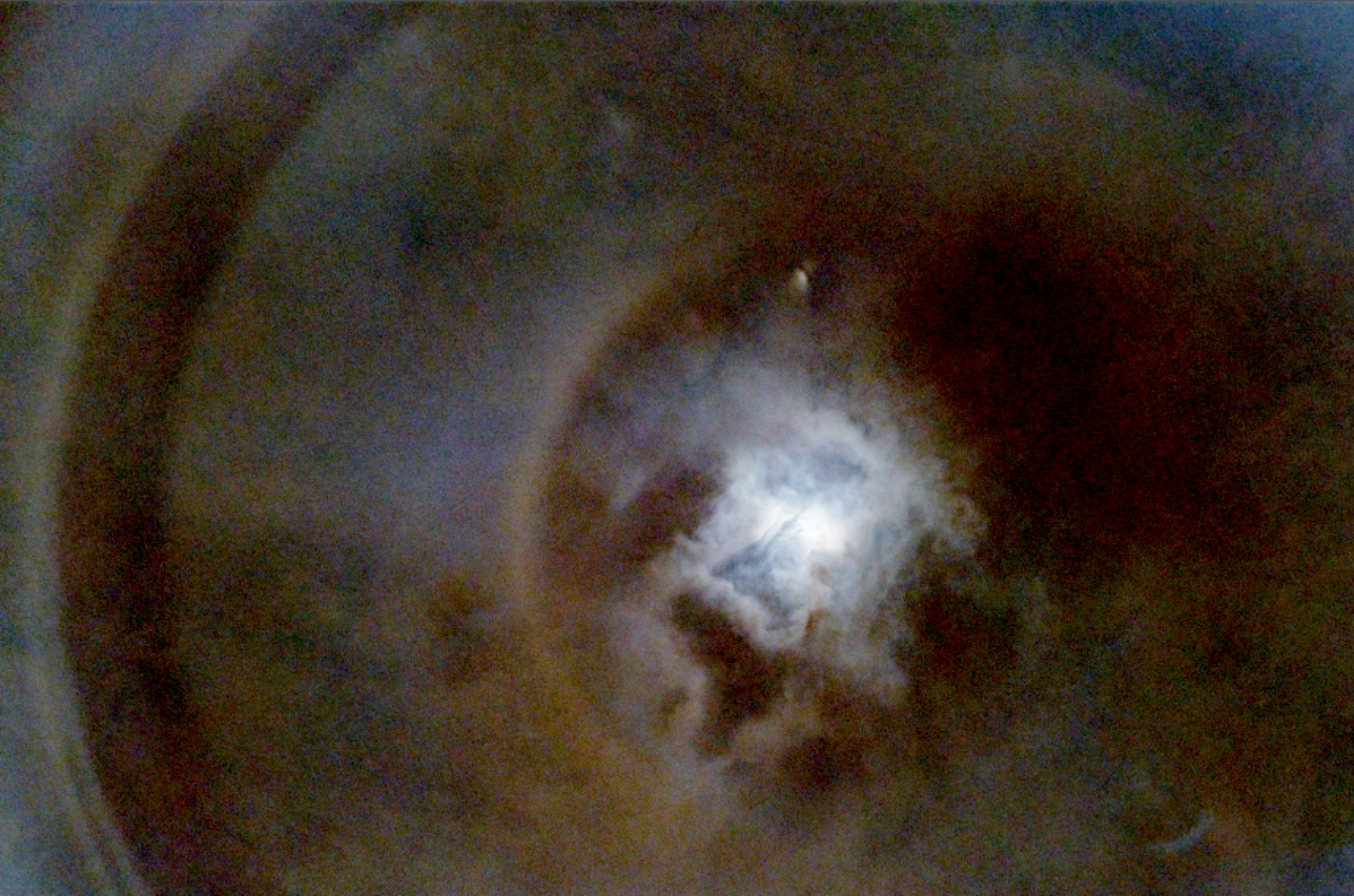

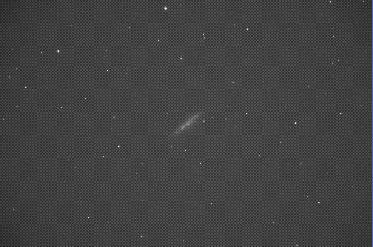

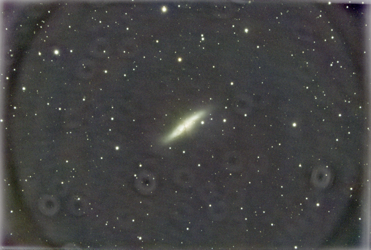

Hello
I have had an Edge HD8 for a while but have been waiting for optimization due to clouds of the northeast. I finally had some clear nights and got the focus dialed in, the guiding down to 0.6RMS and everything looked good. I took a full night of M82 as a test. The moon is out and near full but I hoped to have some better results. I am left with a nasty gradient that no gradient removal technique seems to touch, and dust motes that are uncorrected from flats. I think my issues are stemming from internal reflections most likely due to the 0.7x reducer but I wanted to ask the experts. Is it something I am missing? Should I toss the reducer and shoot at f10? If I go the full f10 route any advice on exposure lengths for the 2600MC  without any dualband filters? 2025-04-17_22-23-32_10.00_120.00s_0000.jpg2025-04-18_20-44-29_18.80_1.56s_0000.jpgmasterFlat_BIN-1_6248x4176_FILTER-NoFilter_CFA.jpgmasterLight_BIN-1_6248x4176_EXPOSURE-120.00s_FILTER-NoFilter_RGB_fastIntegration.jpgaftergraxpert.pngmasterflat.pngsingleflat.pngsinglesubstf.pngstf applied only.pngThankyou for your help.

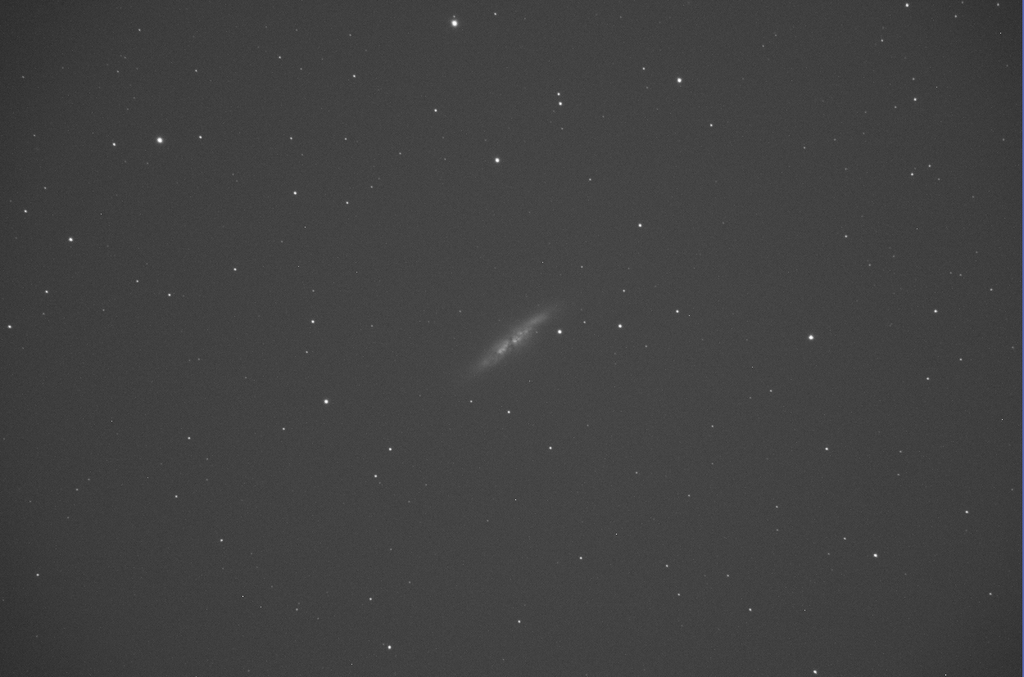

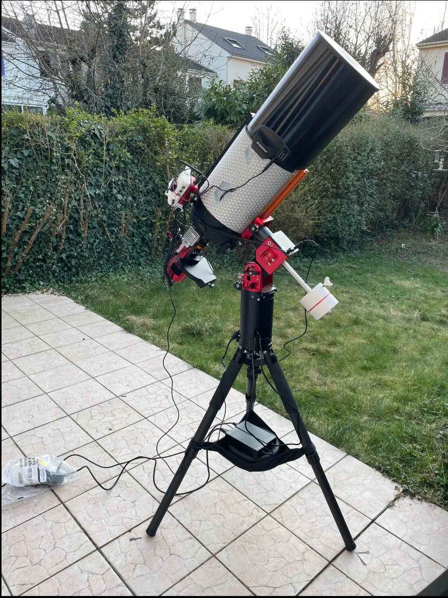

Majungai78 1.51

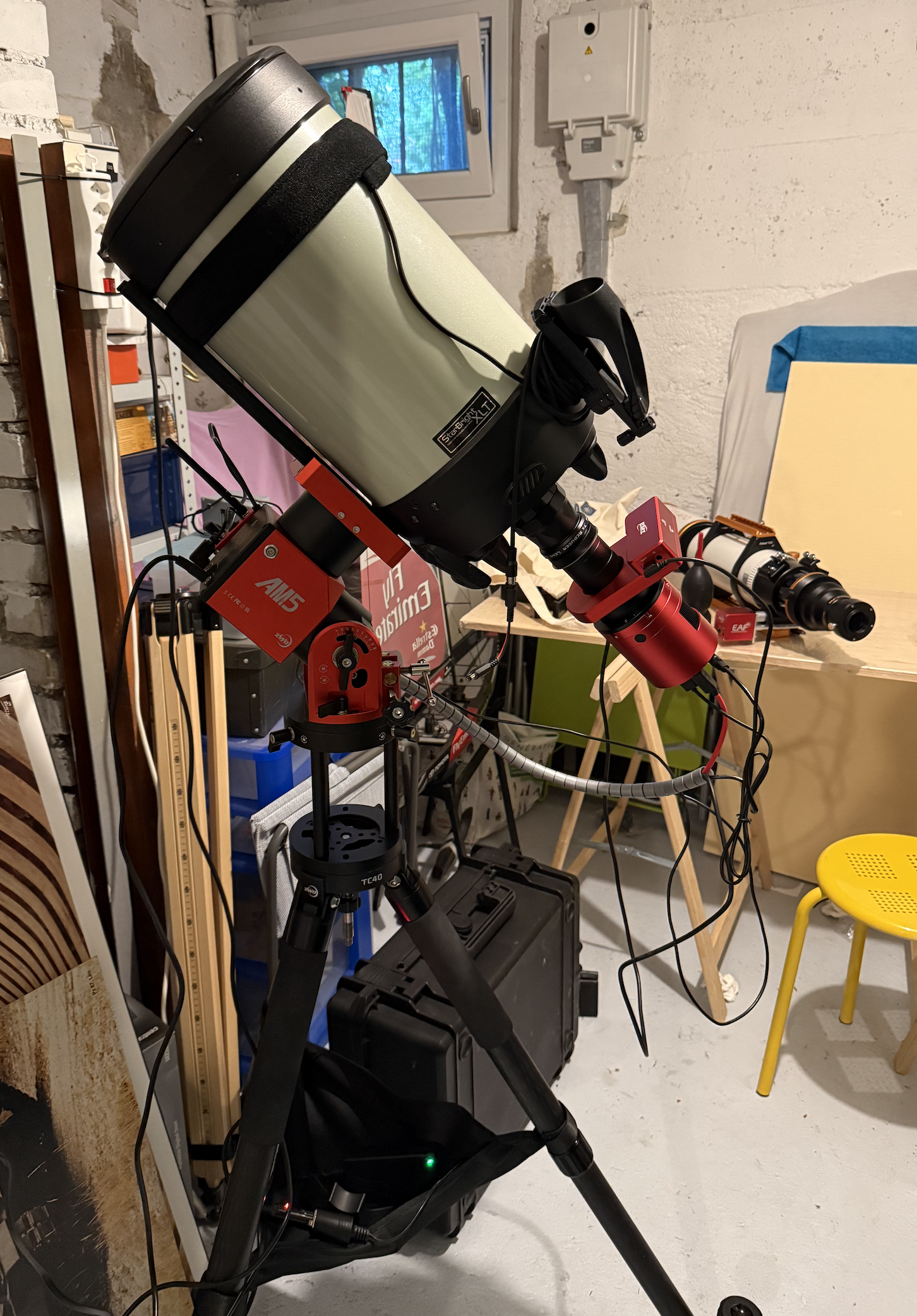

Hello Dan,
I have the same equipment as you and recently photographed M81 and M82 without any problems in an urban environment. See my astrobin post (https://www.astrobin.com/fs9tp5/) . When the Moon is out, it's important to have a dew shield: Celestron's aluminum ones are perfect!
Loïck
See my equipment below on my garden terrace.

Recheck your basic steps.
I use almost the exact set up and have never had these issues
Is your back focus correct ( 105mm)?
How do you take your calibration frames: flats, bias, and darks, and how many of each?
Use an air bulb to clear the dust from your camera lens before imaging.

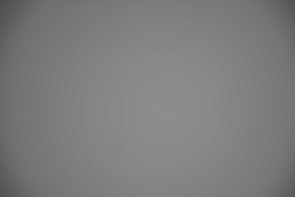

Apart from having a dew shield in place which might help somewhat you have also an issue with vignetting which renders flattening more difficult but you can use one (or few) of of the light frames to create a sky flat which would allow to remedy some of the obvious flaws and possibly salvage the final stack (to an acceptable level). Needless to say the reason for this behavior is the reducer and you'll be better off binning the camera and image a f/10 if the target fits in the FOV.
I could go on describing how to do but not sure if it is a waste of time so if there is some interest I might do it.

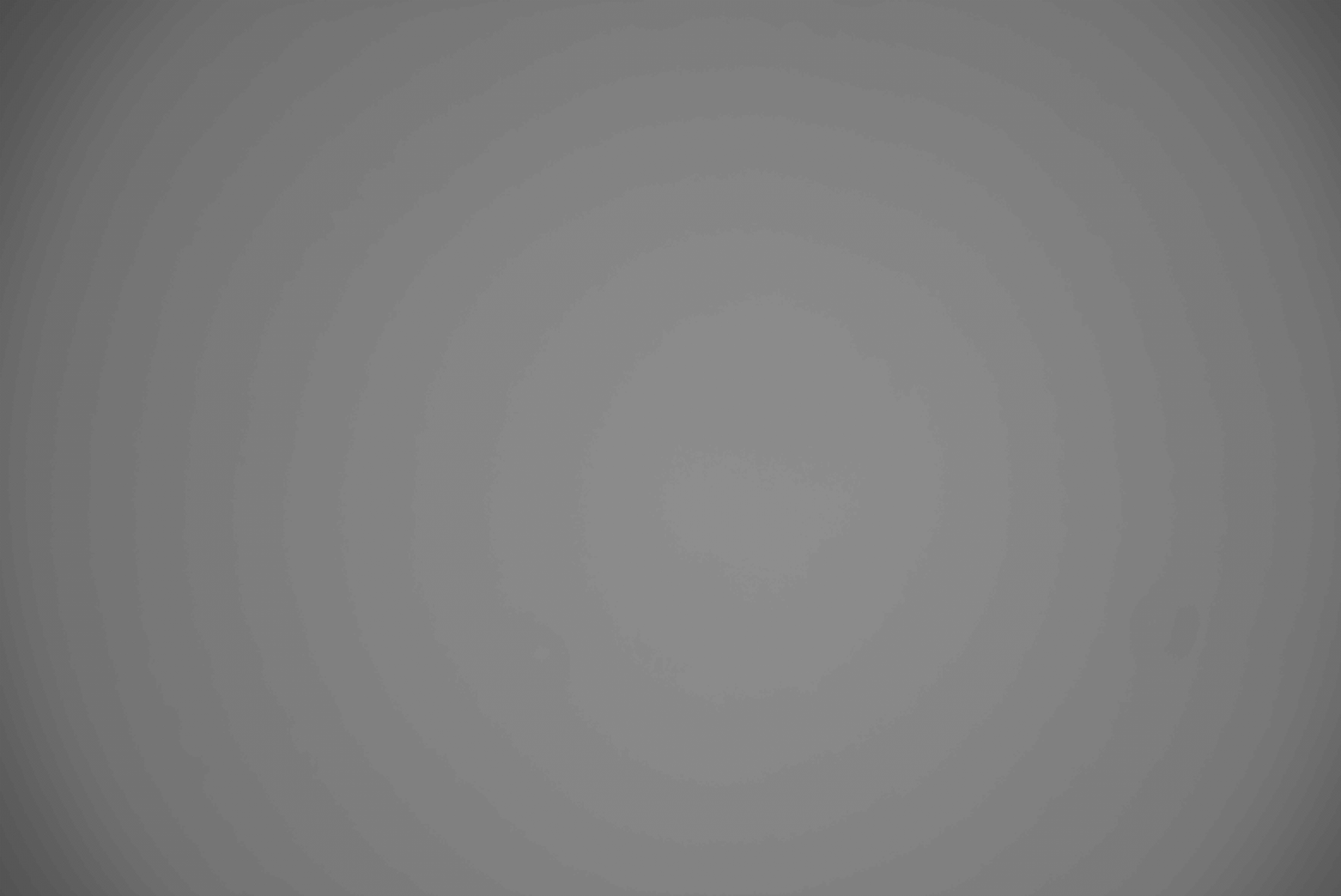

dzauski585 0.00

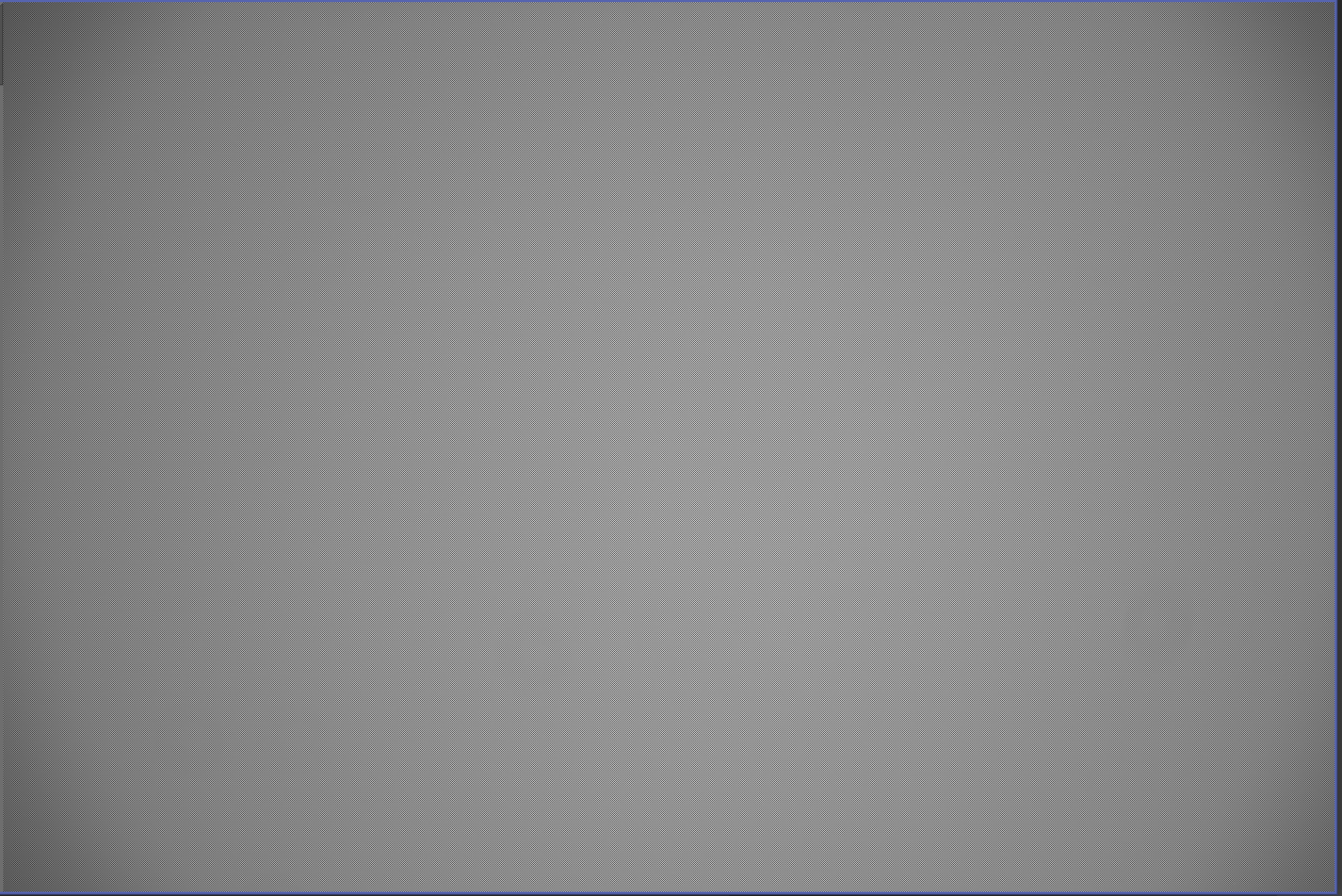

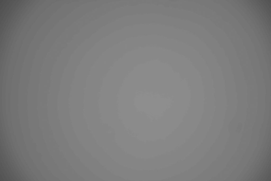

Thanks for all the replies so far. I have the aluminum dew shield from celestron. I take flats with the flat wizard in Nina and a led light panel and a white tshirt. I am 90% sure my backfocus is correct. I have the reducer then the celestron oag then the 2600mc with a spacer. I am traveling right now so I don’t have the exact measurement with me. I have cleaned the sensor and glass with the air in the past. I will keep trying to tweak things.

The reducer is 99.99% the reason for this. I went through the exact same thing a couple of months ago and got some invaluable help from another member who also had been through the same. In short I got rid of the reducer which was fine with smaller sensors (and perhaps NB) but after that no issues at all. Imaging at F/10 I have been using 60-120s mostly. But yeah, unless you can guide/track at 0.38" average you will need to bin in post. I downsample x2 in Pixinsight which works fine.

The Reducers on the 8HD are hot garbage. I've seen 50% increases in spot size, leading to massive sharpness issues. I've also noticed that the ADU's are nearly equal at the same exposure lengths with the F/7 reducer, as if the increase of glass leads to an equal speed as F/10. Regardless, I've found F/10 to be sharper, and more friendly to APS-C and larger sensors. The 8HD can nearly correct the entire field of view if it werent for the vignette.
Nothing should really change at F/10, go for about 1.25x the integration you would have gone for just for safe measure.
I would also downsample your images to about 0.6"/px.
If you decide to stay at F/7, with the flats you want to try to match the background brightness across the flats and lights. It's super sensitive to invariance.

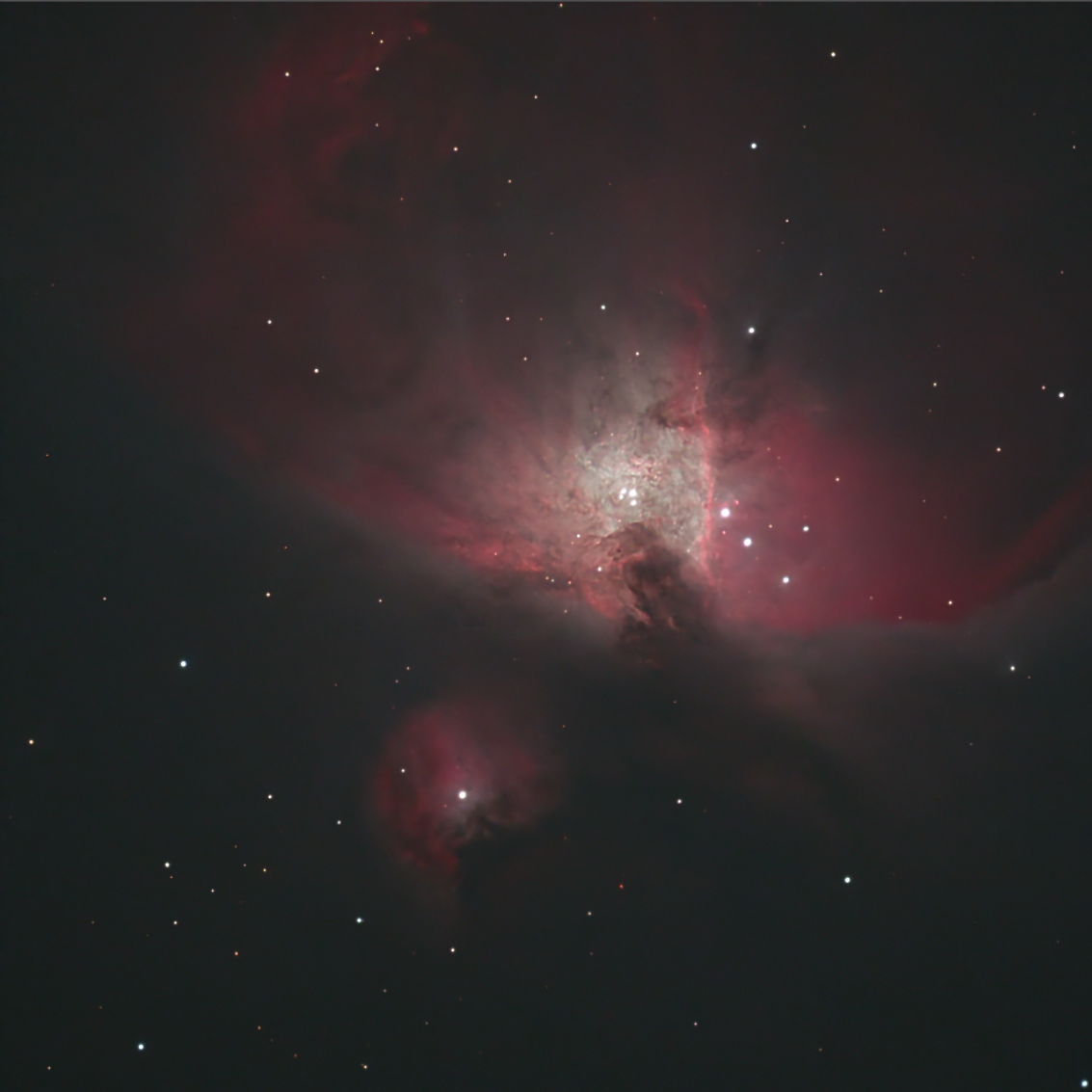

I used my IMX533 with the reducer which was just fine. Everything calibrated as it should and I never really knew about these issues, which are sensor-size dependant. Hence the "533 vs 2600 makes all the difference" comment, it was not meant in a bad way! I get what you're saying about the dust motes, but they were also part of the symptoms I saw when troubleshooting on my own - without there being anything wrong with the actual flats.
Sadly I've lost most of the data from back then, but this is a 20 second sample (1x5s each of LRGB) with the 533MM, calibrated:
Then there's the calibrated 2600MC stack of about 12 hours:
The only change was the sensor size. Same scope, same reducer and the same image train more or less as well as still shooting broadband data. Clear circles where the light has reflected on the bright inner sides of it and left over dust motes (even though they were in the flat frames). As soon as the reducer was removed every dust mote got calibrated and no more circles. If I was still using my IMX533 in stead of IMX571 cameras still I would probably not have this issue at all. I was told that NB data would probably not have those reflections either- but I have not done any more testing. Clear, dark nights are too few to be spent messing around with that reducer
Personally I didn't remove it due to lack of sharpness, I thought the data looked quite good besides the obvious issues. I was also told by Celestron that the reducer was faulty, which implies that they do make ones that aren't. Maybe its a early batch problem, but I'm not tempted to test that theory as long as most people I talk to seem to have the exact same experience.

Daniel.P 0.00
Hello Dan,

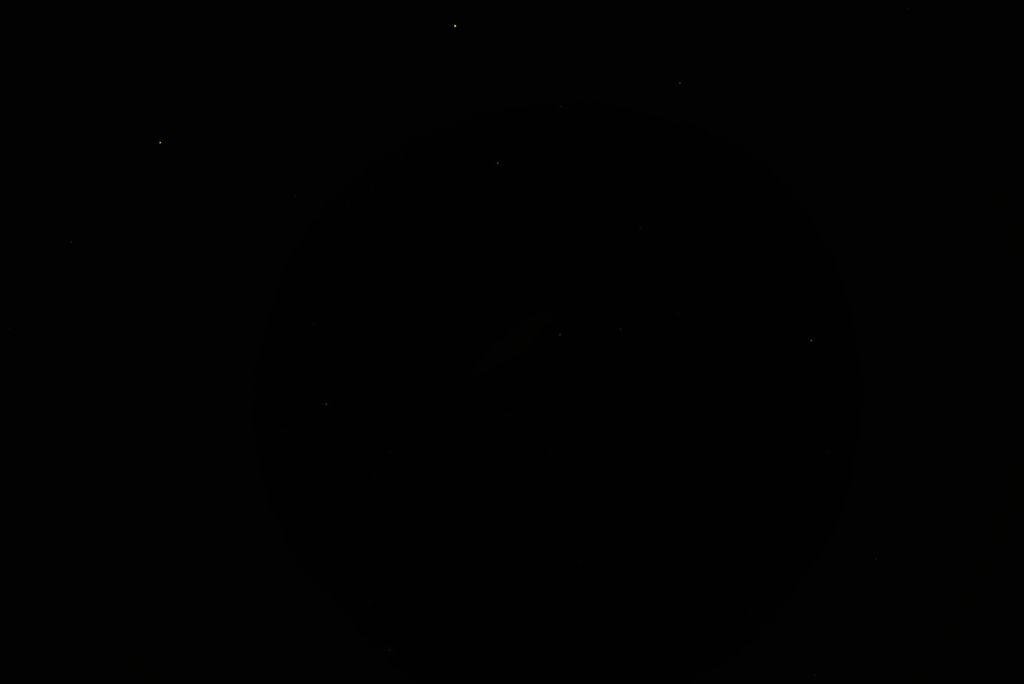

I noticed that on your 5th image, the donuts from dust are present on the image.
This should normally be removed by flats.
This same problem occurred to me long time ago, and the reason was that the bias (or offset) of either my flats or my images was not properly removed.
On your images the dust donuts appears white, meaning that your flats are overcorrecting the image. I think this can happen when image bias is not fully subtracted or when flat bias is over substracted.
Hope this could help you …
Daniel

jhayes_tucson 26.84
Dan,
You’ve received a lot of good advice here but I’m going to toss in my two cents anyway.
1) In my experience, reducers are almost always problematic.  A few work but most introduce excessive optical aberration, stray reflections, or extreme vignetting.   So, my first recommendation is to get rid of the reducer.  You certainly don’t need it for imaging M82—or for that matter, most galaxies.
2) It looks like you have a combination of too much vignetting and perhaps some internal stray reflections.  Removing the reducer will probably fix the vignetting problem.  Make sure that all of the internal surfaces of your connector tubes are well blackened.  Also make sure that there are no light leaks anywhere in your imaging train.
3) Dust motes appear for only two reasons:  A) something moved (or changed) causing a registration problem or B) your calibration data is not being properly applied.  First, clean out all that dust!  Take everything apart in a clean environment, wear gloves and a face mask, and blow out ALL of the dust.  Examine the surfaces under a bright light to make sure that there are ZERO particles on the optics and sensor.  Then reassemble the system and use high quality vinyl tape to seal any gaps so that dust cannot get in.  Then make sure that you are properly calibrating your data using flats, matched darks, and bias.
Get everything working flawlessly without the reducer and then if you want to go back to try it again, you’ll be able to more easily isolate problems that it might be causing.  Again, I don’t recommend using a reducer.   It is much better to get a bigger sensor to gain FOV.
Good luck with it!
