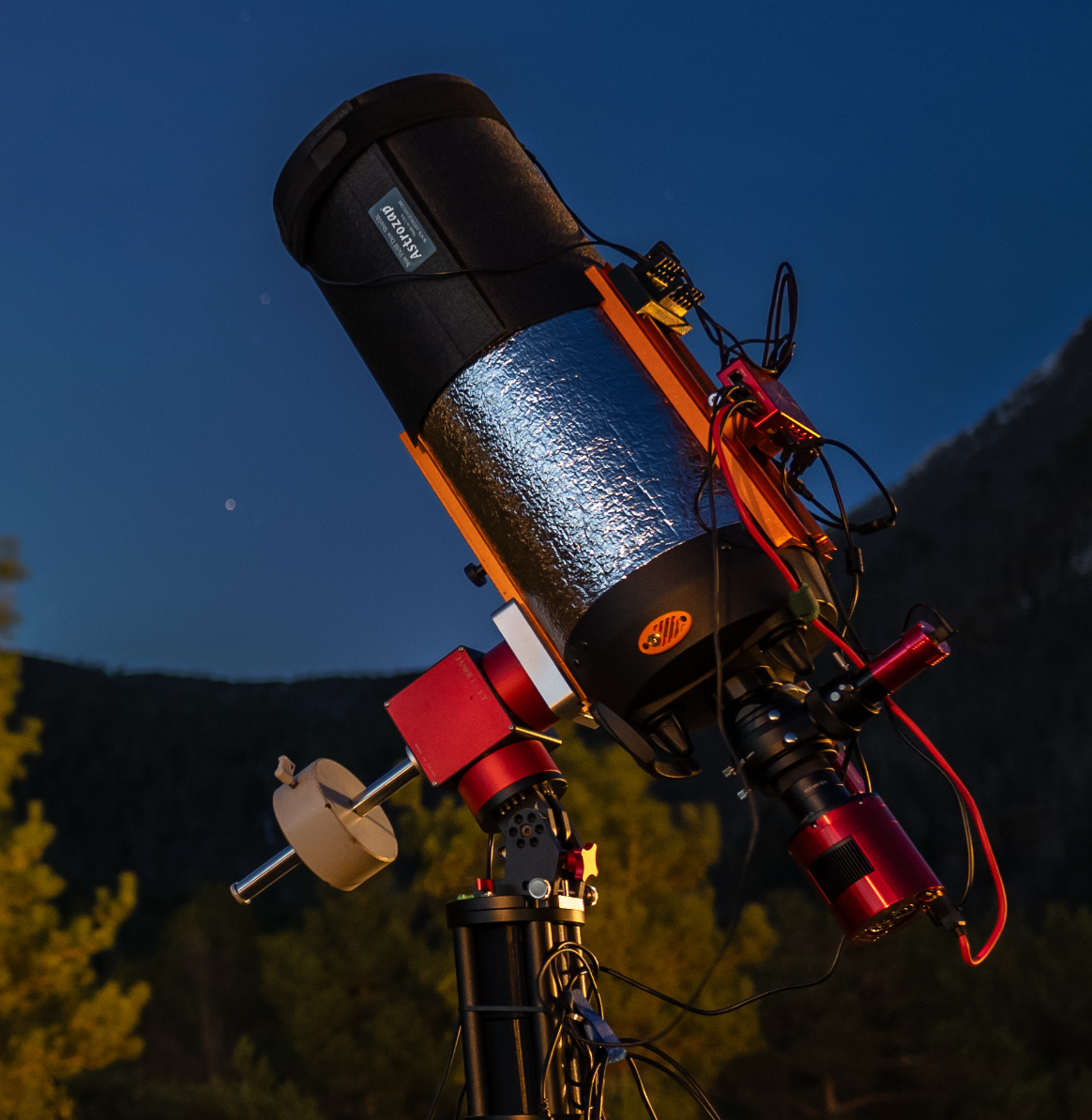

Hi there! I've been using mine with the ZWO EAF focuser on the focus knob. I don't really see any issues with mirror flop or focus changing throughout the session. Quite often I find focus is pretty close between sessions as well. Moving the focuser will shake the mirror a tiny bit, but it doesn't take long to settle. I looked into adding a focuser to the visual back as well but realized that it would create problems with backfocus, especially if you want to have additional accesories in the image train. Here's how mine is set up, EAF on the opposite side unfortunately:  FWIW I've also used the Gemini focuser with it and it works just as well as the ZWO focuser.
Hi there!

Thanks again and best wishes from Scotland! Yeah, once I got it all set up I was pleasantly surprised that I didn't see any issues with focusing. However I forgot to mention how I've set up my focus routine which probably is of some importance.. I run AF on startup, meridian, every 2 degrees temp change and every two hours. This is probably a bit overkill if I'm being honest, I added the 2 hour one a few months ago because the temperatures may be very stable but it still may need a slight re-focus from time to time. Thank you for the compliment! I love Scotland! Kind wishes returned from Norway!

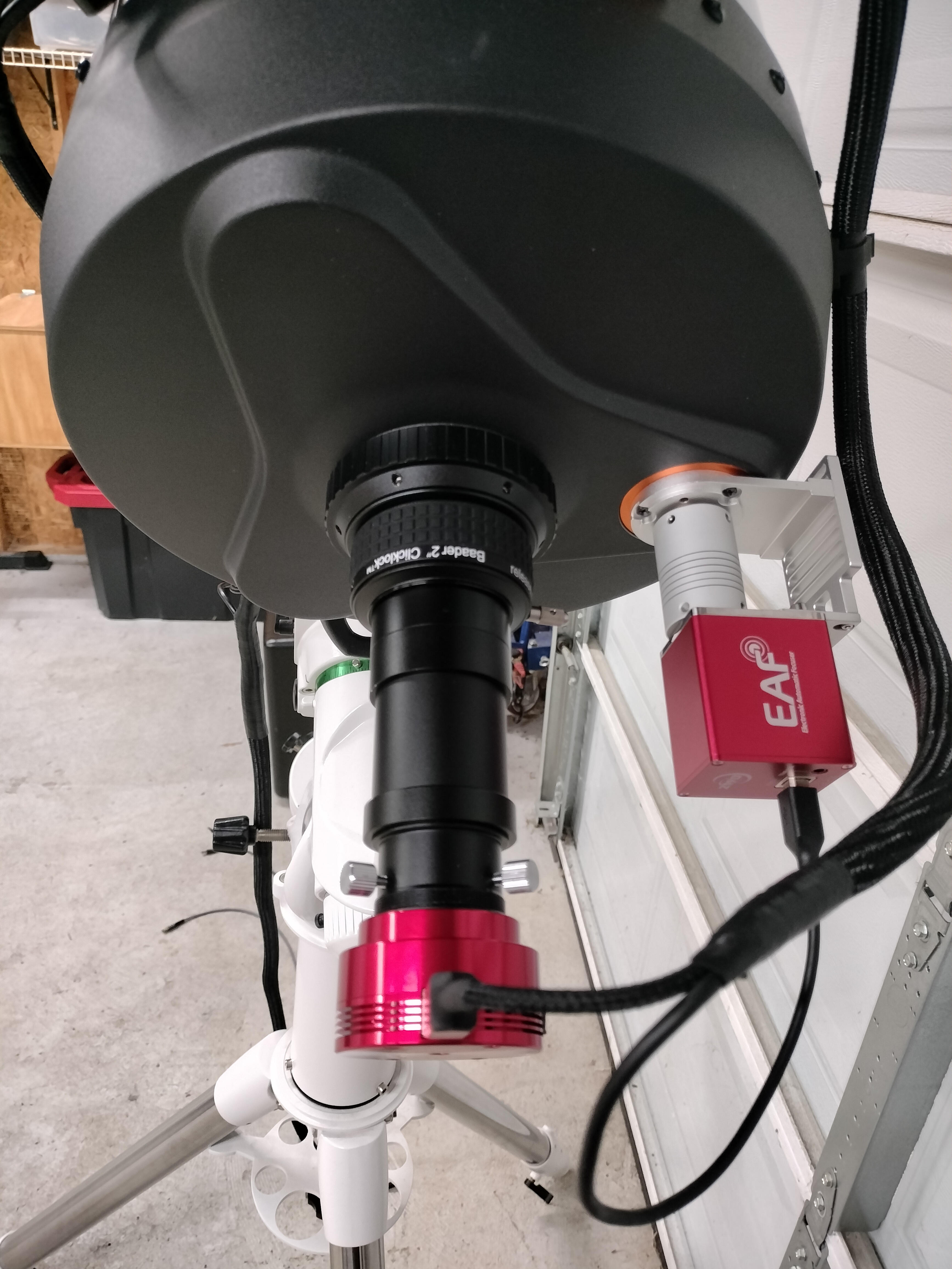

I have a ZWO EAF with SCT kit installed on my C11 and 9.25 SCTs and both work great. Easy to install. I don't have to worry about back focus issues when using a reducer in the image train. C11 pictured  |
