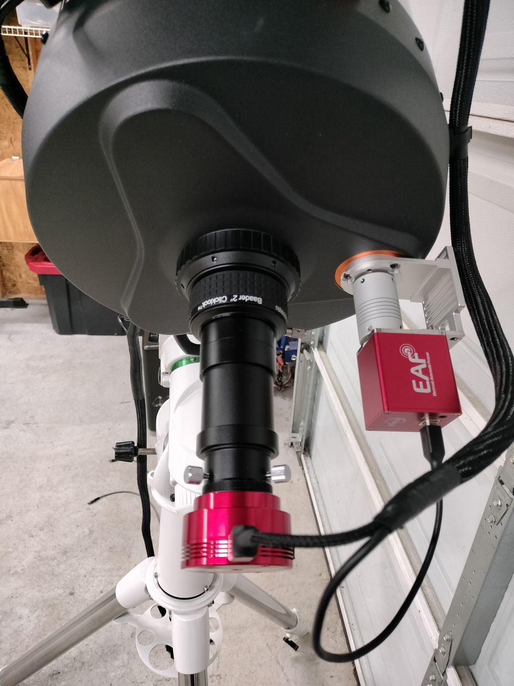

I've been using mine with the ZWO EAF focuser on the focus knob. I don't really see any issues with mirror flop or focus changing throughout the session. Quite often I find focus is pretty close between sessions as well. Moving the focuser will shake the mirror a tiny bit, but it doesn't take long to settle.
I looked into adding a focuser to the visual back as well but realized that it would create problems with backfocus, especially if you want to have additional accesories in the image train.
Here's how mine is set up, EAF on the opposite side unfortunately:
FWIW I've also used the Gemini focuser with it and it works just as well as the ZWO focuser.

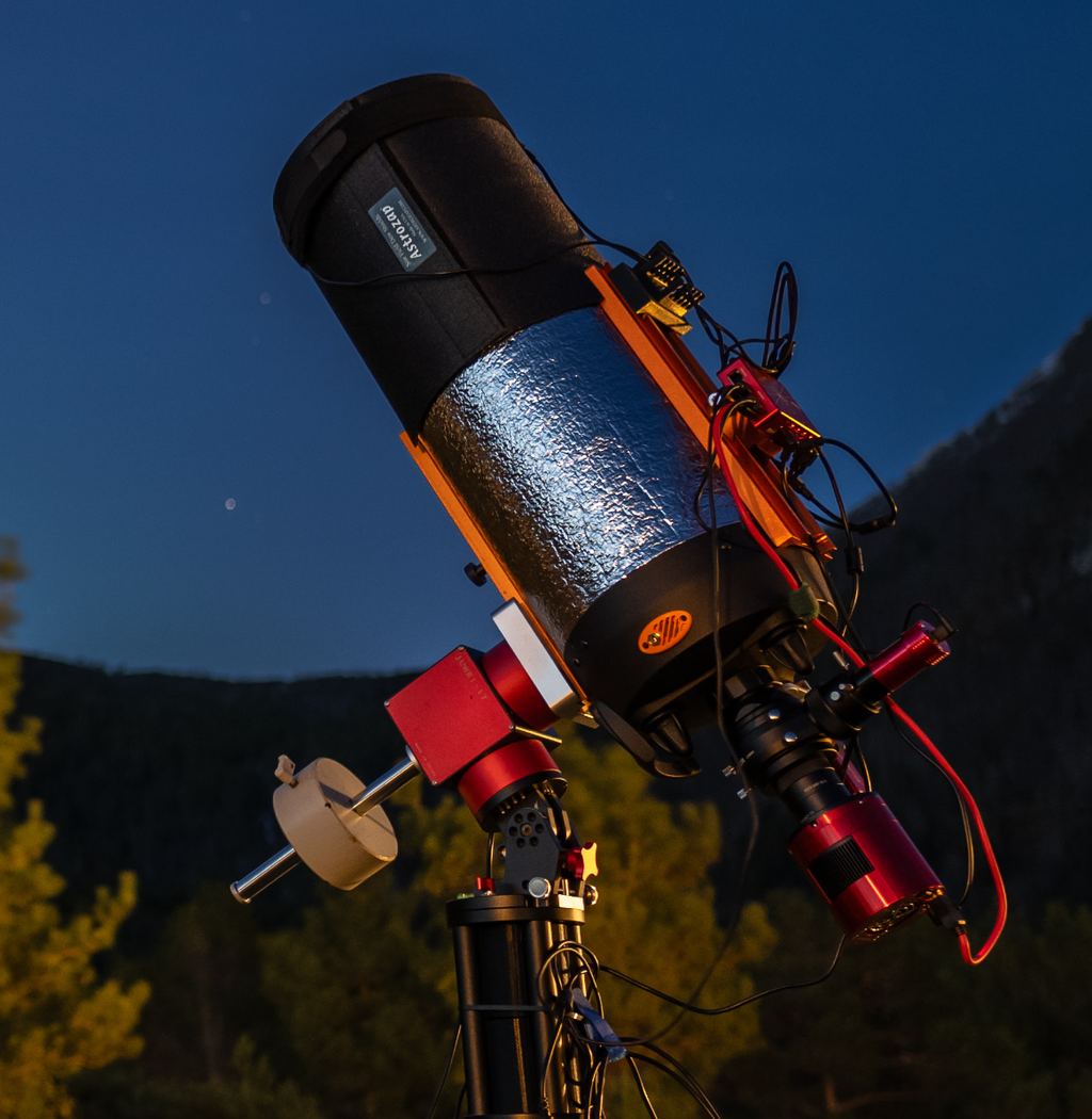

I have a ZWO EAF with SCT kit installed on my C11 and 9.25 SCTs and both work great. Easy to install. I don't have to worry about back focus issues when using a reducer in the image train.
C11 pictured

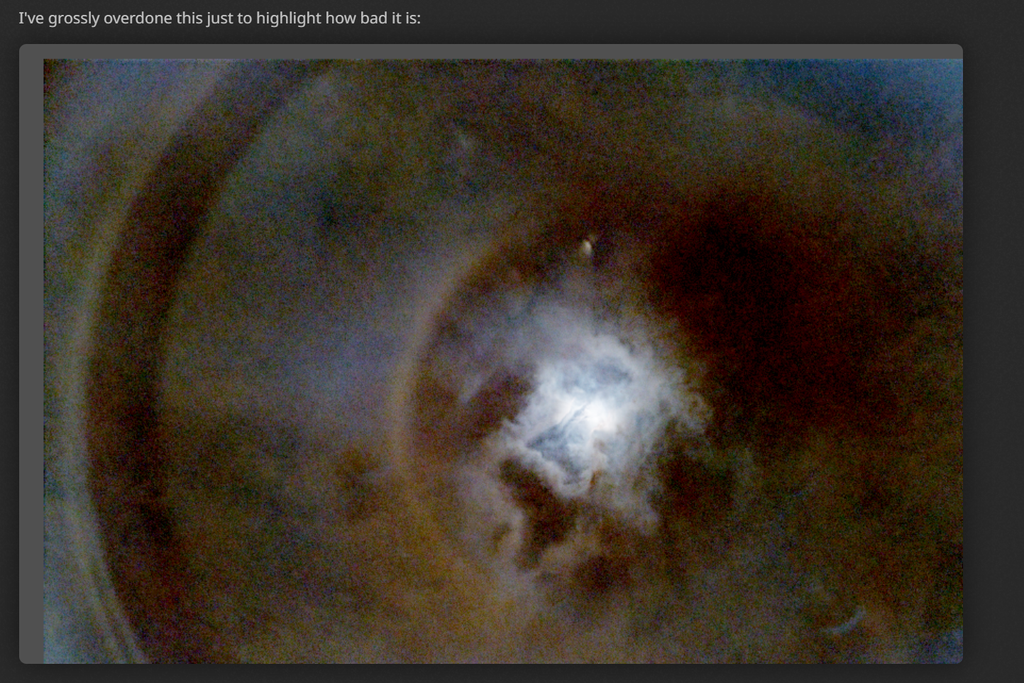

Mine seemed sharp enough (in the center at least) but this is a heavily stretched and calibrated stack of ten-twelve hours, just utterly hopeless..
(https://www.astrobin.com/forum/c/equipment-forums/celestron-edgehd-8/issues-with-sct-calibration-frames/?page=2)
