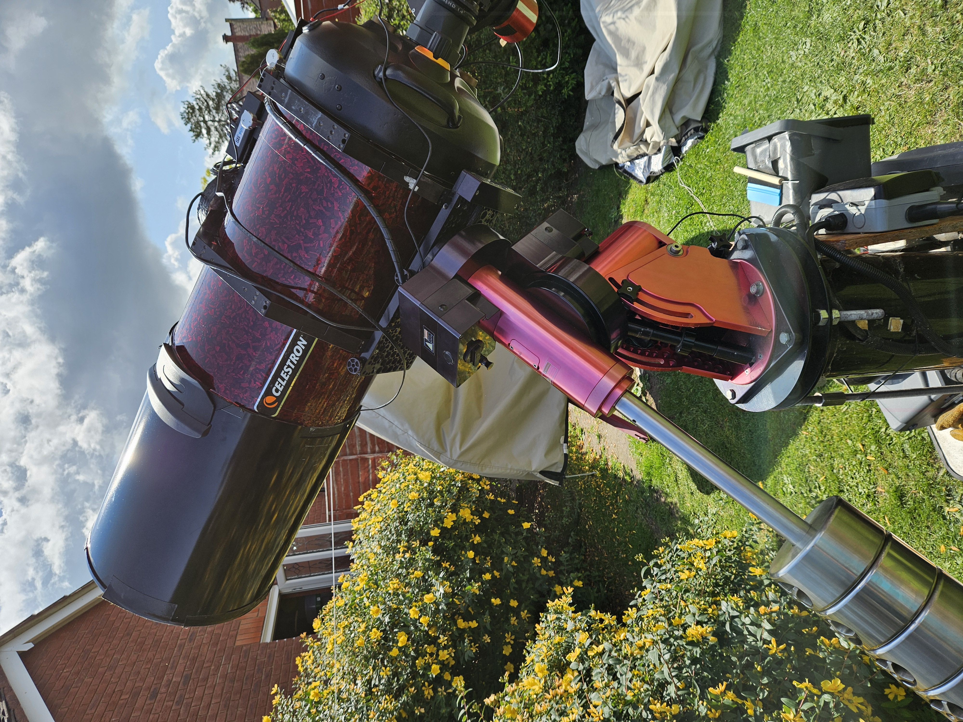

I use the C14 edge at F7.7 using the Celestron reducer. The ONAG is essential along with the Optec SMFS & Optec focus locks- just remove the Celestron focus locks & replace with the low profile Optec locks (they do a much better job of locking the primary mirror).
I've just redesigned the adaptors to squeeze in a Falcon V2 rotator for the camera. I'm awaiting the arrival  new adaptors from precise parts for this configuration.
I use the Celestron Aluminium dew shield with a fabricated internal cable mount to loop the SMFS ethernet cable thus avoiding diffraction spikes. The Celestron dew rings are simply bad ideas especially coupled with the ludicrously expensive Celestron dew controllers. I use a dew band wrapped around the dew shield just in front of the corrector and I never get dew. The Celestron dew shield, whilst expensive, is the best I've used so no complaints there.
Balance can be an issue. I've got the OTA as far back in the rings as I can but can't achieve balance this way. The image shows a 7KG counterweight on top of the OTA to achieve balance however I've addressed this in the rebuild by extending a front ADM rail & attaching a weight assembly there thus saving about 5.5 kg in balance weight. I guess the paramount in this setup is carrying around 35 kilos. The setup has now been modified slightly but the picture gives the gist of the configuration.
My primary mirror is locked, I focus with the SMFS and the C14 is held on the Paramount MX+ using Bisque rings to get a great pointing model and improves the rigidity of the OTA vs the flimsy stock Celestron knock off rails.  Whilst I could use Skyguard I don't like its reliability so I use PHD2 and NINA handle the periodic focusing using Hocus Focus.
