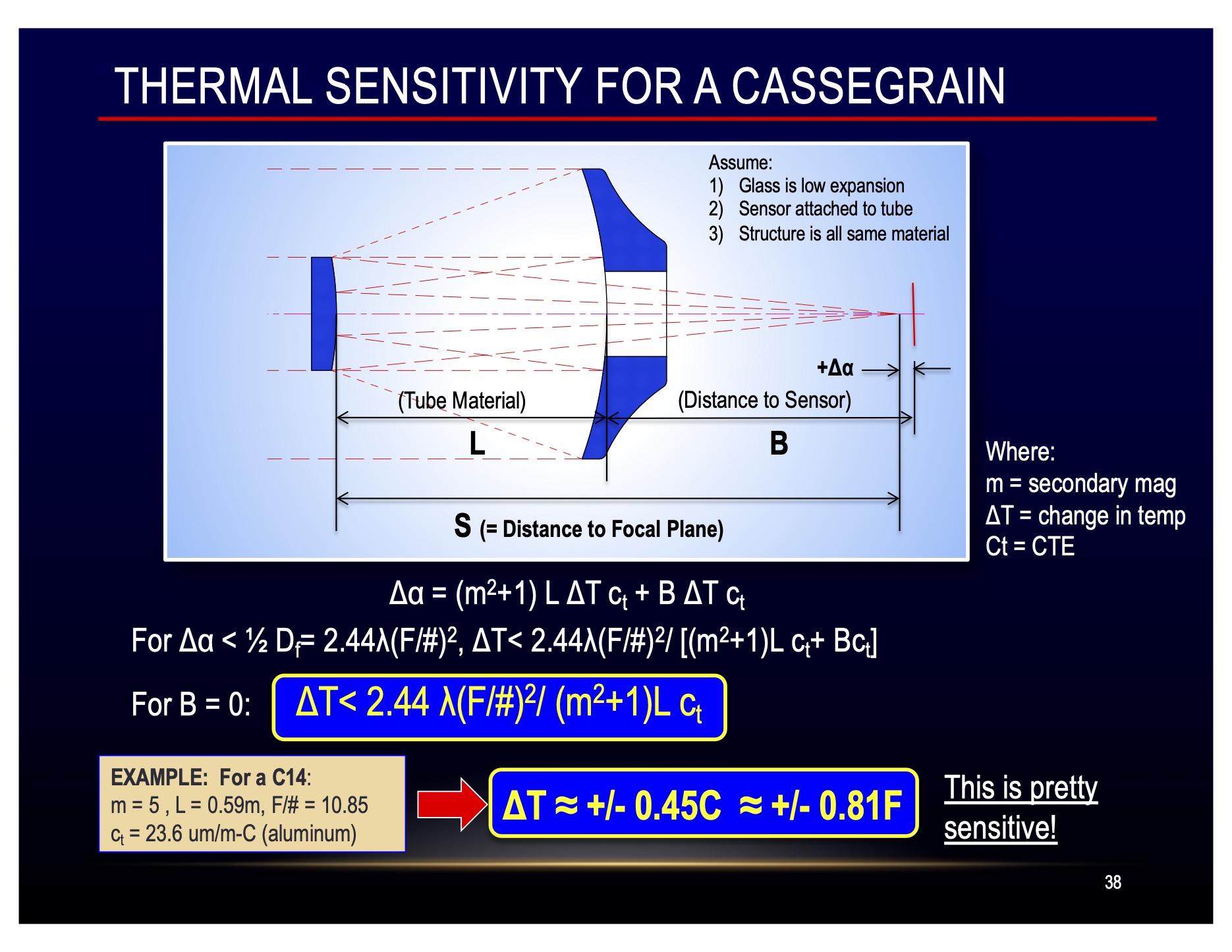

Agreed.  That will work well if you have sufficient back working distance.  However, an external focuser won't work with an ONAG because it eats up too much of the 5.75" available from the rear of the baffle nut to the focal plane.

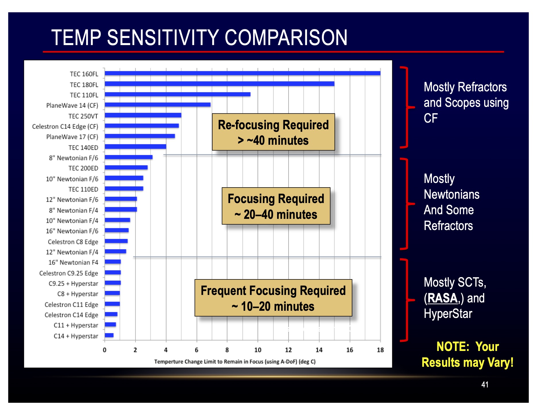

Again, the challenge with the C14 telescopes is their sensitivity to thermal variations. The charts below explain the problem and show that the C14 is among the most sensitive telescopes to temperature changes.   Note that the smaller the delta-T value, the more sensitive the telescope is to temperature changes.  None of this matters if your environment is very stable but there aren't many locations that are stable to within a half degree C over long periods of time and it's possible to see a 0.5C in 3-10 minutes under many common conditions.  That's why I have never been a fan of OAG with the C14.  ONAG permits real time focusing but it also requires a precision focuser that takes up zero back focus like the SMFS system.

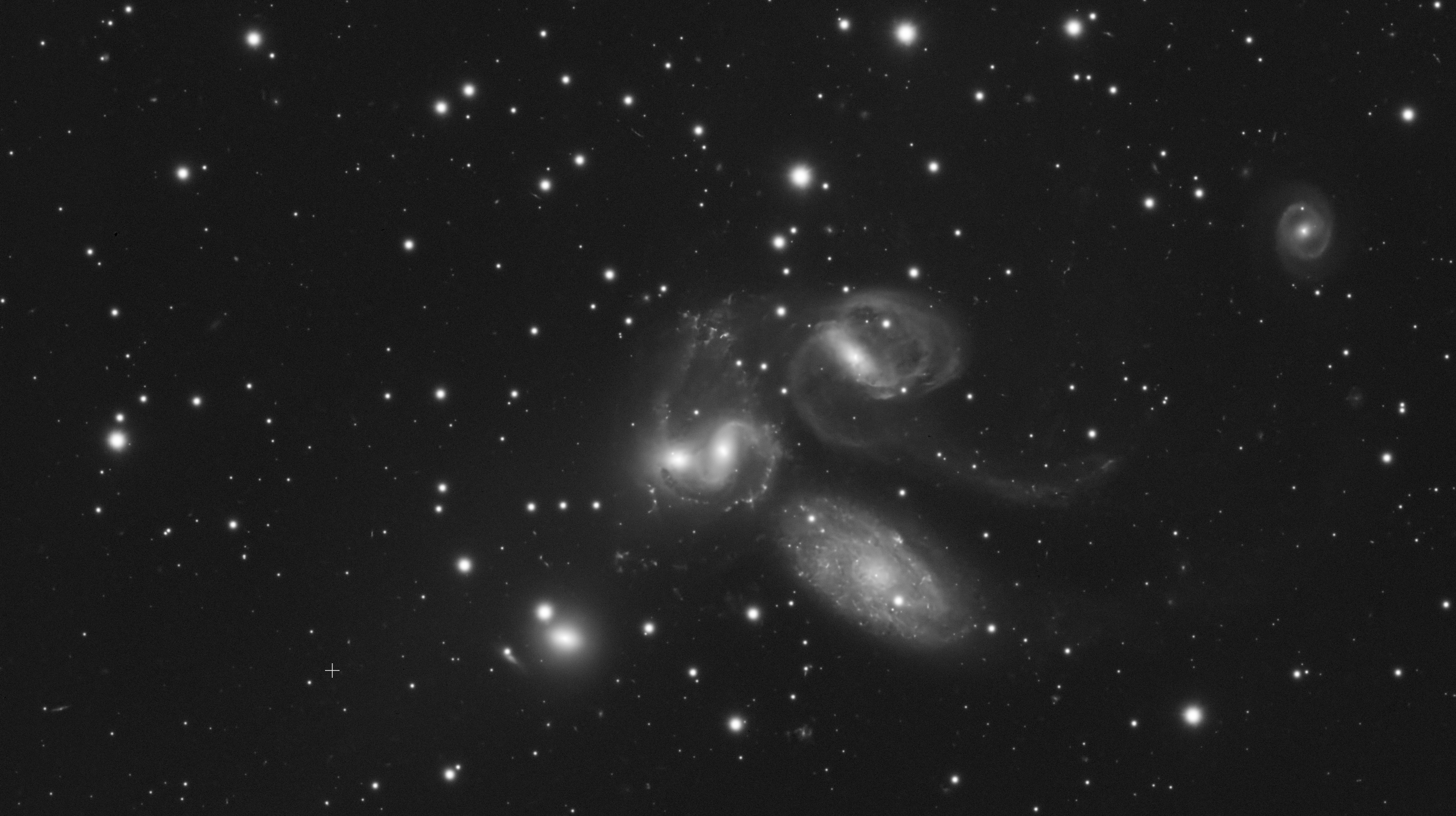

John. I got my tube made custom. Also, you need flexure connections with the dovetail plates.

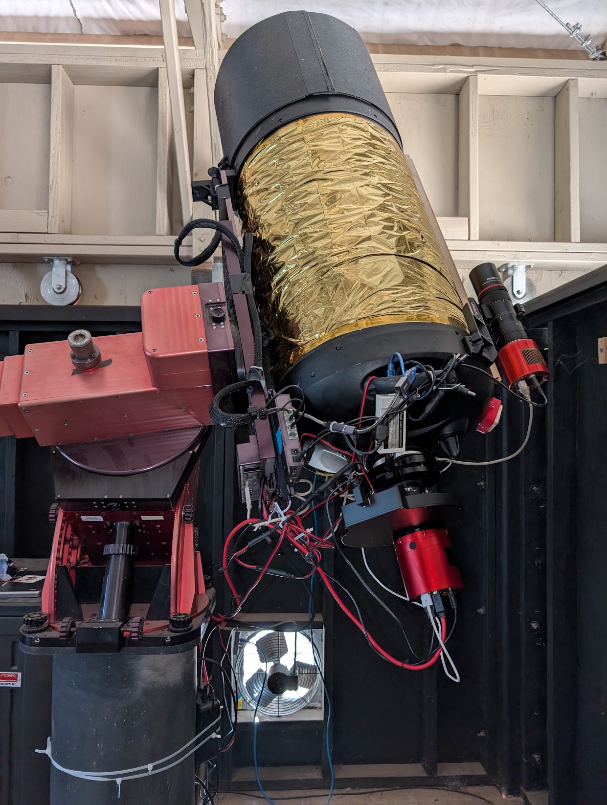

A few more things... I did a number of experiments with cooling fans, the stock C14 doesn't have fan (maybe it changed) and pushing air thru the vents certainly helps getting to an ok thermal state. I use to have an open tube C14, this was a success... I may go back there sometimes with the edge.
Here is a photo of the extreme c14 :-)   c14_1.jpg
