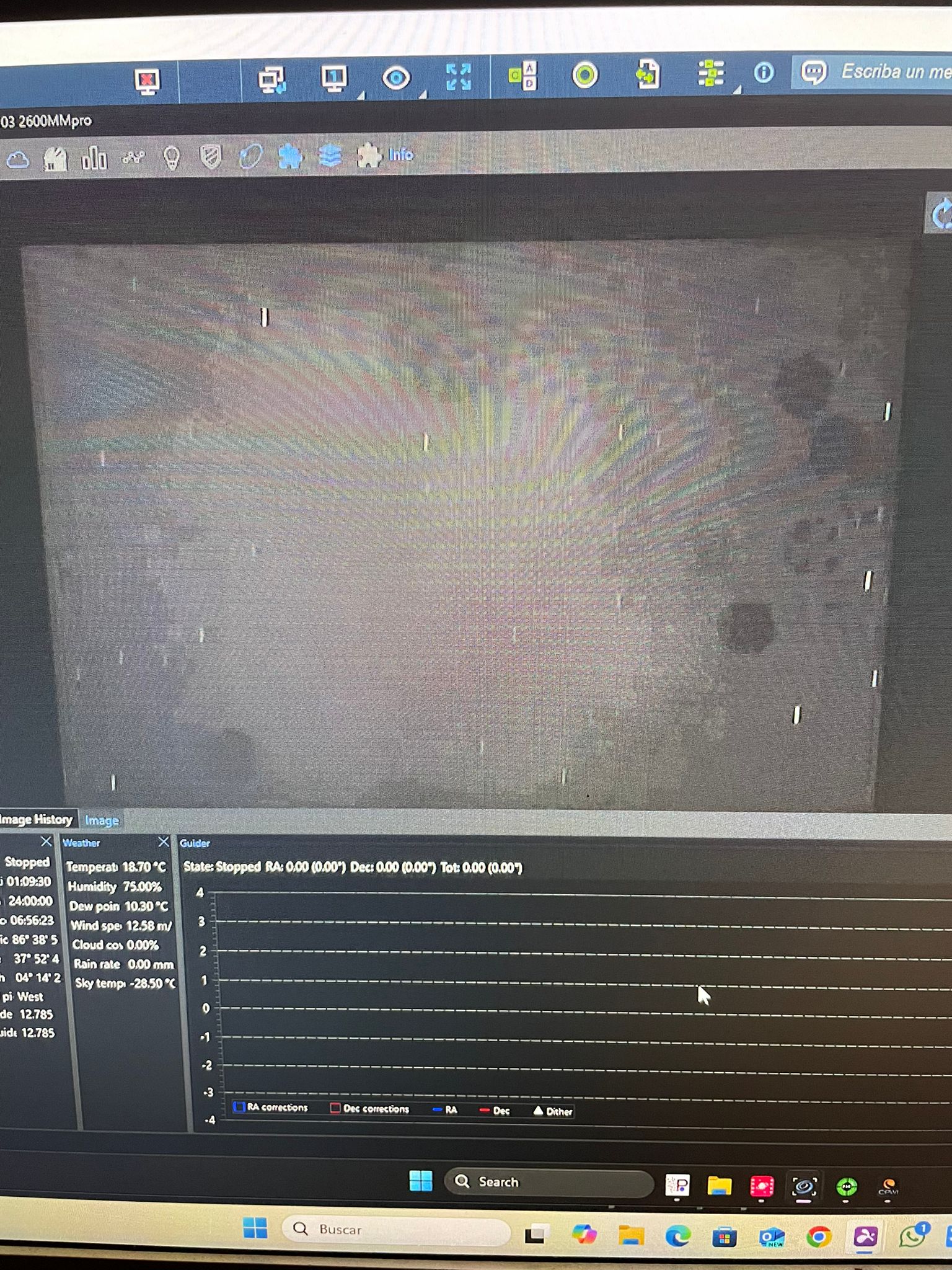

Hi, I recently bought a CGX-L for my remote setup and we are struggling to set it up, here are a summary of the setup and issue :
mount is levelled and setup is balanced on it … the mount is installed on a pier, the setup on it is an askar 103APO, so nothing that exceed the payload. I connect CPWI to the mountSetup in nina is via the ascom device Hub I can slew the mount , home it and park it from NINA. While doing the TPA in NINA, first each time I got a report of a large angle, and while checking the pitures of 4sec exposures you can clearly see the drift, it is like the mount is not having sideral tracking. I tried to also shoot 4sec and 10sec exposures, while having the sideral tracking and it is the same thing, stars are clearly drifting (like a line ) I tried also to slew the mount to a target to see if the dec and RA where going to the right direction and it does go to the target direction and nearly get it (obviously near it as I didn't aligned the mount) Any ideas ?

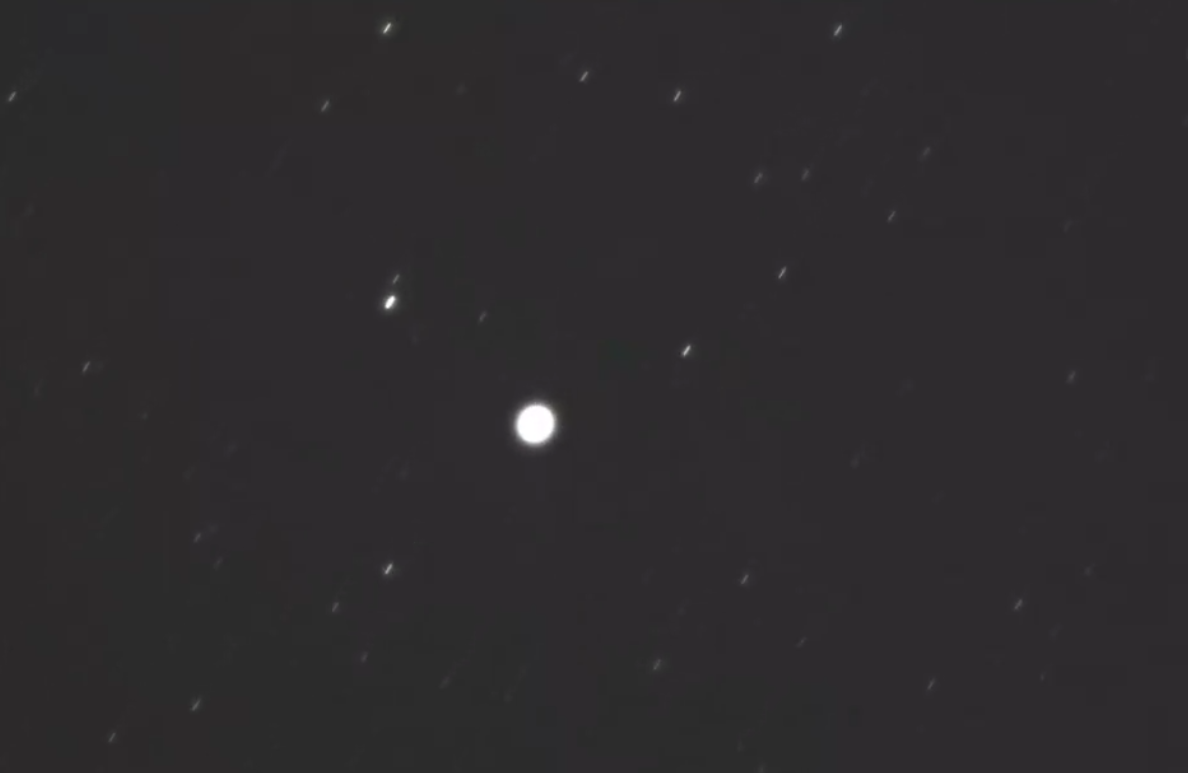

My issue is not so much during the GOTO, when the mount track, on a 5sec exposure, the stars are really elongated, and you can see the field of view rotating.

Found the issue, in CPWI the autoguider rates were at 85 …. I put fboth axis at 0, and now it is tracking properly, thanks for the help, wasn't easy to find the issues

The problem I have is that when I put some rate in autoguider rateabove 5% , and no autoguider connected to the ST4 or PHD2 running, then the tracking driftand I got the issue like in the photo I posted. The issue with that is that PHD2 can't calibrate properly as the guiding rate is low

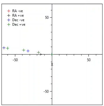

Re opening this thread as the mount after changing control board and DEC motors is still not tracking …. I had one night of imaging and then the next day problems came again.
if tracking is able or disabled here is what I got …
anyone have an idea ?
