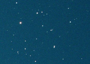

C11 Unexpected Diffraction Spikes Celestron C11 SC XLT · Jeramie · ... · 29 · 564 · 4

In the second image the spikes affect stars consistently across the field - that’s only possible if the cause is at the aperture stop or inside the OTA.
The second aspect is that the spikes are not symmetric - they are one-sided - which points to refraction, not diffraction - as the cause.
Hence 10:1 it’s due to a thermal plume inside the OTA.

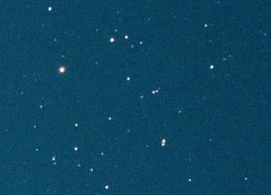

Mystery solved!
I cranked the dew heater down to 20%, ran an hour's worth of subs, no more spikes!
Many thanks to everyone for the help and conversation on this one.
