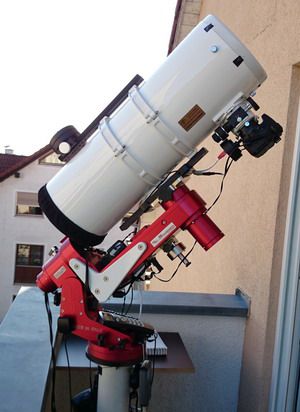

Let me express the size limitations with an image. Thats the setup from Alexanders Reinders from the Avalon User Gallery. As you can see the telescope can hit the RA axis flange if it gets too long. But you also have to balance it, so if the setup is too front heavy and too long it will not achieve balance ever.
I see Alexanders even had to deploy some counterweights on the telescope itself, but I am missing more information on the setup. He is also using a DSLR only, so if I would deploy my mono setup the scope would be even heavier on the front.

*Thanks, I am using a 50mm spacer for my RC10 already, because with the Touptek AFW L it gets too tight for my taste. To have the tube above the RA axis flange I would need many more spacers, but then I would get problems with the balance.
I would prefer knowing if balance can be achieved without spacers at first, this would assure me that I have enough headroom.
