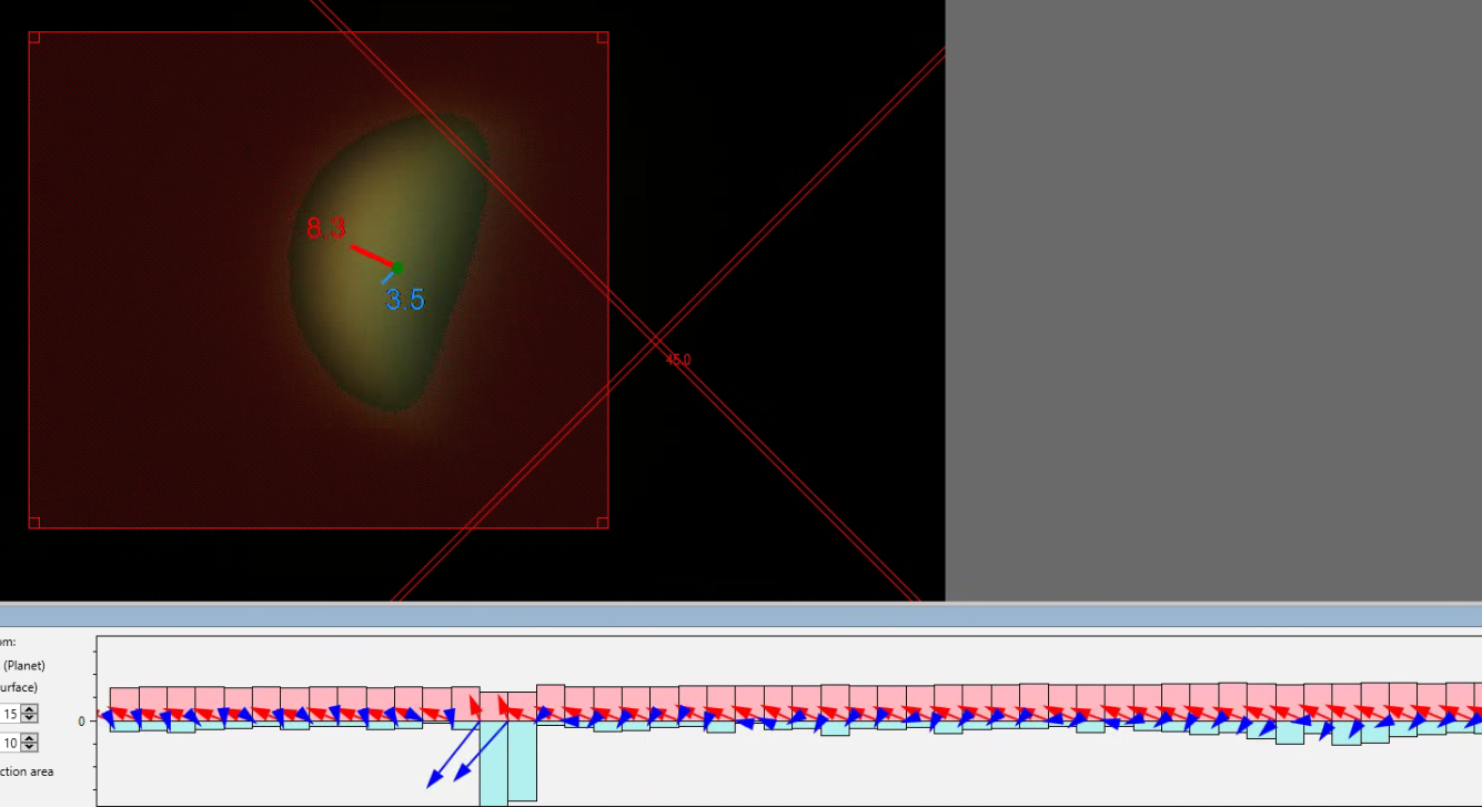

I was recommended in purchasing an ADC for my planetary photography to help with some of the green/red edges around planets due to the atmosphere. After purchasing one though, my mind is just melted away with confusion on how this thing's supposed to be tweaked. I've watched a dozen videos on people adjusting their ADCs, but am still kind of lost on what I'm missing here after many continuous sessions in trying to optimize this thing. I use Sharpcap for my planetary photography and using its ADC alignment tool just confuses me on how to read it, even after reading their docs, so was hoping to find some assistance.
I've got the ZWO ADC for context. I've lined up the bubble so that it's "level" and then adjust both the knobs at equal distances... But nothing seems to "change" in the coloring of the ADC alignment tool. Here's an example screenshot of me attempting to use it against Venus:
I guess my confusion is: How do I read this and adjust? Regardless of how I move the knobs around, it seems the red is always a larger number than blue... and there's always a heavy green element to one side of the image (as seen above)... Should the numbers be larger, smaller, the same, unequal...? I always assumed smaller + close to equal, but maybe that's where I'm making mistakes. And How do I read the graph on the bottom (Docs don't explain what the arrows mean nor how to make them 'equal', assuming that's the goal)... Basically regardless of how I move the knobs/balance/etc. around on this ADC, I feel like the object moves around significantly, but the colors are always the exact same, or at least very close to it.
So yeah any context or help in understanding how to read this and how to properly adjust an ADC through Sharpcap would be really appreciated...

Use FireCapture. Alternatively increase saturation (a lot) and minimize color fringing acting on the levers. I am assuming that you know how an ADC works, right?
Are you using a UV/IR cut filter? What optical system are you using? I would guess that if your system isn't perfectly apochromatic the ADC won't correct for that.
After re-reading your OP it may seem that you got confused info about the general working of an ADC, especially the ZWO's one. The bubble level shan't be used in most cases as a way to set up the ADC. The neutral position (opposite levers joined) should be level with the horizon in all instances and at all times. This is especially true and diffcult to get right in practice if you use a newtonian.  One point of matter though… You really need an ADC if you are imaging below 50 degrees in altitude, above it you might not need it and even more so  at the focaal length of your telescope.

Nope, no filters in between. Using a Newtonian, with the Televue 5x (so imaging at 5000mm)
After re-reading your OP it may seem that you got confused info about the general working of an ADC, especially the ZWO's one. The bubble level shan't be used in most cases as a way to set up the ADC. The neutral position (opposite levers joined) should be level with the horizon in all instances and at all times. This is especially true and diffcult to get right in practice if you use a newtonian.  One point of matter though... You really need an ADC if you are imaging below 50 degrees in altitude, above it you might not need it and even more so  at the focaal length of your telescope.
If this is the case, I think you helped me get some lead onto the problem - I have a newtonian. All the videos I've watched don't use one and the "level it with the horizon" never made sense to me, and this would definitely explain why. Maybe I need to find a guide in regard on how to setup an ADC properly using a newtonian since leveling with the horizon isn't something that I just do. This is where I thoughut the level was supposed to help support with - level it with 'netural' on the two bars and the rotate the train to get it level so it's "level with the horizon". Definition of level is probably being used in two different ways here, though.
It also makes me now wonder that if the target's in specific areas of the night sky, it'd explain why the shifting of the two prisms doesn't make a difference in some cases? When shifting both and seeing zero shifts in red/blue (in the image I pasted), I'm wondering if it could be related to that - just spit balling here.
