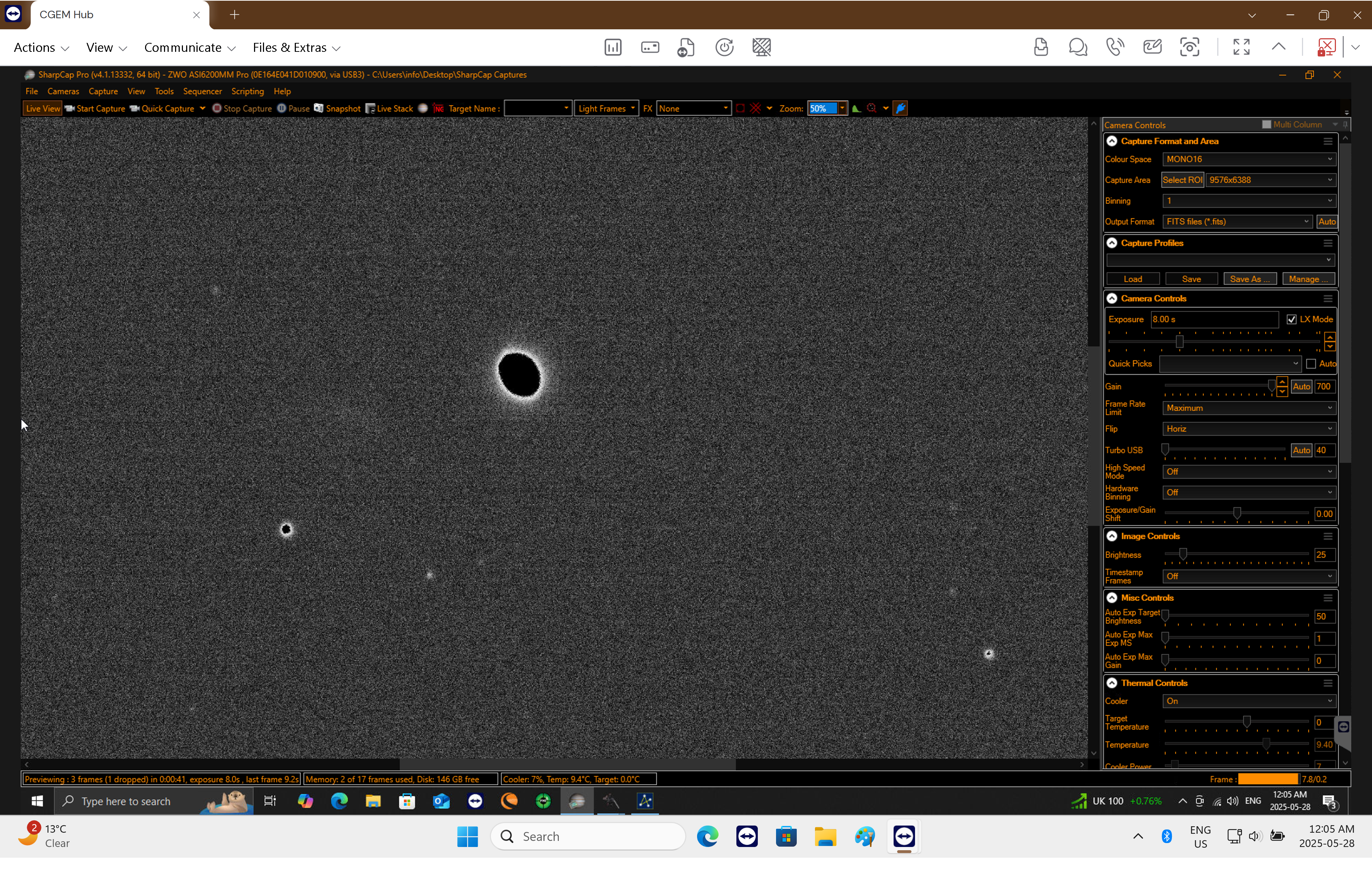

I applied the latest Sharpcap update and suddenly all of the preview image stars and objects have giant holes in them! They kind of appear like out of focus stars on an SCT (screen shot of the Cat's Eye nebula core below) - I checked for (and installed) the latest ASI driver update (I'm using the ASI6200) and I checked right away with ASI Studio and the display there is fine - the acquired images (in ASI and SharpCap) are fine too. Can't seem to find a feedback channel in Sharpcap without singing up for an account. Just want to make sure that I'm not the only one with this issue!

Hi, it looks like they are being clipped because they are too bright. Are there any settings for adjusting the brightness of this Sharpcap window?
Could you also measure the ADU levels of these dark spots?

You have the camera set to maximum gain. When you do that the dynamic range goes down to almost nothing. Try backing that off and see if the clipping goes away.
AstroRBA 4.98
Thanks to all for the suggestions; I don't think it's clipping or gain as it's exactly as I have always set it for plate solving and focus etc. in the prior versions. As I said, the aquired frames are fine so it's not really causing an issue other than appearing very strange looking … (and also ASI Studio displayed it properly at the same settings)

There is a check box in sharp cap labeled mask bright pixels.
alpheratz06 0.00
Definitely clipping or masking of high lights  pixels
Yes! Many thanks! That was it - not sure how it got turned on' maybe it's a new default for the update?
