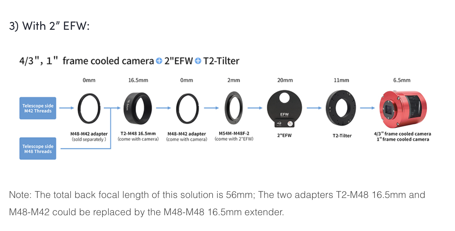

I have been looking at the Askar M54 OAG but I come to a back focus distance of 57mm.  My current setup is below (from camera to telescope). I am curious to find out how people have solved this.  Thanks!
ASI294MC Pro (6.5mm)
T2-tilter (11mm)
ZWO-EFW 2"x7 (20mm)
M54M-M48F (2mm)
T2-M48 (16.5mm)
jmdl101 1.81
I think about the best way to solve it is by getting the matching filter drawer, or a matching OAG for your filter wheel. When I switched to a filter wheel, I bought a matching OAG for it and ditched the Askar OAG unfortunately.

if you subtract 1/3rd of the camera window and filter thickness from your backfocus, you'll probably find out you have something close to 55mm, I'm guessing 55.8
but now that I'm thinking of it, I'm not exactly sure if you're supposed to add or subtract smile, either way, I know it is 1/3rd of thickness for every piece of glass that light travels through
someone else will have to confirm

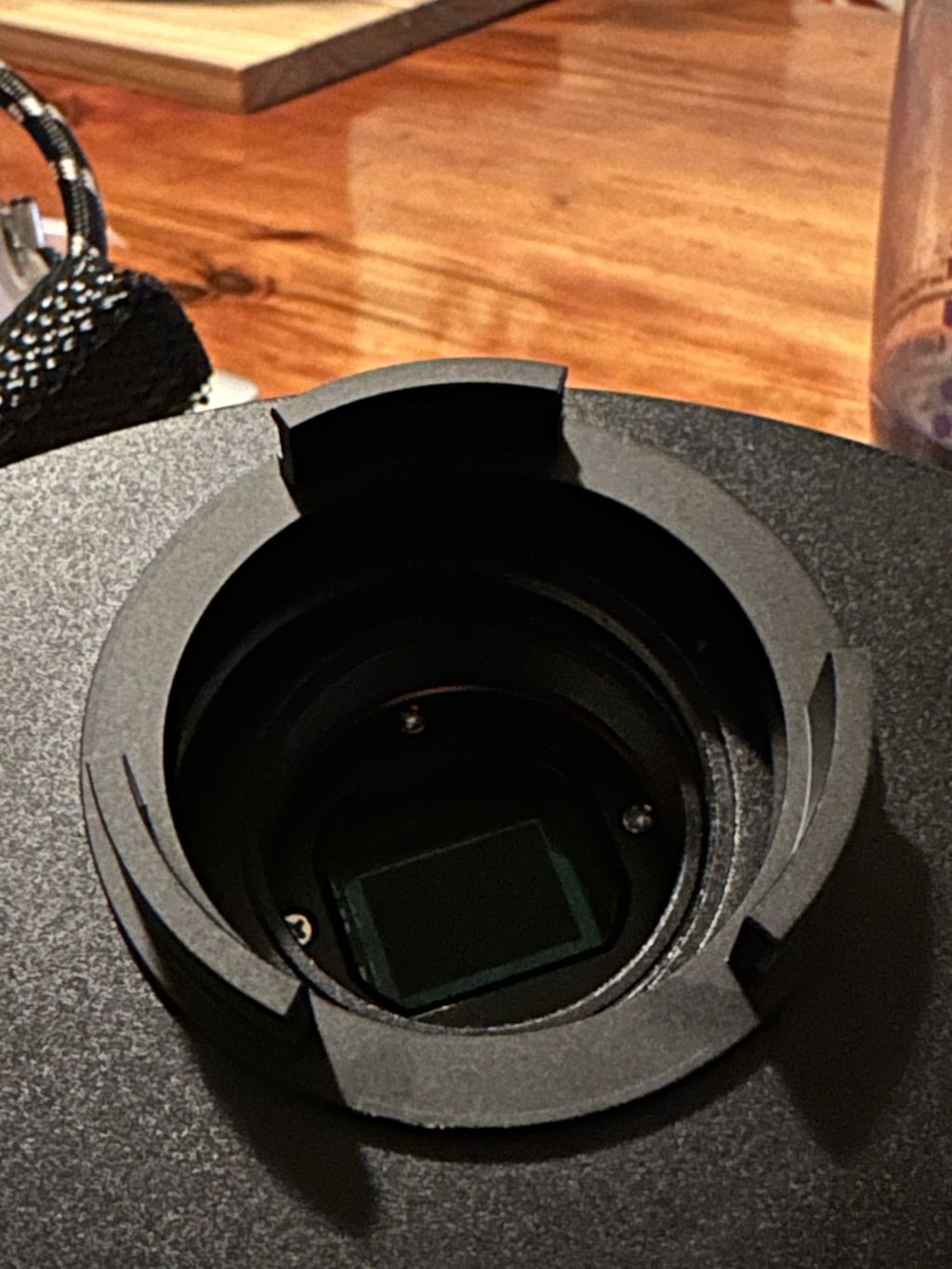

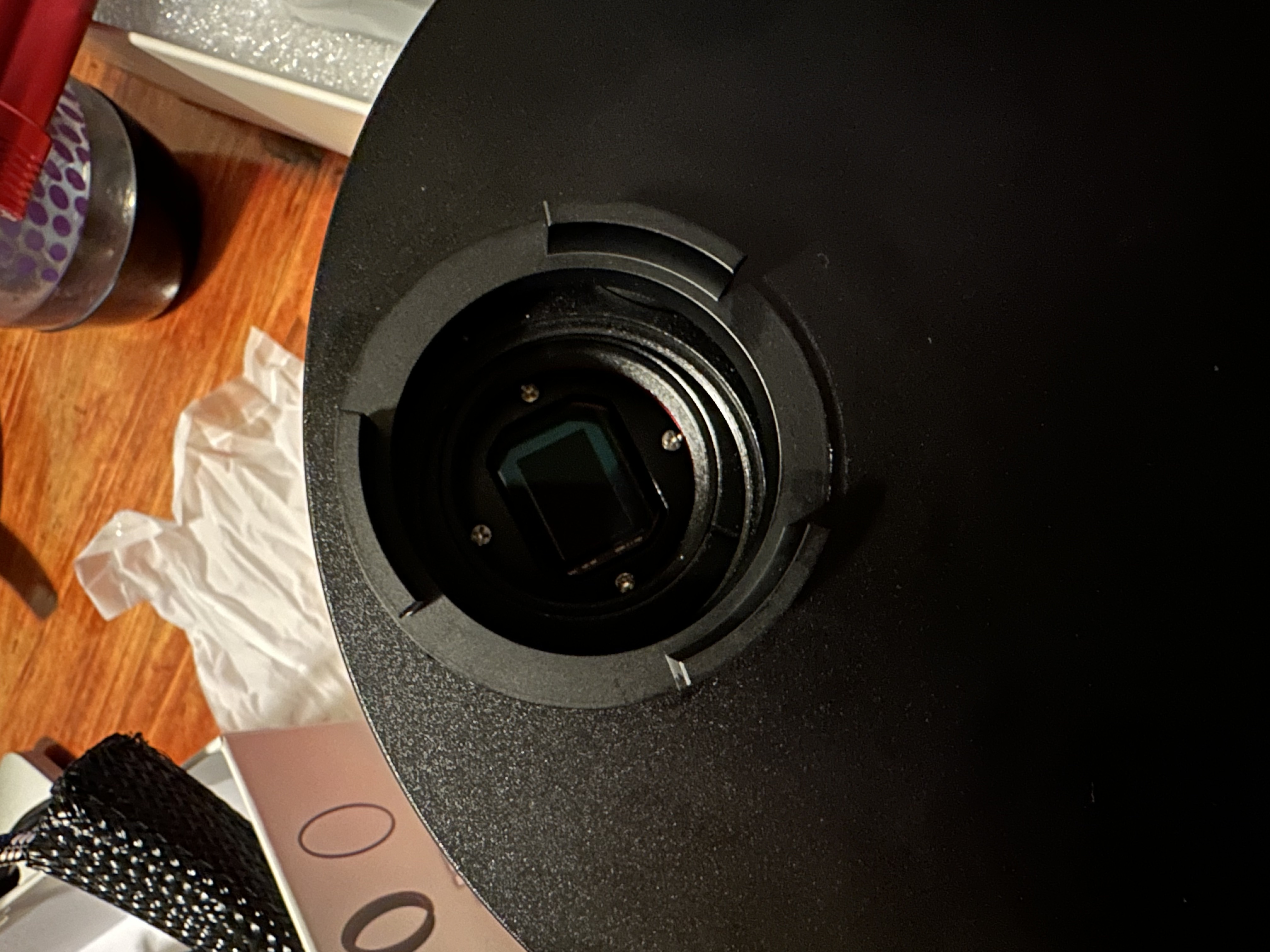

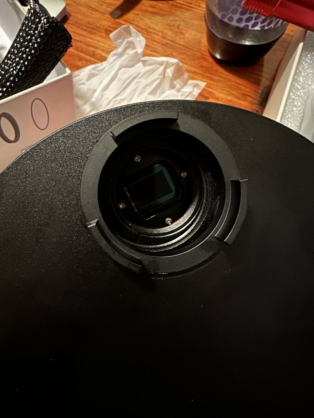

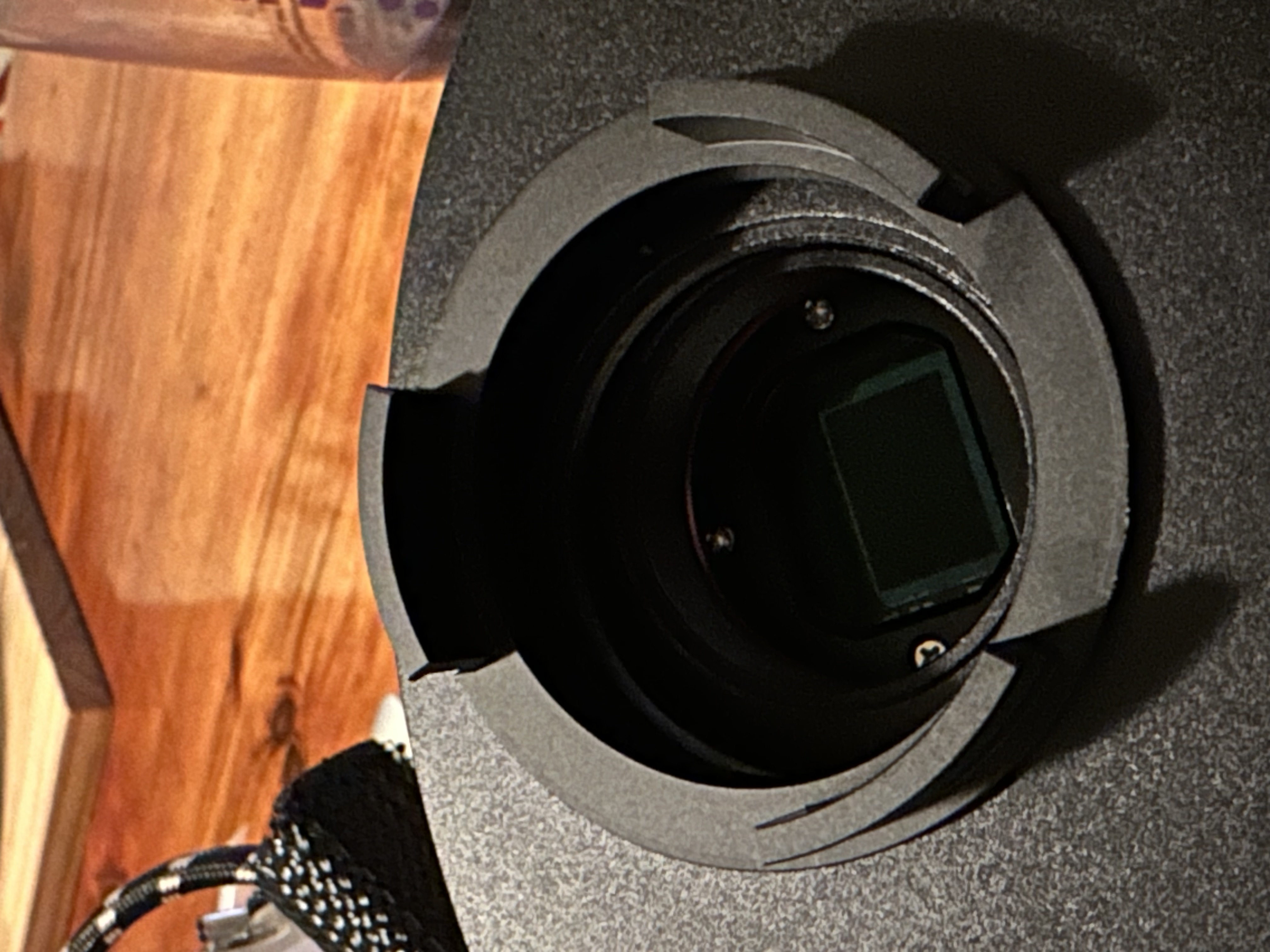

But maybe a stupid question, I am mounting the OAG on my ZWO EFW 7x2".  The mount that goes on the camera side, then goes on the EFW and has these three lips to position the OAG with respect to the camera sensor. But for some reason, the lip is positioned at the side closest to the free space... This prevents me from attaching the OAG because there is no spacers between the OAG and the EFW. Anyone an idea how to solve this?
Sorry for the poor description, maybe the photos might explain the position of the screw-on mount.  Thanks!

same happened with me
I cut a spacer ring out of aluminum foil (the foil was folded into about 4 layers before cutting into a spacer) and put one between the EFW and the 3 lip adapter that you show in the photo
it was just enough for me to have the 3 lip adapter rotated slightly in one direction, so I could then use the OAG

Oscar:
Did yours end up at the same place? On the photo, the connector was not tightened yet, just at the end of the thread.  Think it will move a few more mm when tightened. This makes me wonder how much spacers I need to add to position the OAG prism away from the sensor, messing up the 55mm back focus completely...
It really looked like a brilliant setup that the Askar OAG has and being flexible with lining out on the camera sensor, but this is just useless... Very disappointed with this.  I am still hoping I am doing something completely wrong!

well, yes I think so, but I tried tightening it as much as possible, and obviously, it still wasn't enough, since I had to resort to cutting out an aluminum spacer
it's easy, just use one sheet of foil, then two, then three, etc, until you have the correct position
I just think the Askar OAG was made to be used with the Askar filter drawer more than with any other configuration, but that doesn't mean it can't be used with an EFW - I did it, and I had a tilt plate, and I got good stars
