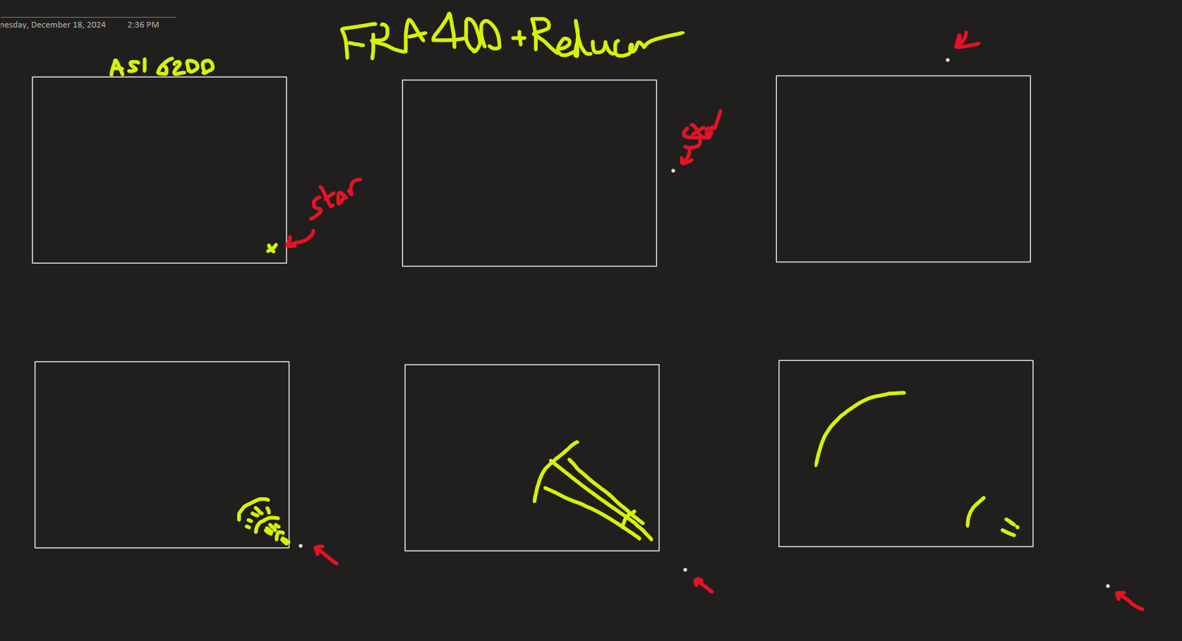

Martin, you can check my pictures, but I paired the same scope (still own it) with full frame camera and its one of the bests I have had. If you use the reducer, it will be fast and you all-in-one camera wont have any issue finding stars to guide. Also, having sharp stars all the way to the edge of full frame means you will have a round stars for guiding.
Just be aware of some strange reflections with the scope. I have the same experience with all my Askar scopes (askar fra300, 400 and 130PHQ). When you have relatively bright star our side the frame but close enough, it will cast a cone toward the center of frame. It gets bigger and bigger toward the center of frame.
So, it limits your framing and objects you can have as target.

Farshadio 0.00
@Terry Doran  for me it was like below. Specially, it was different for different colors (filters). So, I assume you are correct, its a reflection from near edge star.
TerryD 0.90
I don’t see any stars bright enough in that area to cause it though.  Maybe it’s a matter of a star being precisely enough placed and it doesn’t have to be all that bright.  I have quite a few images with this scope and this is the first time seeing this.  I haven’t seen it with the 120APO.
