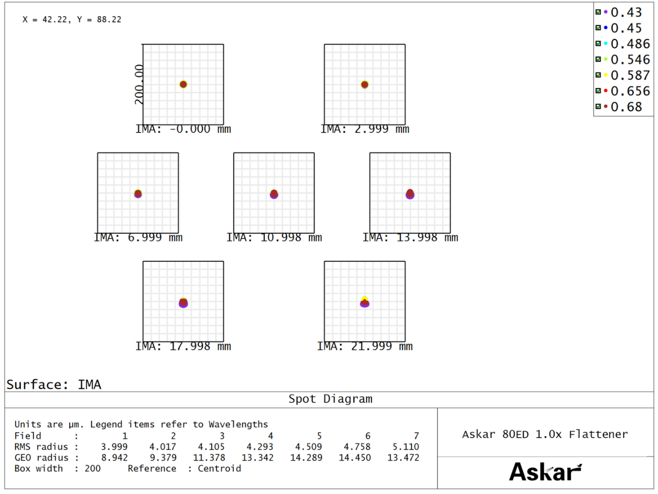

80 mm, F7, 4 microns spots on axis, 5 micron spot full-frame  - $399 !!!  (Flattener an additional $189) - Total:  $587

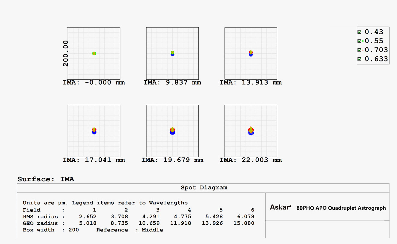

Now compare it with this:
80 mm, 2.6 micron spots on axis, 6 micron spots full-frame F7.5 - $1300

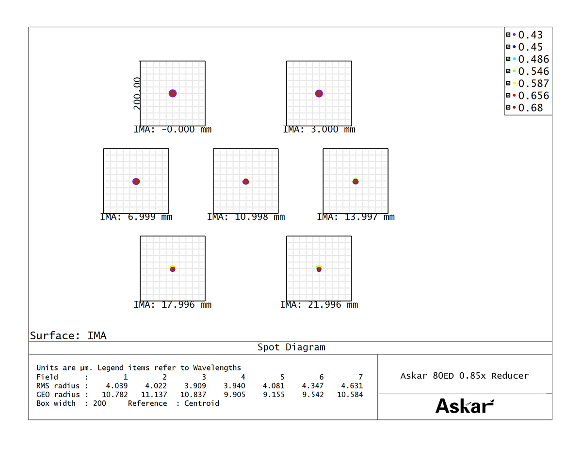

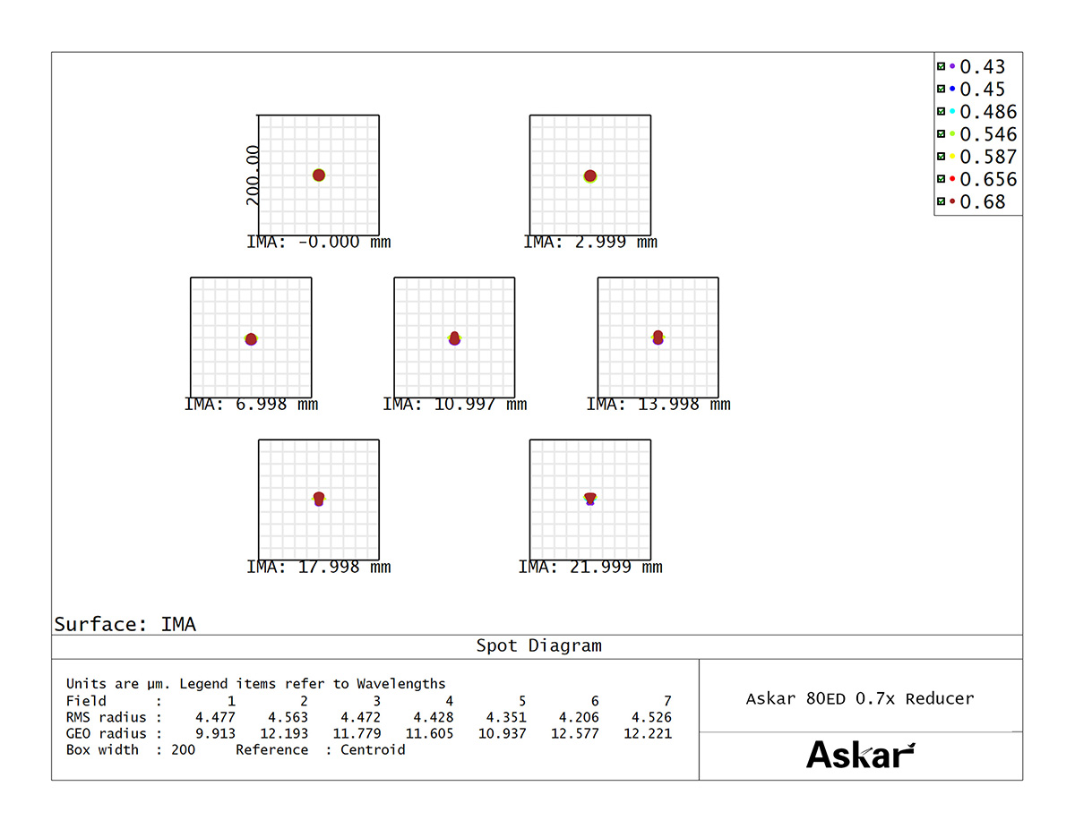

I think you also need to look at the spot diagrams with the various reducers too:
The 0.7x looks like it'll be a struggle with even a crop sensor? Although the 0.85x looks much nicer by comparison, they both show strong evidence of chromatic aberration (as would be expected for a doublet).
