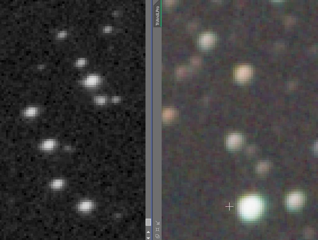

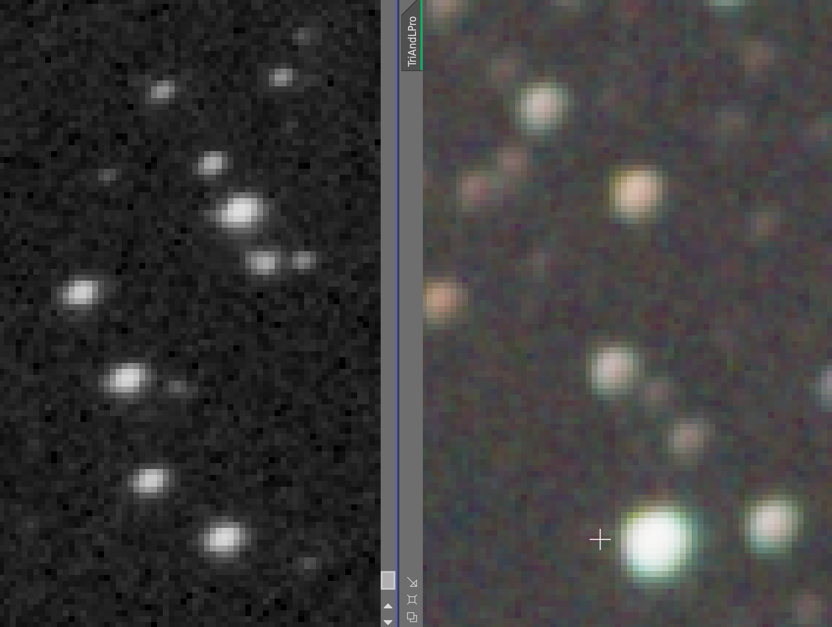

I have both FRA300 and 65PHQ(and reducer), compared at full frame edge. x6 magnification.
You can see fat star on 65PHQ.
Quality : FRA300 >> 65PHQ
Versatility : 65PHQ (312mm and 416mm) > FRA300
Price : almost same
Price : almost same
<- 6200MM  6200MC ->
***Thanks! Is that with  a reducer for the 65PHQ? or is this image without?  ***
tjm8874 3.67
Coolhandjo:
With reducer.
in this case I took Ha+L on FRA300, RGB on 65PHQ+Reducer (so final quality follows FRA300).
