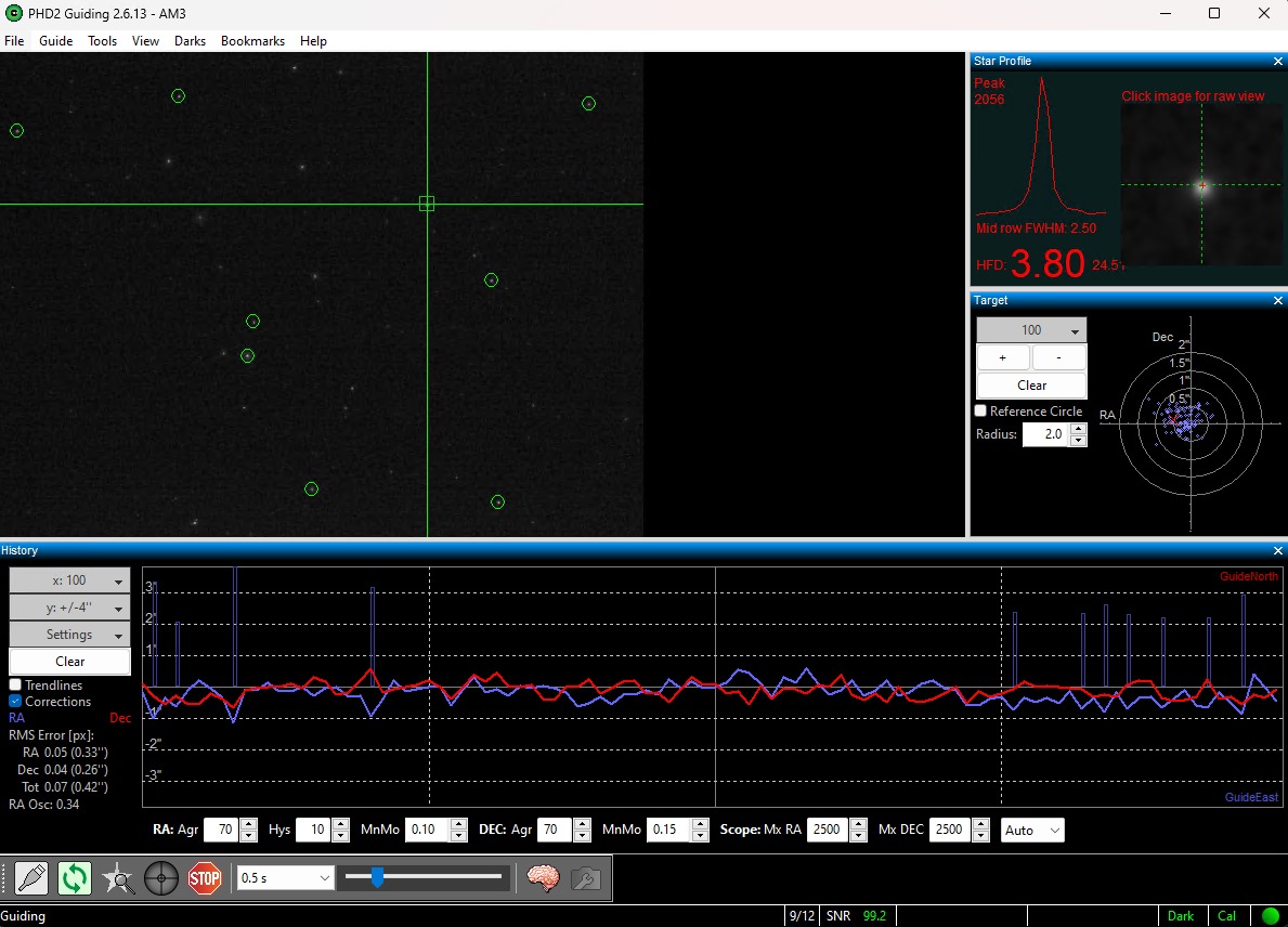

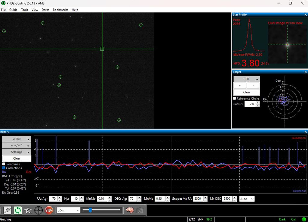

My 0.2 cents:
I'm currently using the cheapest autoguiding system I could find: the Svbony 30mm f/4 scope + SV905 camera combo (u$130 for the whole kit). The camera isn't even monochrome, as recommended everywhere. Paired with an AM3 and PHD2, I'm getting typical RMS error of under 0.7" with good streaks of 0.4"-ish and bumps of up to 1.1" in windy conditions:
I feel that these guiding figures would be more than enough for any system that could ride on top of the AM3.
