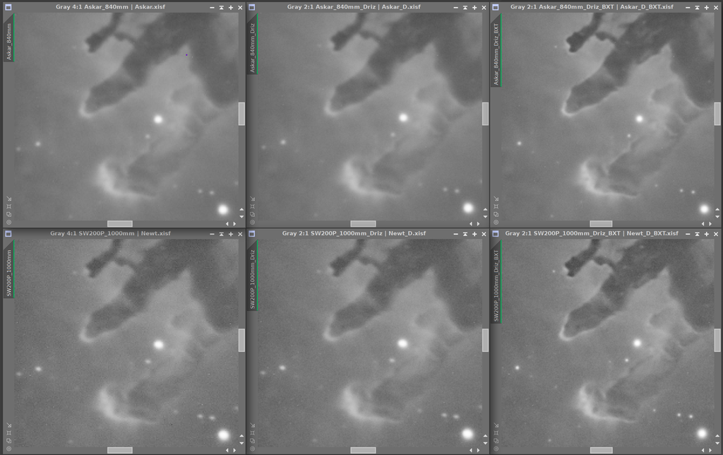

Googong_Observatory 1.20
Hi Niels,
Definitely prefer the Askar 120 over the SW 200P. The SW 200P is more susceptible to poor guiding if my balance is off or I have a slight breeze.
Below is a comparison between the two scopes. Both are 60mins of Ha:
  • SW200P = 12 x 300sec,
  • Askar 120 = 10 x 360sec.
From left-to-right there is:
  1. The raw image,
  2. 2x drizzle, and
  3. 2x drizzle with BlurXTerminator.
IMO the SW200P provides better resolution and contrast, which it should at F5 Vs F7 and 1000mm Vs 840mm focal length. However for the ease of use and consistent performance, I'd choose the Askar 120.
Regards,
Adam
Niels_L 2.39
Adam Cox:
Thanks Adam!  Those photos are very helpful!
Indeed there is the difference in resolution but I do agree that the ease of use will play a big role for me, as still a newbie in the field.  I probably won't get the same quality out of a reflector (I already had trouble getting my 8SE SCT perfectly collimated...) as a refractor.

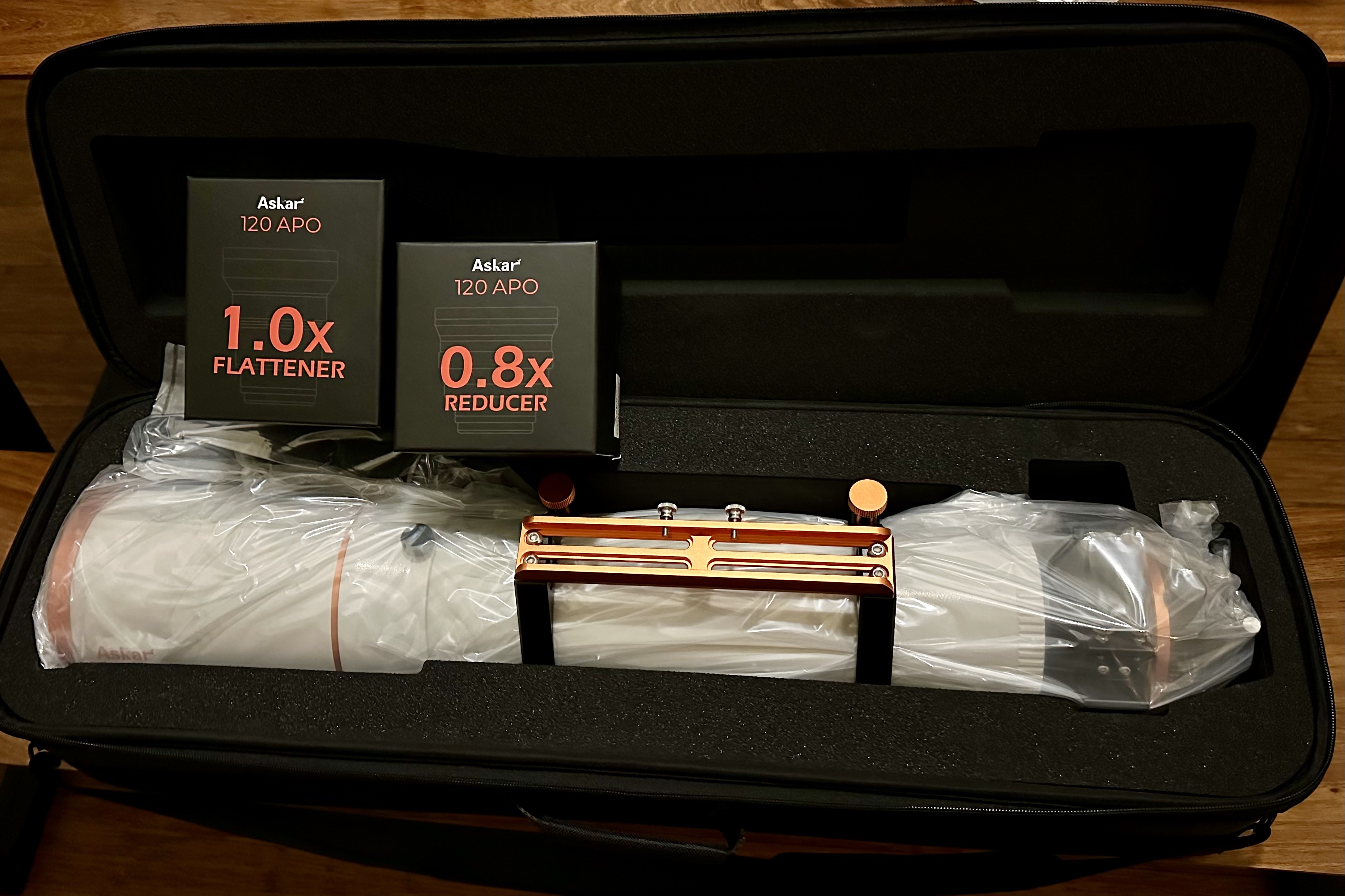

I decided to join the club and bite the bullet (bullet being my bank account )!  Below my 'unboxing photo'
Will have to wait till next weekend to get some clear skies but I am excited! It is a beast compared to my FRA300...  Does anymore use an extension pillar on the tripod or will it be fine without?  (I am using the AM5 with TC40)

Congrats! Look forward to hearing what you think about it!
I have a very similar FL/Aperture scope (Esprit 120ED) and the PE200 pier extension. The pier is pretty useful since the scopes are super long. It also depends on where you are imaging even with the pier extension you should still be careful where the tripod legs are and your meridian limits.
Clear Skies!
javaruck 6.45
I highly recommend that you get the PE200 pier extension. I have the 120 APO and it's a pretty long imaging train with my mono setup. Congratulations on the new scope, I've been very happy with mine.
dgalanaud 1.20
Congratulations !
I am sure you will have fun with it.
Definitely get the pier extension. If you image near the zenith, you will have a high risk of collision. Another very useful accessory is an electronic focuser: since the tube is so long, change in focus due to temperature related contraction during the night  are much more significant than with shorter tubes. The ZWO EAF is the most obvious solution. You can fix it very easily on the telescope, and if you dig the foam a little bit, it will still fit inside the carrying case.

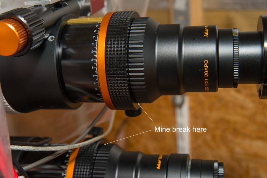

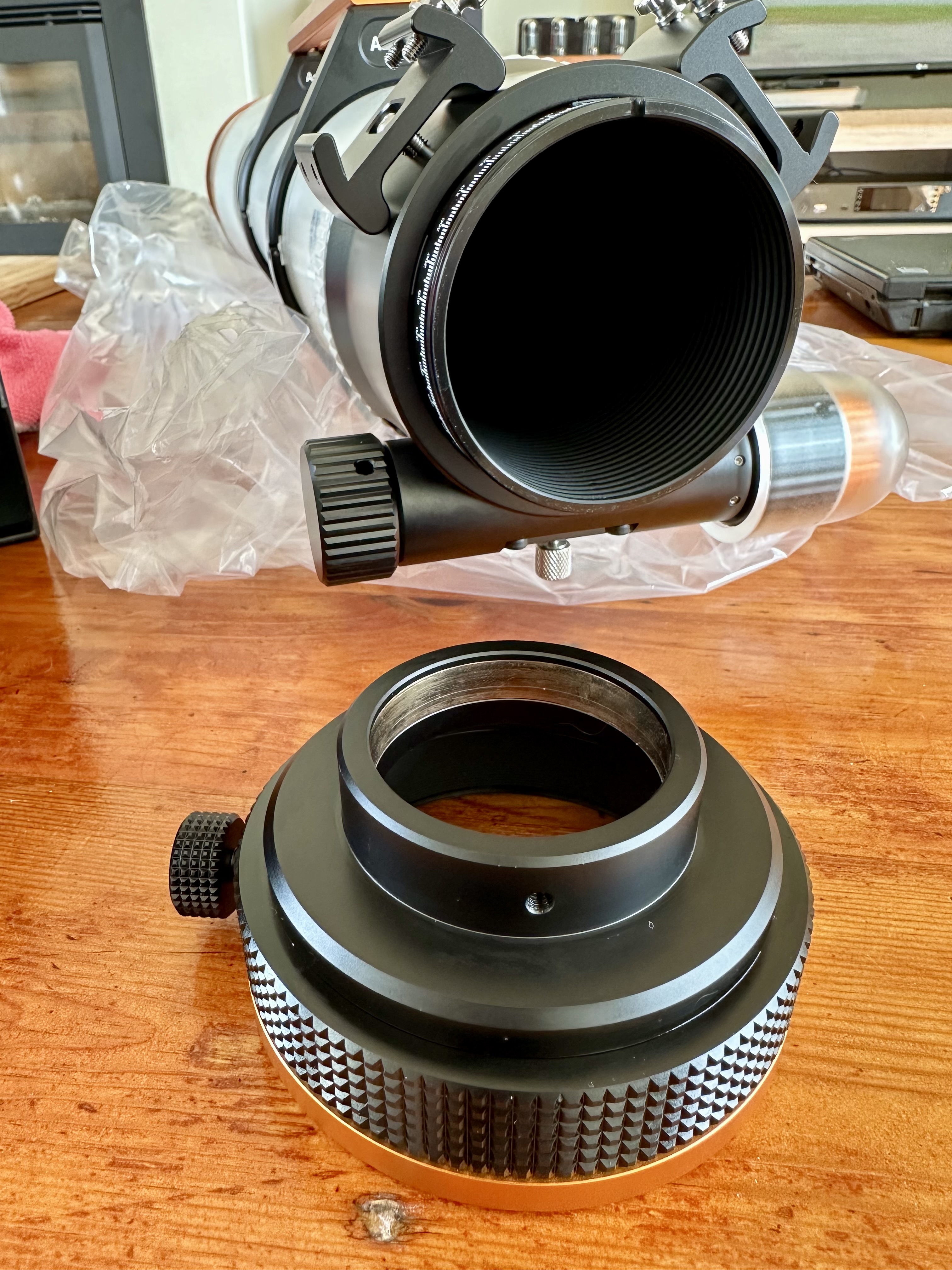

I tried to install the flatteren but it seems that the ring for eyepieces is completely stuck to the rotator ring… Anyone experienced this as well?
I read up on the “cold weld” thread but it looks like the rotator has some internal rings/tube/parts (or so) and don’t want to break it just yet😕
fwm891 0.00
AST_8822.jpgNiels,
Mine break the otherside of the rotator. The ALL threads were tight to start with but released OK.
Niels_L 2.39
Francis:
Hi Francis,
Thanks for the pics, helpful for confidence boost to put some more force on it... I had to go buy an oil filter removal clamp and had to put some oil in it... But finally managed to get it loose!
It might have gotten temperature fluctuations during transportation and got stuck. I was a bit afraid to damage the rotator before using  I was sweating hahaha
