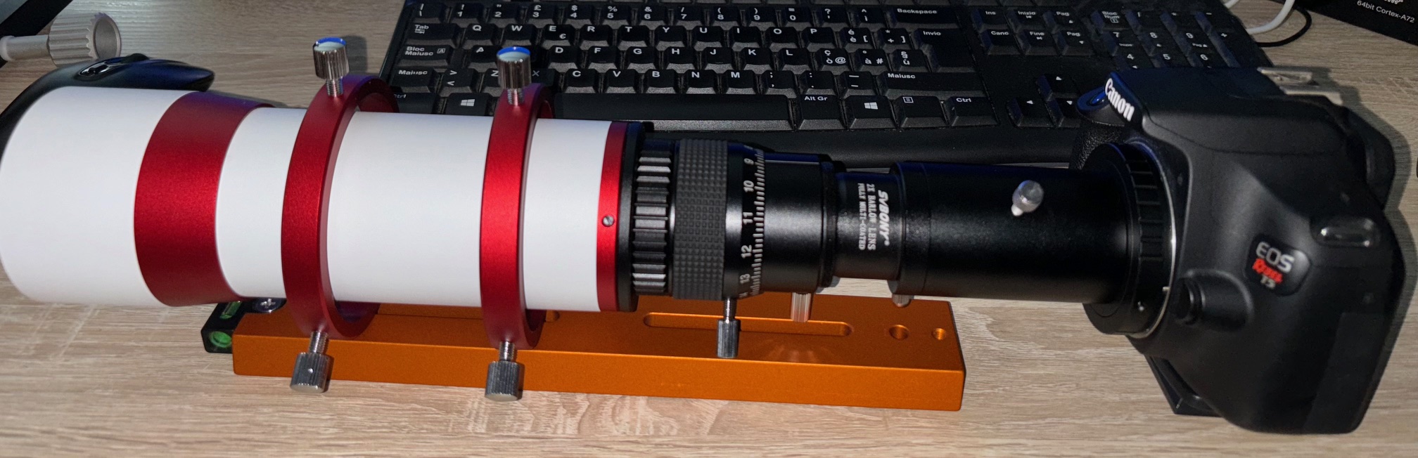

@D. Jung@andrea tasselli please see the setup that is working. Artesky 60 mkii + 2x barlow lens + canon adapter 1.25"+ canon Rebel T5.
I will try this night to take some raw pictures and see how well or bad is performing. IMG_0403.jpg
