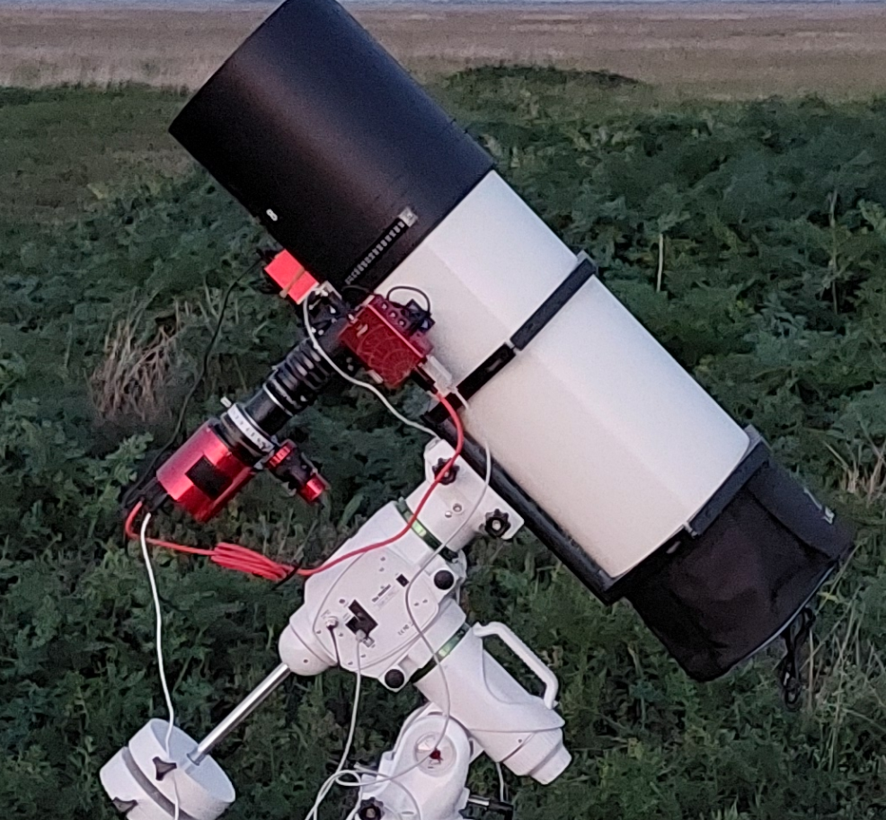

Hello . If anyone is using this Product . I need help ! APM 1.5x Barlow telecentric for Visual and astrophotography. I have the backfocus right....(i think) but cant see any stars or trees because i tried during daytime also . The focuser tuber went back and Forth trying to focus but Never saw anything . Just need help  |

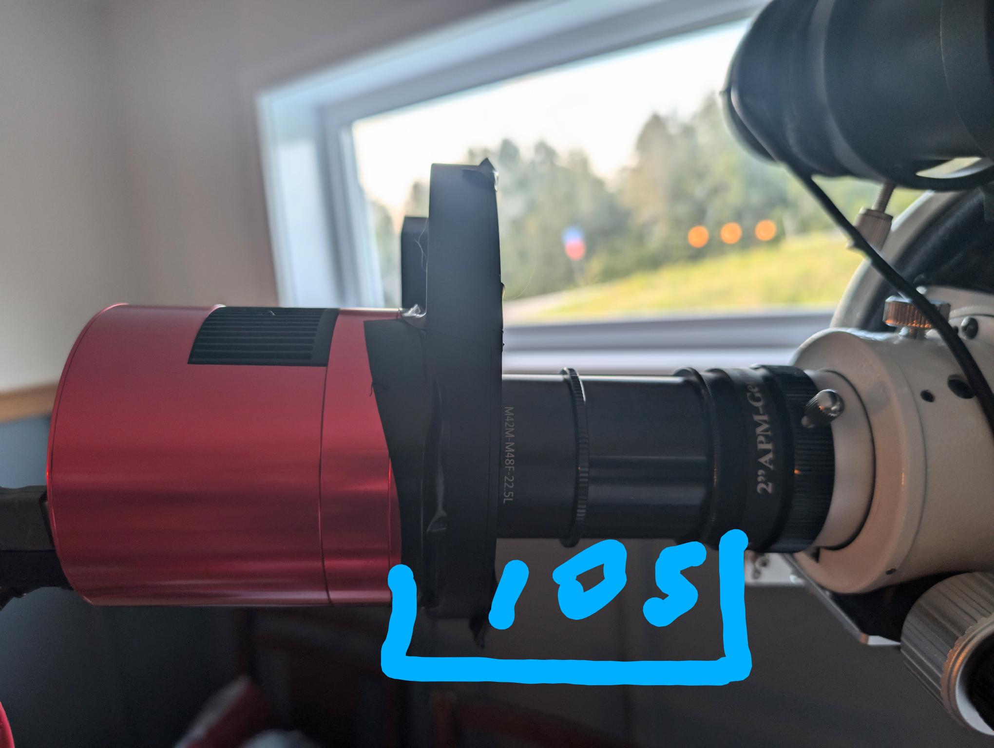

Ok …so i just had to Take the coma out by about 2 inches. Now …. it's a very long optical train so i Will have to add a screw to tight the coma well . To avoid flex. Thanks all  |
eric belanger: Ok ...so i just had to Take the coma out by about 2 inches. Now .... it's a very long optical train so i Will have to add a screw to tight the coma well . To avoid flex. Thanks all  does the 1.5x barlow have any 2" filter thread? if it does, you can try adding an M48 spacer to that so it's more secure in the focuser

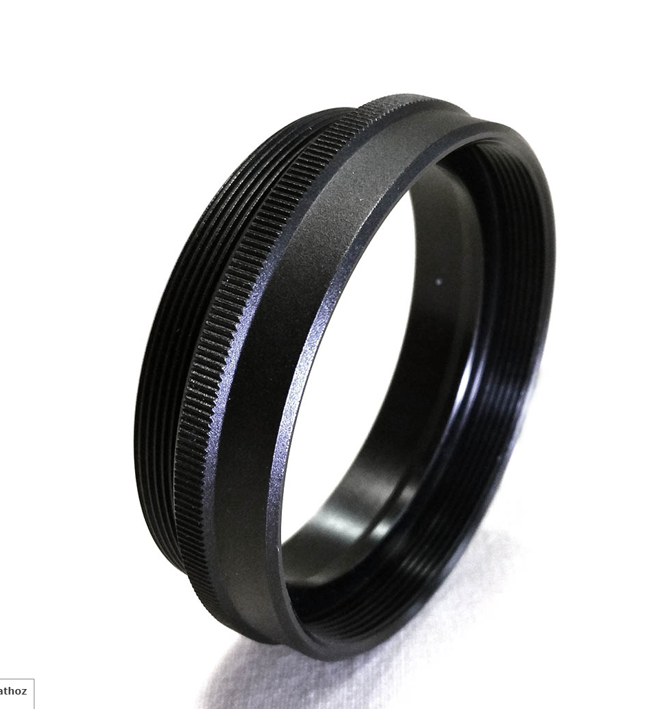

In order to get focus, you need to move the APM 2" Barlow 1.5x corrector about 3 cm away from the focuser. I use the APM 2" Barlow 1.5x corrector for Lacerta 200/800 photonewton. For the Lacerta Octo Plus 2 focuser, I use the screw spacer shown in the attached picture (3 pieces, which are 3x12 mm).  |
Hi Eric, as far as I know, the APM has a working distance of 95mm not 105 (source TS) ?  CS Werner
