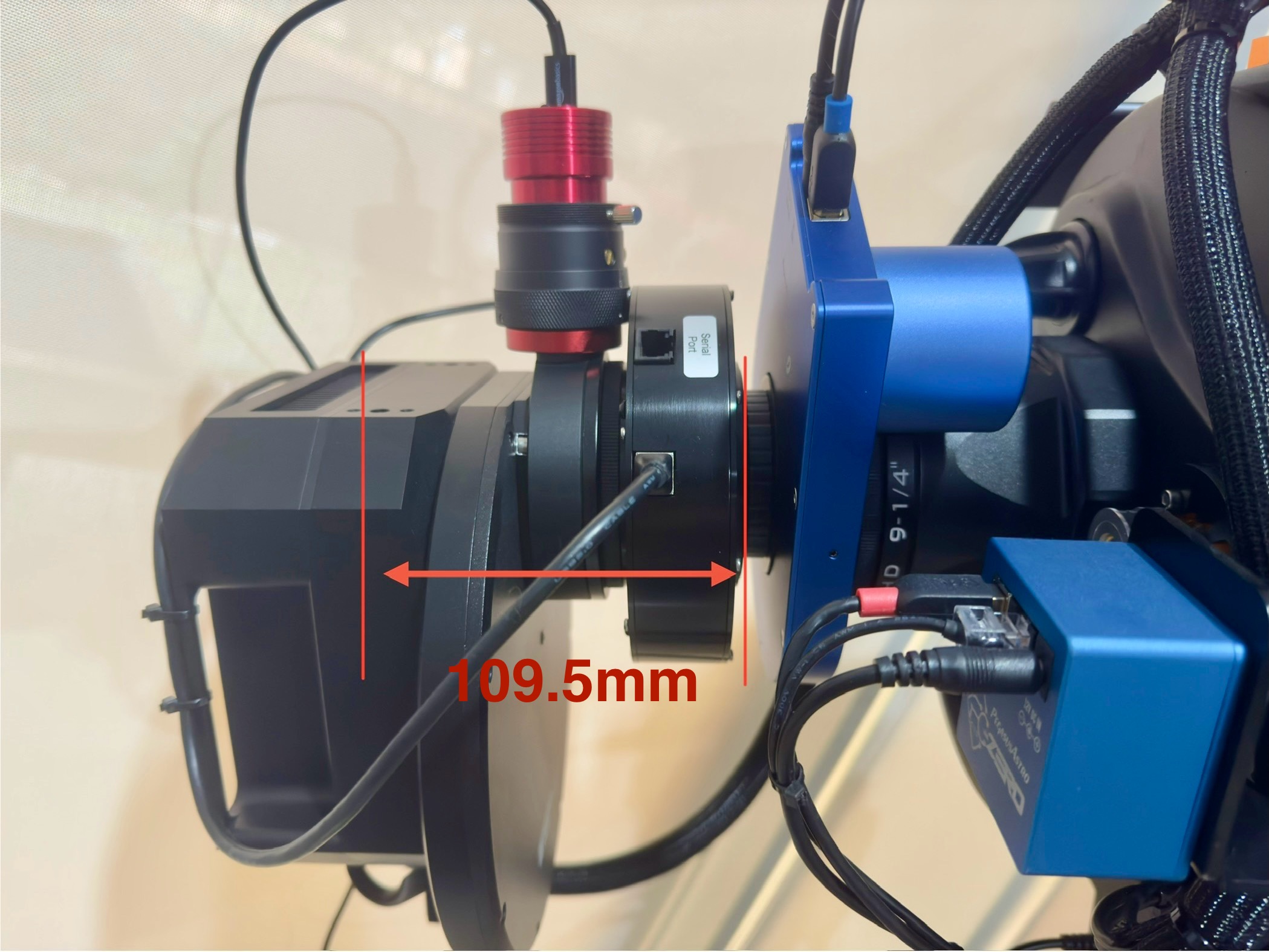

Hi Shastry, thank you for spending the time, I have considered that option, the only problem is that I have no space for it between the rotator, AO unit, off axis, filterwheel and camera I’m tight, only have like 12mm left for adapters. The CDK 12.5 is a beauty but like you said it will get pricey, I will also have to invest on a new mount which I’m trying to avoid, no many options out there I guess.
ashastry 2.81
The moonlite litecrawler and/or optec hercules have the rotator functionality built in, so you don’t need an additional rotator.
The hercules for example occupies 50.5mm of backfocus, leaving a reasonable 95.55mm of spacing. What is the backfocus consumption between your AO unit, OAG, EFW and camera?

I attached a picture with measurements, if I end up using the Hercules I’m going to have to sacrifice something else.IMG_3150.jpeg
CCDnOES 8.34
You could gain a bit by going to an Indigo guider. They are a few mm thinner. You might gain a bit as well by having a shorter Focuser to AO adapter made.

thanks for the response, yeah the indigo can definitely save me some space, in reference to the AO unit, I had an adapter made as short as possible, honestly don’t think I can get it shorter, I will work out some numbers with the indigo to see If I can make it happen,

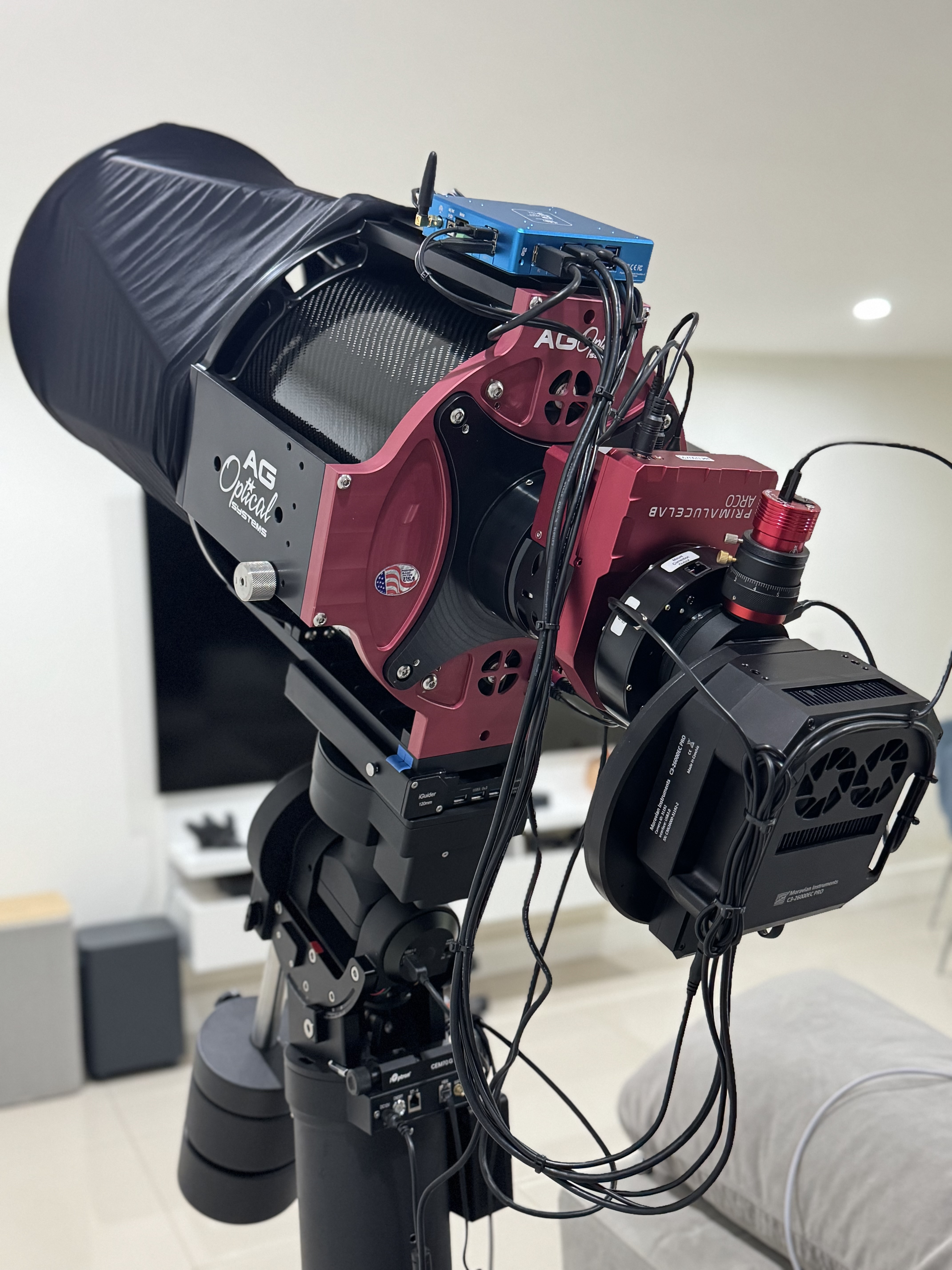

I was able to get my hands on a AG IDK 10” and it’s a piece of art, I’m almost done setting it up to be dropped off at a remote observatory, so far I’m very impressed with the build quality and looking forward to first light. Thank you for all the recommendations
