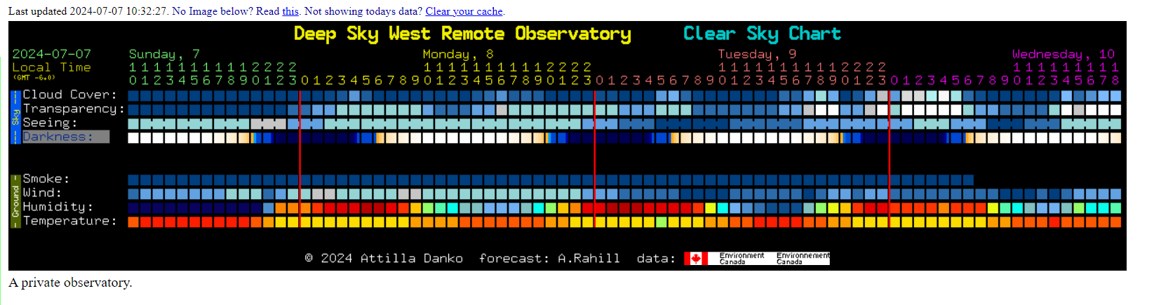

What did you do when you were at DSW--especially during the summer "monsoon" season? I've found that it's not unusual to have stretches of cloudy, rainy weather where humidity climbs into the 80s and 90s at night. Looks like we might be headed for a stretch of that this week:
When I first got out to DSW last July, I used to turn everything off every morning or for days at a time during long stretches of rain. I went out there about a month later to deal with a camera issue, and the weather was wet and humid at the time. When I uncovered my OTA, I saw that water had accumulated inside the dew shield next to the objective (thankfully, it wasn't quite deep enough to have reached the glass yet). That was when I decided it might be best to stay powered up through such periods. And Lloyd told me he would just leave everything powered up all the time 24/7/365. I haven't seen any more water accumulating since I have kept everything on. DSW is a very different environment from Obstech, both weather-wise, and also from the standpoint of how the observatory is powered.

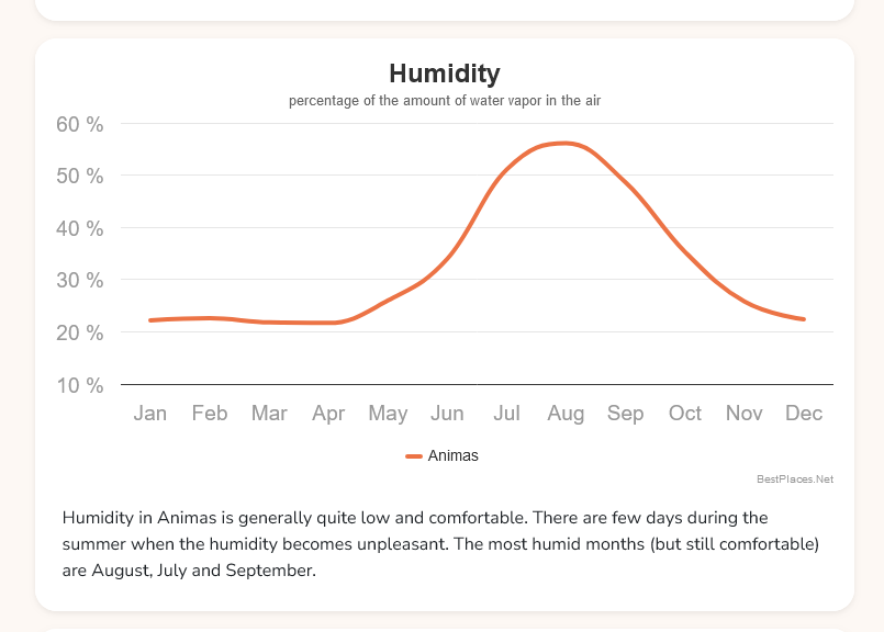

Jerry Gerber: At DSP Remote I don't think the humidity gets very high, but I could be wrong. I was told I would not even need dew heaters, but that may be only for summer months. Here's a chart showing highest humidity in August reaching around 56%. Interesting that it would be that different for you from what I see. But I guess being 200 miles north of you up on a mesa in the mountains is a significant shift. As you can see from the chart above, we're expecting over 90% humidity at around 1:00am early tomorrow morning. Again, I kind of go back to what your DSP guy, Ed Thomas, said in that thread--that power cycling electronics is generally harder on it than running it all the time. But your ambient temps during the summer may also be higher than mine, too, which is definitely a consideration. I think the lesson in all this is that if you ask five people this question, you'll get forty-three different opinions. I haven't yet seen anything in this thread that compels me to make a change from what I'm doing. But my mind is open. Time will tell.
Timothy Martin:
Interesting that it would be that different for you from what I see. But I guess being 200 miles north of you up on a mesa in the mountains is a significant shift. As you can see from the chart above, we're expecting over 90% humidity at around 1:00am early tomorrow morning. Again, I kind of go back to what your DSP guy, Ed Thomas, said in that thread--that power cycling electronics is generally harder on it than running it all the time. But your ambient temps during the summer may also be higher than mine, too, which is definitely a consideration. I think the lesson in all this is that if you ask five people this question, you'll get forty-three different opinions. I haven't yet seen anything in this thread that compels me to make a change from what I'm doing. But my mind is open. Time will tell. Maybe Ed is right, but it may be different for different situations. I've managed an electronic music studio for decades and always shut everything off before going to bed. On average my DAW (digital audio workstation) runs flawlessly for 8-10 years, as does all the other peripheral equipment, and that's with daily power-up and power-down cycles. But the equipment is always indoors with almost always very mild temperatures. Chris, the chief tech at DSP Remote, says he leaves everything on and never powers down and he's had no problems, although I don't know for how long he's been doing that. Temperatures are getting hotter and hotter, and scarier too, we were supposed to go imaging north of San Francisco this past Friday for 3 days but we cancelled the trip as the temperatures there were up to 114F. Palm Springs, California got up to 124F the other day. And it's going to continue to get hotter as the fossil fuels companies (and all of us, really) are continuing to thicken the atmosphere.
Jerry Gerber: Maybe Ed is right, but it may be different for different situations. I've managed an electronic music studio for decades and always shut everything off before going to bed. Doing my part to contribute to the climate change!  I've had a project studio in my house for decades as well. I never turn off my computers. I've had more than my share of computer issues over the years, but I can't say they were ever related leaving stuff on.

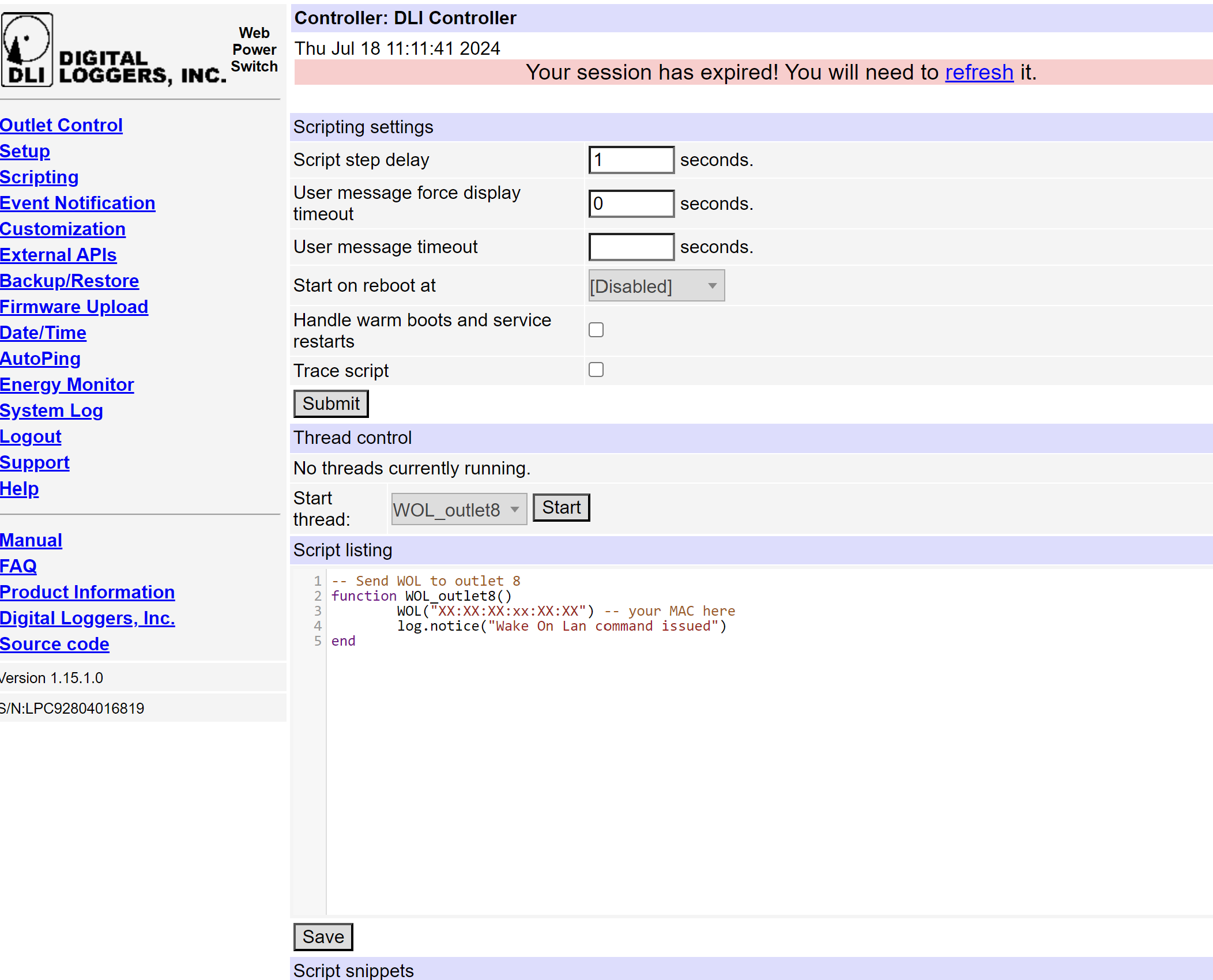

i may be late to the party, but finally got Digital Logger Pro to do everything I want. Getting Wake-On-Lan going was critical. Even if I leave the PC on mostly, I want to be able to shut it down in the summer months if I can. And regardless, turning it back on remote is sort of important. After setting Wake-on-Lan in BIOS and within Windows Network Adapter settings...I got Digital Loggers script going through that web interface. It seems fairly robust as I've been testing for a bit now. Here's the snippet below. -- Send WOL to outlet 8 function WOL_outlet8() WOL("11:AA:11:aa:23:gf") -- your MAC here log.notice("Wake On Lan command issued") end  I know i'm about the 4995th person to circumnavigate this, but just in case its helpful...
Nick Grundy: i may be late to the party, but finally got Digital Logger Pro to do everything I want. Getting Wake-On-Lan going was critical. Even if I leave the PC on mostly, I want to be able to shut it down in the summer months if I can.
I know i'm about the 4995th person to circumnavigate this, but just in case its helpful... I must be missing something. I use a Digital Loggers IP power switch as well but I don't understand why is this needed? I just set my PC to boot on power up in the BIOS so that when I turn on the power through the IP switch, it boots. When I'm done, I shut it down from Windows. My IP power switch isn't affected by a loss of power--other than it simply reverts to everything off. I just have to connect to it to turn everything on when the power comes back on and I'm ready. John

Jerry Gerber: All good. I got some help from Chris, the chief tech at DSP Remote. He's sharp and very generous with his time and expertise. I now have the capacity to turn on and off all gear from my desktop browser at home--without losing my remote connection.
Now on to the next problem....
Thank you all for your help and sharing your experience!
