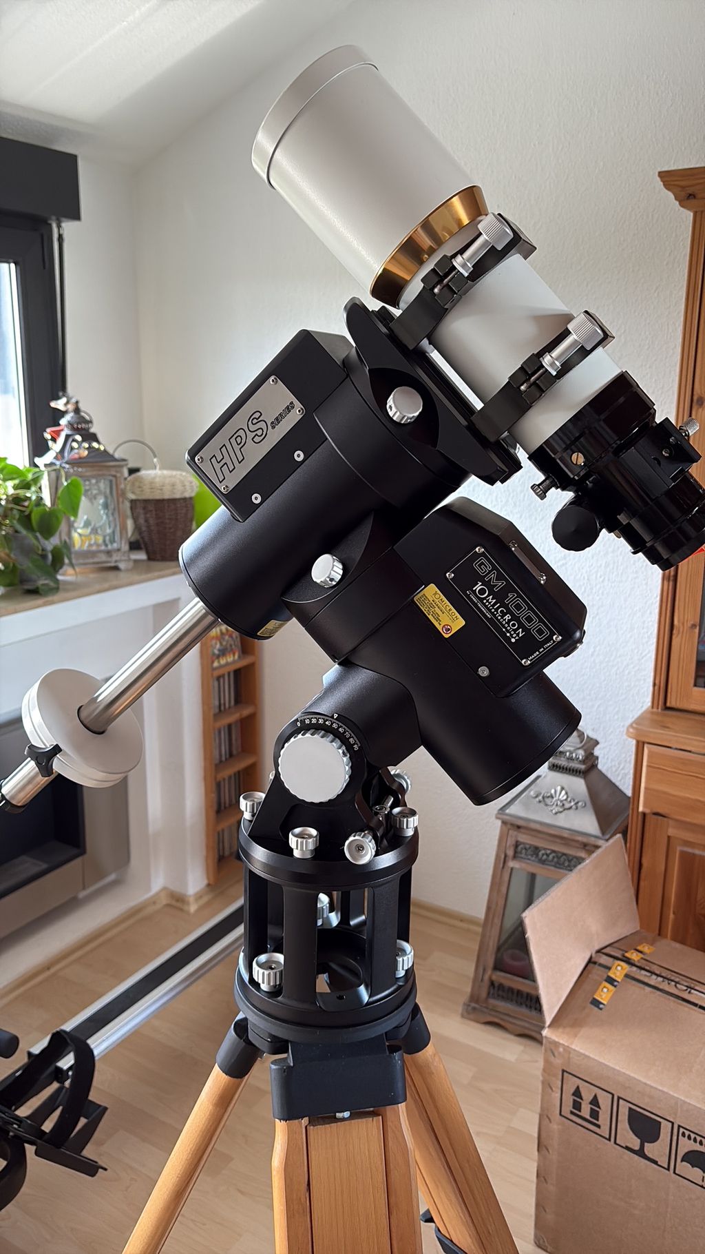

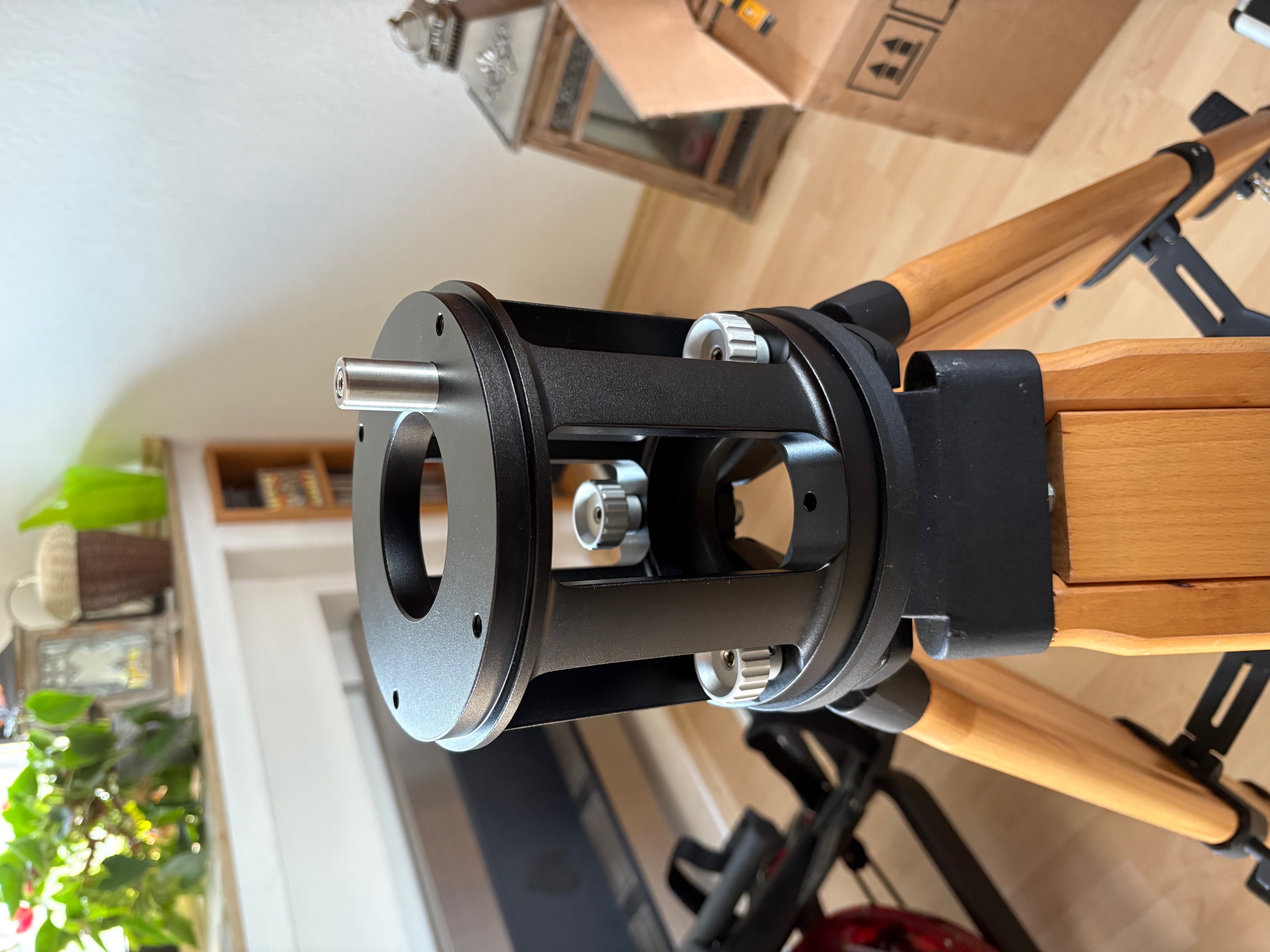

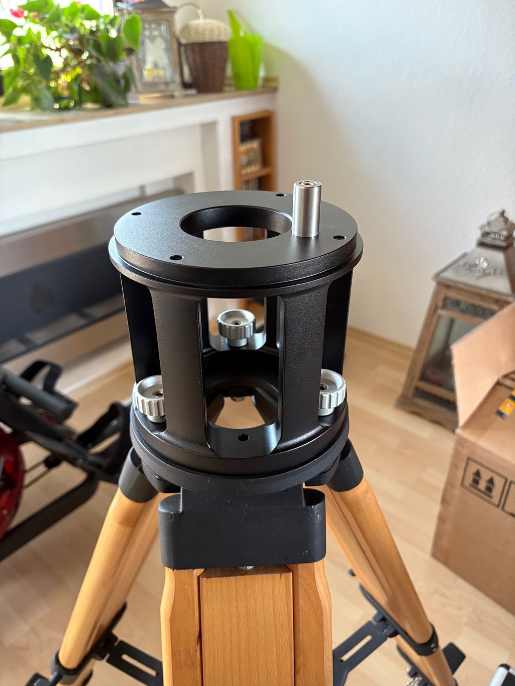

Hello, Thank you very much for your replies. I bought my GM1000 yesterday. At the moment, my AM5 is set up on the pier with an EQ6 extension. The AM5 with the extension is a bit taller than the GM1000. However, space there is already very limited. So I will definitely need an extension. I had hoped to find an adapter that would allow me to mount the GM1000 onto the EQ6 extension. Unfortunately, I haven’t been able to find anyone who can make such an adapter without requiring me to send parts of the GM1000. So it will probably end up being the expensive original extension. I'm also considering which device to get for measuring the environment. I’ll probably start a separate thread for that. Thanks again! Best regards, Brian |

You have spent a large sum of money on a 10micron which is an excellent precision made piece of equipment. Trying to hobble together miss matched parts to mount it on makes no sense to me. I also doubt you will find someone who is mass producing the adapter you are looking for and will need to find a machine shop to make it for you. Yes the extension is stupidly expensive but as I’m sure you are aware the platform you set your mount on is important too.

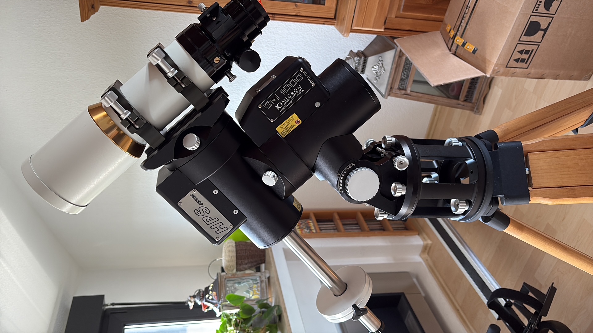

I ordered the PE for the 10Micron. Thank you for your help! |
1
like
1
like
That looks like a tasty combination! Congratulations!
