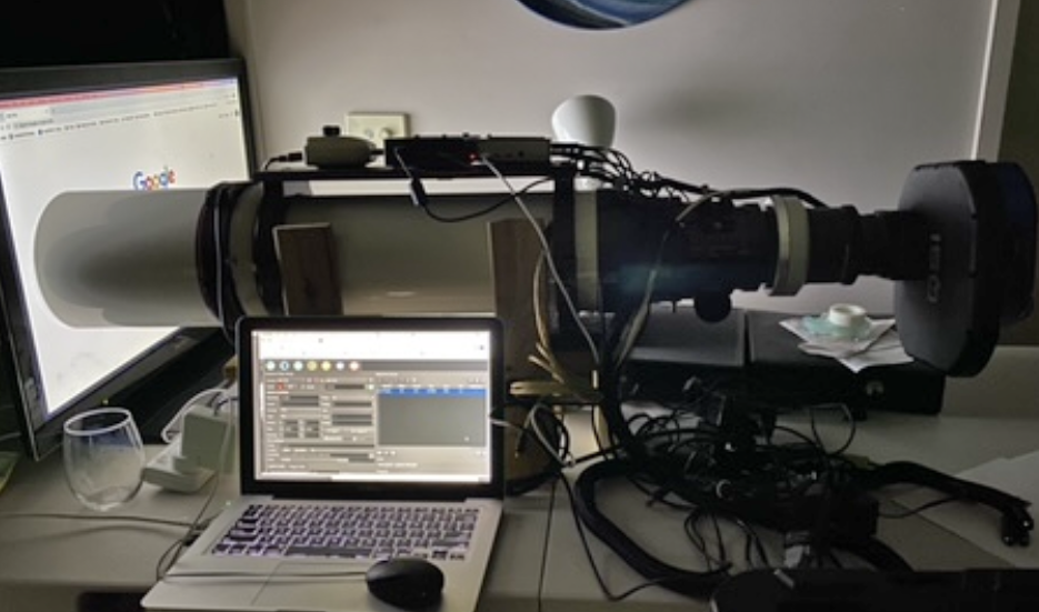

Andys_Astropix 14.17
·  6 likes
I used to have the same problem. Solved it by using my SpaceX Falcon 9 t-shirt, which is charcoal grey in colour.
Nowadays though, I do them indoors using an old LCD TV connected to my laptop.
Just boot up the google homepage and point the scope to the white area beside the logo.
Viola, perfect flats every time, same exposure times all year round too!
