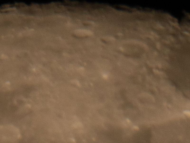

Towards the bottom of my image, the lunar details look less sharp than elsewhere. I thought it might be that I had not allowed the C6 tube to reach ambient temperature.
I was wondering if more experienced members might think the same. Perhaps there is a better explanation...

The moon only subtends a half degree so the light at each point in the image passes through almost the same volume inside the tube.  No matter where it occurs in the tube, turbulence will affect sharpness nearly equally over the whole image.  What I see in your image looks more like it might be caused by a sensor that is tilted with respect to the image plane.  How is the camera mounted and what optics are in the light path?

The Nikon D5500 camera attaches to a Nikon "T" thread adapter. That screws on to a Celestron SCT visual back with "T" thread. It seems to all be firm and secure.

Ok, thanks for that description.   I'll assume that you aren't doing eyepiece projection and that you are imaging at the prime (Cassegrain) focus of the C6.  Your image shows a lot of blur across the image so something is out of whack.  Have you ever put a high powered eyepiece on the scope to look at the optical alignment?  At the most basic level, a defocused star in the center of the field should show a nice symmetric donut.  That's probably the next thing to check.

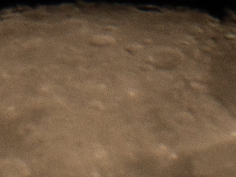

I got the chance to take a few quick snaps last night but the results were inconclusive. I rotated the camera between taking the two shots sampled below. I did not change focus between shots. So, one crop is from the top of the field of view, the other is from the bottom and rotated. It's hard to tell but I can't really see a distinct difference in focus.
I think I need a higher moon on a night with steadier air to do meaningful tests. One day perhaps...

I think that the best procedure is to focus, take an exposure and then rotate the camera 90 degrees.  Then refocus and take the second exposure.  You want to see if the image remains in focus across the field and to see if the defocused part of the image appears to remain stationary or to rotate.  Achieving precise focus is critical.  How are you focusing?
