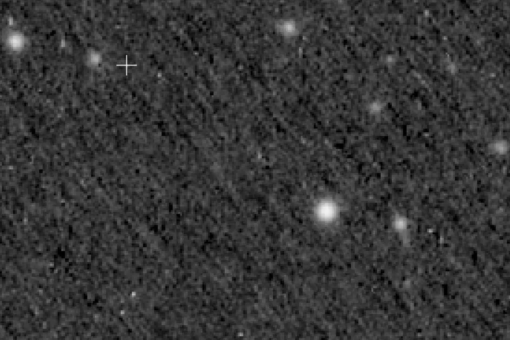

I took some images last night and woke up to some strange noise. My brother thinks it may be dew. Any ideas? This is a close up view of the Sii  and the Oiii but less magnified.  |
This looks like walking noise. Are you dithering in between images?
yes. every frame 10 pixels.

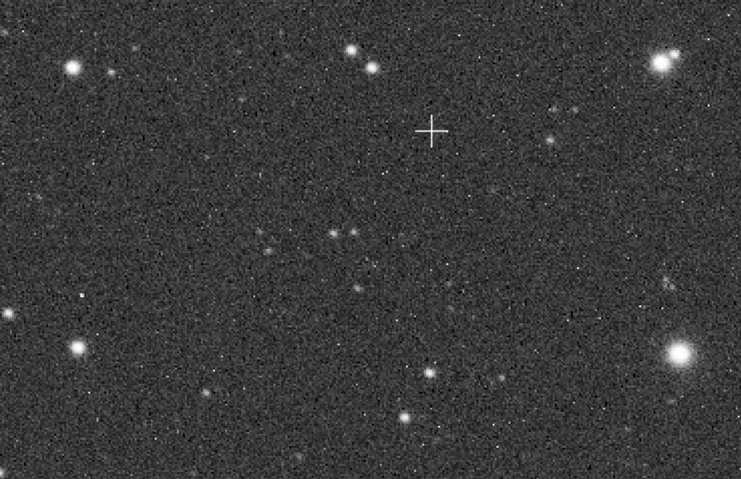

Is this the integrated or single sub image? If it's the integrated, can you show how it looks in a single sub?

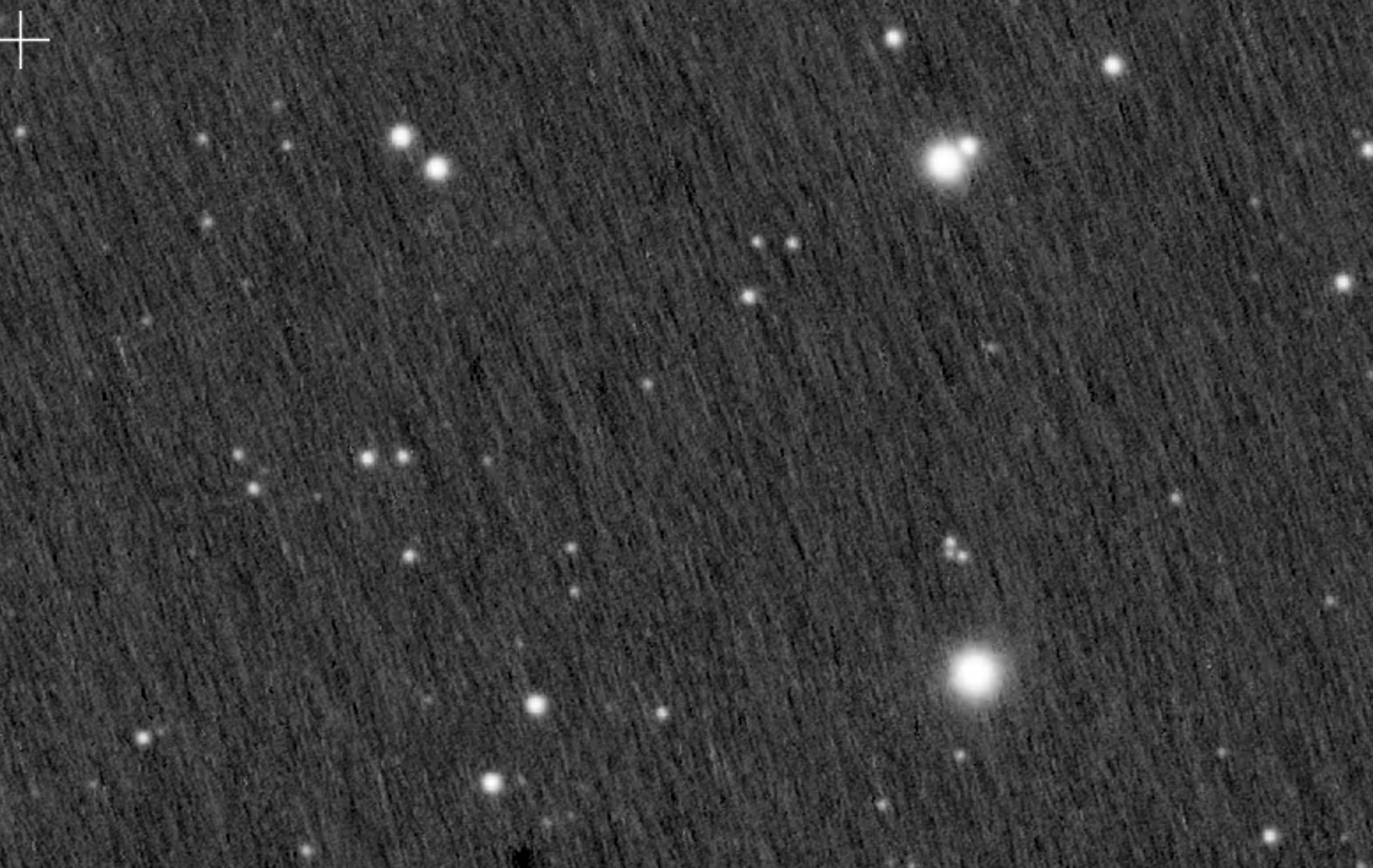

Here is an integrated frame and a single sub of ~ the same field.   |
You are doing something very (too) agressive against noise. So do tell us what is the processing pipeline.
Were you dithering both axes? What program did you use to stack the images? Looks like the brightest pixel was used for the final result instead of the average. Dan

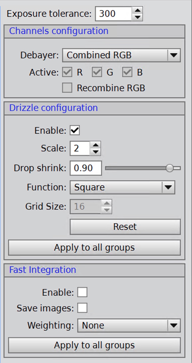

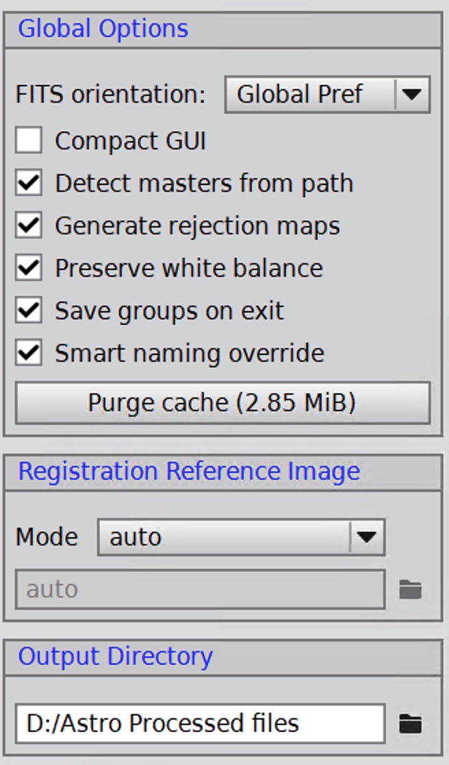

I stack with weighed batch processing script in pixinsight. I use flats and darks. Drizzle x2 is checked. I tried with and without linear defects correction with no difference...   |

Can you disable drizzle for now and set the exposure tolerance to 1 to avoid integrating different exposure times?
Ah well, WBPP is no-man's land to me. But definitely isn't dew.
D. Jung: Can you disable drizzle for now and set the exposure tolerance to 1 to avoid integrating different exposure times? I'll do that now.

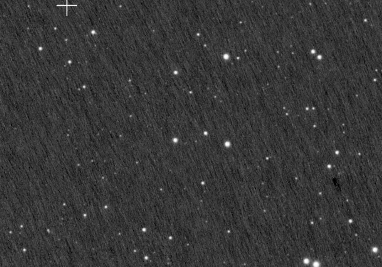

Have you checked that your dithers actually happen? This looks like a textbook example of walking noise due to insufficient dithering.
Blink your frames before registration and see if the data is actually dithered. Would bet some money on dithers not actually taking place here.
That's definitely walking noise. Your dithering isn't working properly.
Thank you. I will stop the dithering ad see what I get tomorrow.
Harry Karamitsos: Thank you. I will stop the dithering ad see what I get tomorrow. https://youtu.be/txATxNaNeMQ?si=Uup8LhE3dm6h6lgeBlink your images before registration and check if they are actually dithered.
