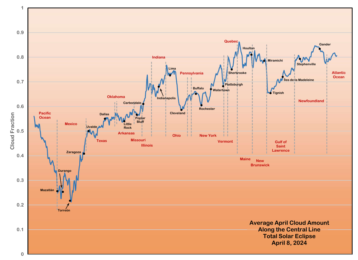

Phil, I was surprised to learn how (relatively) good the odds are in Cleveland. It’s maybe 3% worse than Little Rock. Kevin https://eclipsophile.com/wp-content/uploads/2021/02/Noam-centre-cloud.png |

Clear Skies, Phil Phil I went to the 2017 eclipse in Oregon to image it in totality. I plan on going to outside Austin to see and image it next year but Cleveland is my backup plan as my son lives there. If I were you, I would go just outside Cleveland near Lakewood and set up on the local beach. You should get a great view there. If weather is predicted to be bad in Texas, that is where I am heading with my 80mm refractor and sun filters. Bruce
I have learned long and hard NEVER to trust NE Ohio's weather for any sky events. I didn't see the past two massive aurorae due to our crappy weather.
The graph shows a drop in cloud cover because it's a graph of DAYTIME cloud cover. Lake Erie is mostly a cloud factory but it can suppress convective cloud formation in spring because the lake temperature is much cooler than the ground temperatures. Jay Anderson's site explains the process rather well.
The catch is that the same lake breeze that can reduce cloud buildup can also chill you to the bone this time of year. I'm not kidding. I was up in Avon Lake (right on the centerline) and it was 44°F along the shore while it was 60°F just five miles to the south.
If it's clear in both Ohio and Arkansas, I'll be in Ohio. But under no circumstances am I pinning all my hopes on Ohio's weather.
Clear Skies, Phil
I understand, I lived in Akon and Columbus for many years. Trust me, the weather is unpredictable everywhere as I have lived all around the US. You'll just have to keep an eye on things and make last minute choices and live with it.
