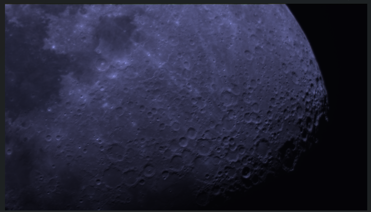

Important note if you are an Asiair user.  If you go the video route - don't use the ASIAir with the camera.  Asiair does not handle video beyond HD (1920 x 1200), so if you use it, you'll only get a small rectangle of the 6000x4000 resolution of your 2600MC.  Here is what ASIAir gave me on my 2400MC at 6kx4k setting - even though the full disc of the moon was in my full-sensor preview screen:
That would be a disappointing result for this event.
