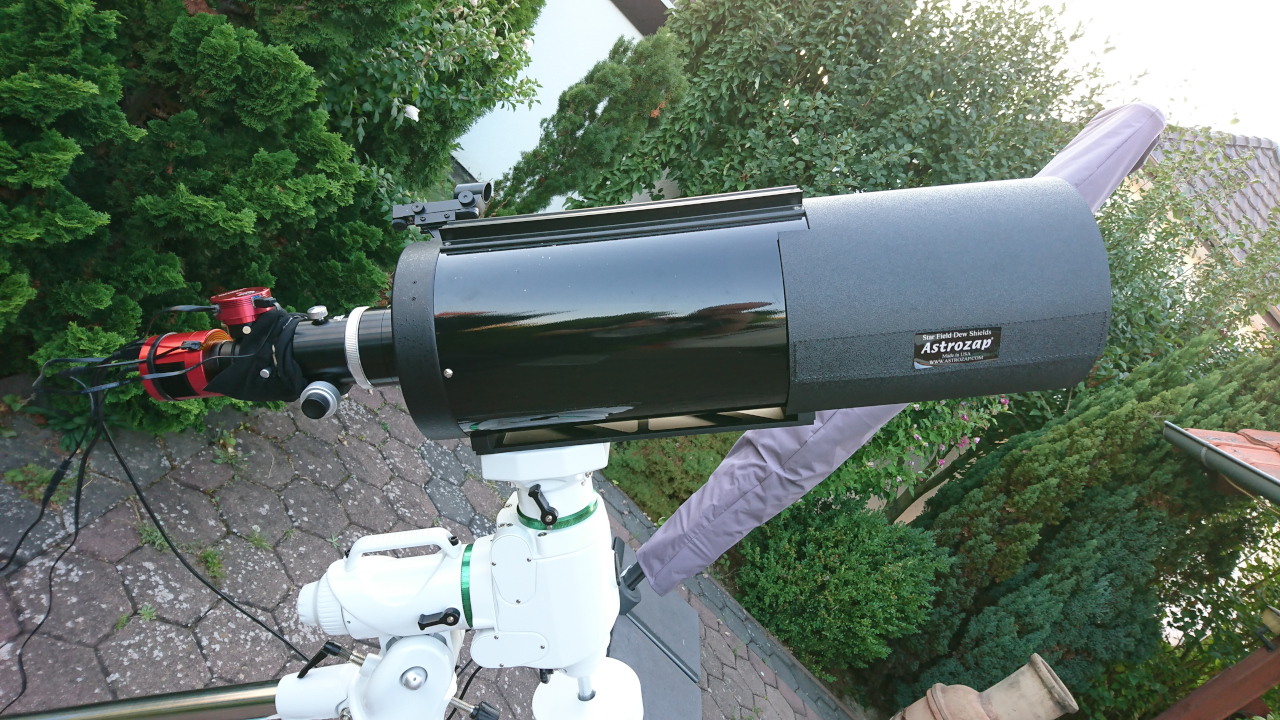

I remember when i first tried to find focus on my RC8. It took me hours - and i mean hours. The best way was to point the scope at the moon, add and remove extension rings while watching the histogram. When it moves to the right (even just a tiny bit) the direction is right :-)
You can check here what my distance was with a ASI294 (needs same spacing as yours):

You look like you have almost the identical build that I do in that picture…..  I have and ASI 120mm on the way but am using the Astromania guide right now.
