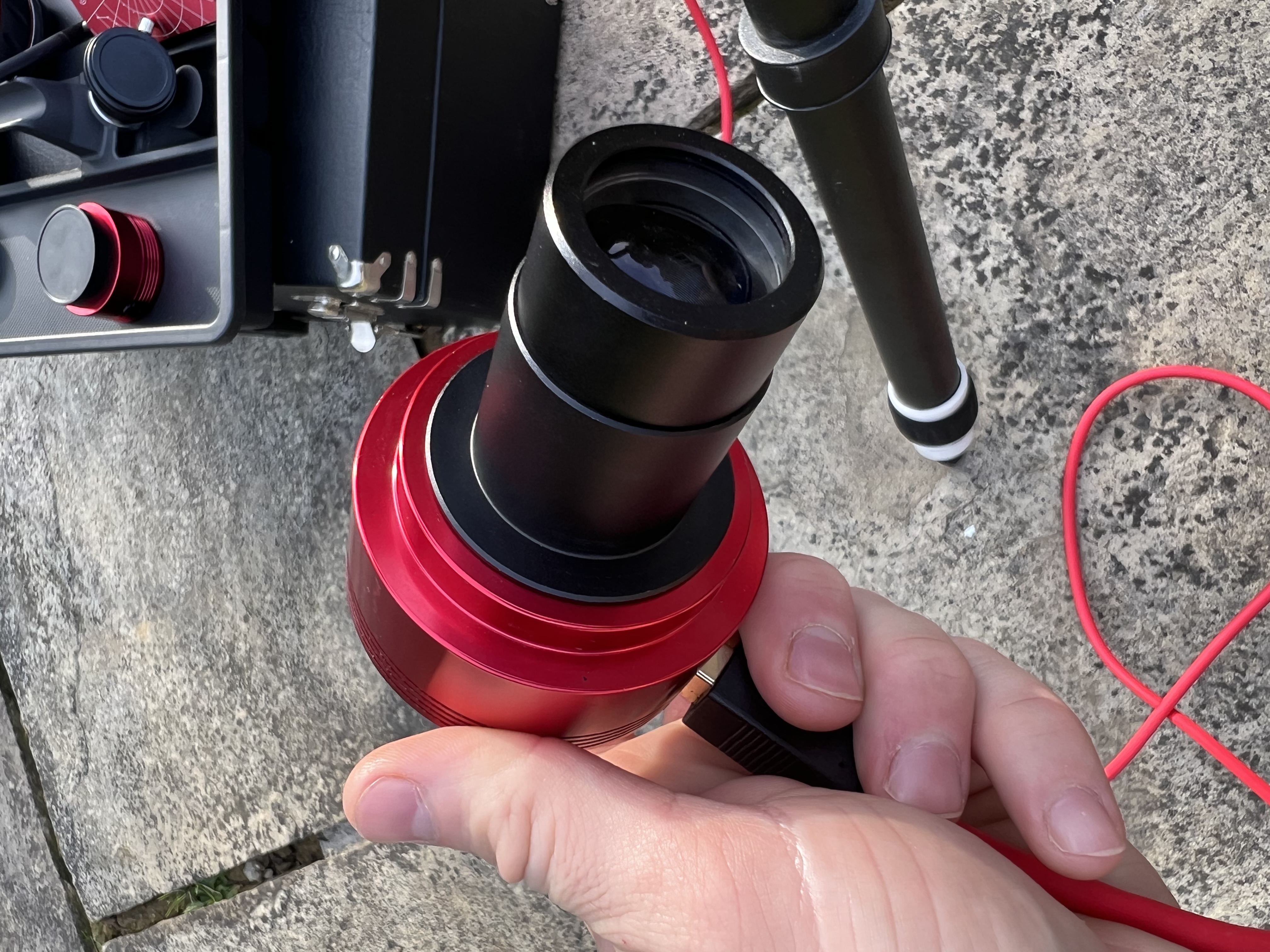

craigdixon1986 3.01
I’ve got the lens element from a 2x Barlow on the end of an ASI178MM nosepiece and inserted this all the way into the eyepiece holder on the Coronado PST but I can’t get anywhere near focus.IMG_7799.jpeg
sfanutti 1.91
I used to have this telescope. I couldn't get a focus for imaging, not even with eyepiece projection. The only success I had was afocally with a smartphone. In principle, stacking multiple images can greatly improve the results just like any other type of imaging. I recommend a smartphone eyepiece adapter if you want to try it that way.
LorenzoSiciliano 5.26
You may want to unscrew the eyepiece holder where the BF filter is, unscrew the underlaying barrel and then screw the BF filter directly to the PST black box.

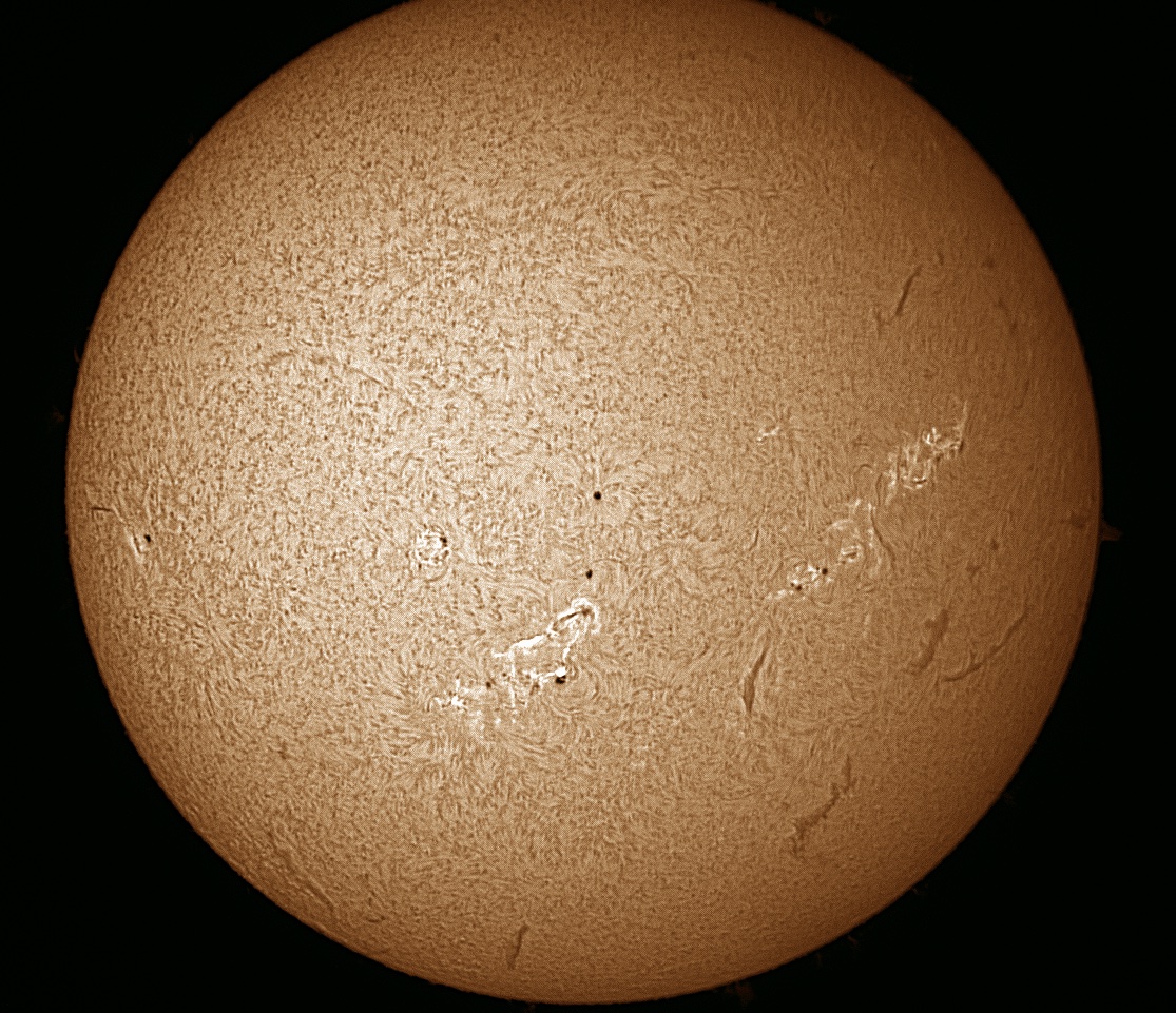

I just wanted to update this. I managed to find focus with my 120mm Mini. The key was adding a UV/IR cut filter (Astronomic L3 in my case). Without the filter, I couldn't get anywhere near. Here's literally my first attempt at getting an image. I'm kind of blown away if I'm honest. I know it's not framed very well but this was just a test image and has shown me that it's worth continuing.Sun-1 copy 2.jpg
Very good first light indeed!
Glad to know that you have addressed the focusing issue.

prjcole 1.91
@Craig Dixon
That's brilliant first image. Congratulations.

Starman609 6.65
Finding focus the first time in Solar Photography with new cameras or accessories is always a challenge. Make sure to record all settings so next time you can get right to imaging. Congrats on your image. Looks great.
