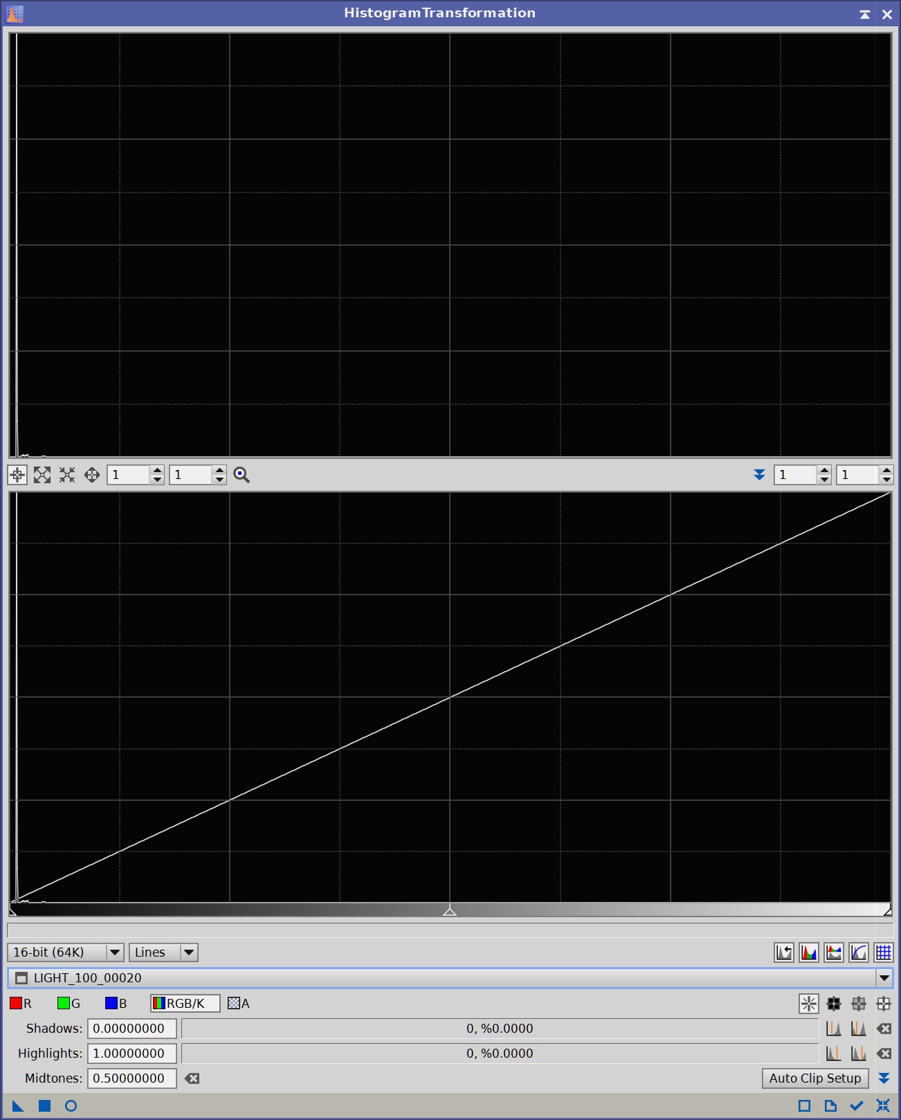

I have a Canon 90D (astro-modified) and an Astronomik 6nm H-Alpha clip filter. I'm using a Tokina 400mm f8 lens. I've got the ISO set to 100. The exposure is currently at 1/60s. I also have a solar filter mounted on the lens. Everything appears to work well, but I'm having issues with the histogram and how much I need to adjust my exposure. The light on the histogram is nearly to the left all the way. I think I'm under-exposing, but I want to see what others think.
Any advice or tips are appreciated. I pasted a screenshot of the histogram from Pixinsight. EDIT: Forgot to mention, the histogram below is from one of my light frames in RAW format, unedited.
-Crimsus
I think you should post an image of the stacked image unedited (assuming you have already stacked the individual frames together). But I think, at first glance, your histogram does not look right for the sun.

I had a moment of frustration and realized I deleted the folder, so all I have left is the screenshot of the histogram.
You mentioned it doesn't look right for the sun (and I agree something is wrong, but I don't have much experience with solar photos yet). What do you suspect is wrong? How should the unstretched histogram look for the sun?
Well that histogram looks like the histogram of a deep sky object linear image which doesn't make sense to me. I assume the histogram should be wavy and long(er) for bright objects like the sun and moon.

I was able to find another light frame from when I was testing out my SolarQuest. There's only one RAW image. I attached the RAW file. Below is the screenshot of the unstretched histogram. Here is the link to the RAW file.
It probably would do with a bit more exposure but if you are stacking a stream of raws that won't matter much to the final result. I see, however, that you are both underexposing and out of focus and don't forget to take flats!

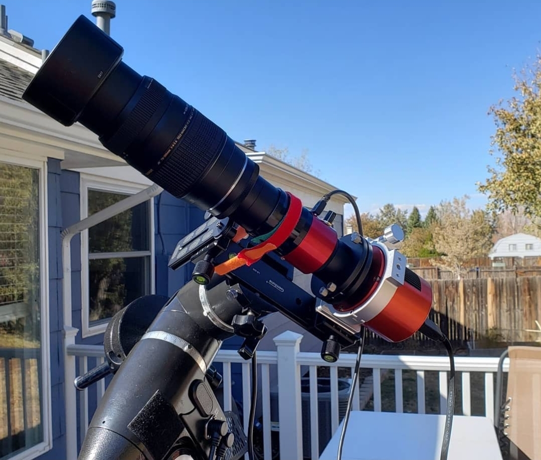

Here was a Daystar setup I had used at one point. This was a Canon lens, ZWO Canon EOS adapter, M42 extensions (I think?), Daystar Quark, tilt corrector, ZWO camera. You could easily swap the ZWO camera for a DSLR.Screenshot_20231116_220512_Instagram.jpg
