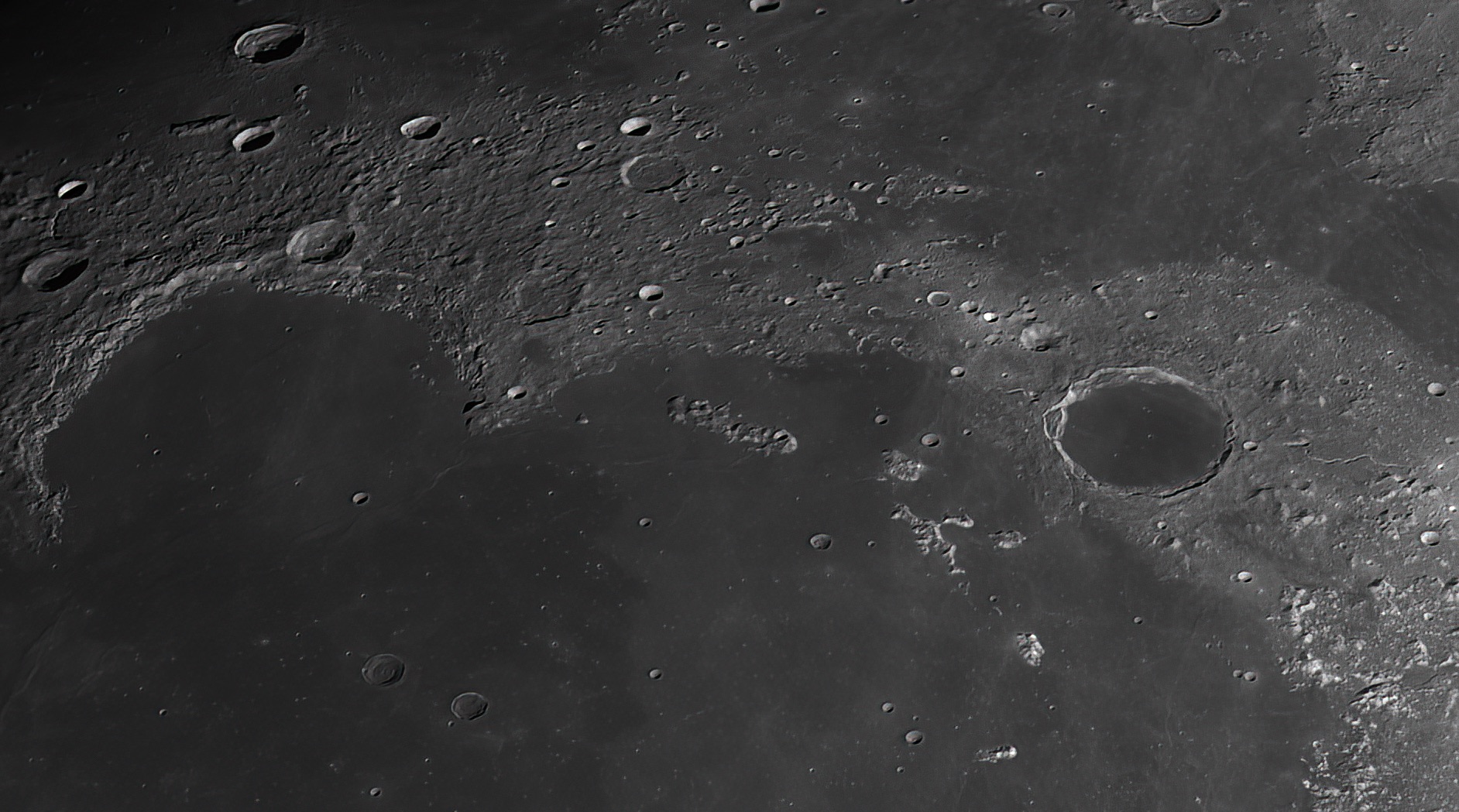

I'm not sure the moon needs videos.  It is so bright that you can capture a burst of well exposed still images (typically 1/640 secs) that can be stacked.  Here's one of my attempts:
Moon -- quick stitch of 30 shots on Sony NEX 5N through Skywatcher 200 PDS

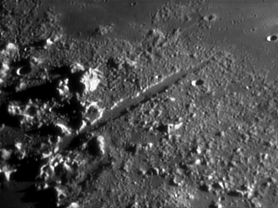

The moon despite being one of the darkest large planetary body out there does well at prime focus. High resolution imagery is another matter entirely so, yes, it needs video. Such as to get the rille running along Vallis Alpes:
