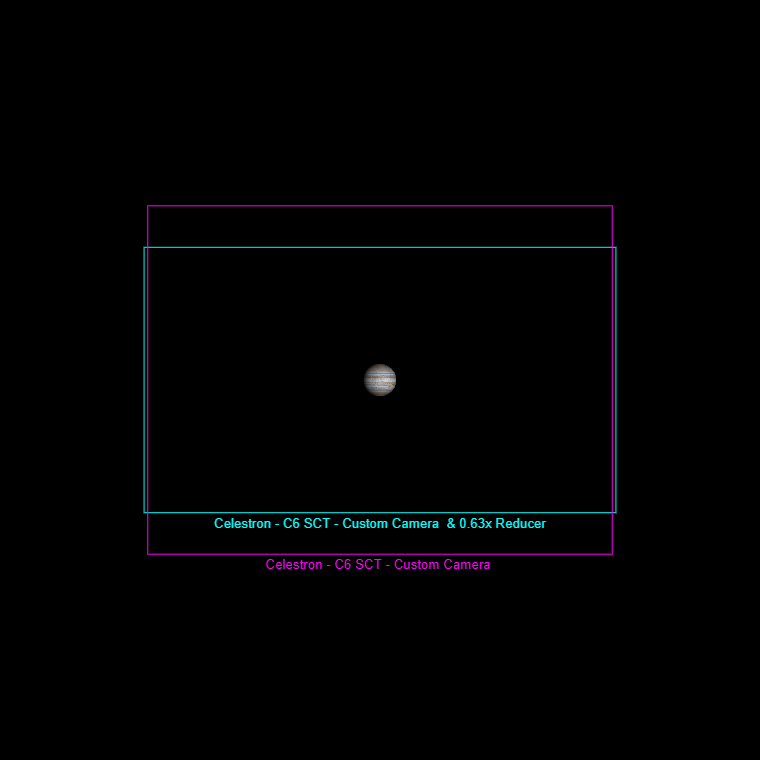

I recently became the owner of an Celestron C6 SCT (150mm/1500mm), and therefore have been able to explore the world of planetary AP. For acquisition, I have been using an cheap Astromania SGCMOS series color camera which markets itself towards planetary imaging. The specs are as follows:
I also own an ZWO ASI183MC Pro, which has a drastically larger sensor size that comes with higher resolution, albeit smaller finer pixels than the camera listed above (2.4um vs 3.75um).
My question is, when set to the same or similar capture resolution in software (SharpCap), is there any difference or advantage of using a "planetary" camera versus a general purpose Astro came such as the ZWO? When doing the math, the resolving resolution / pixel and FOV are comparable between the two setups, as demonstrated by this image created using astronomy.tools calculator:
(blue rectangle is Celestron C6 + ZWO ASI183MC Pro @ 1280x720px, violet rectangle is Celestron C6 + Astromania SGCMOS @ 1280x960px)
Theoretically on paper I could use my ZWO ASI183MC for planetary capture?

Yes, yes you can. Smaller pixels are an advantage too; they should give you finer detail. Mostly the advantage for planetary camera is they are cheaper and simpler; smaller resolution, no cooling. But if you already have a camera that matches those specs, just use that instead.
You should probably also not use the reducer when doing planetary video. Well, depending on whether you'd want the moons in a capture of Jupiter :-)

Thank you for confirming my theory! The reason I configured the preview calculator with a reducer was to achieve a similar FOV and resolution, but yes you are correct using without a reducer would yield even better results.

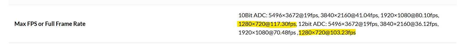

The pixel size is ok, but I gagged when I saw the max frame rate of that SGCMOS camera. For planetary Lucky Imaging, you can (and must) get better frame rates with a better camera. Processing a 3 minute video of Jupiter or Mars with 10,000 frames rather than 3000 frames will result in MUCH better results…
Frame rate matters little if the seeing isn't good and if it is really good then it matters little (let's say above 30 fps). Bit depth isn't that important, if at all.

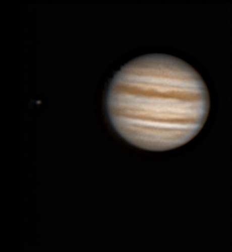

I recently got a C6, attached my 533 to it with a Barlow barely screwed on nose piece.
With a tight ROI on Jupiter it kicks out 160fps.
As a noob, My images rubbish images are limited by my ability to focus (or not) and my astro surface processing skils
Give it a try and see. You can always upgrade to a smaller pixel camera later.

Not a bad image at all! Lots of color in the bands. You should check out Wavesharp2 for sharpening, it's the successor to the widely known Registax which is no longer available or supported. There are some great tutorials on Youtube.

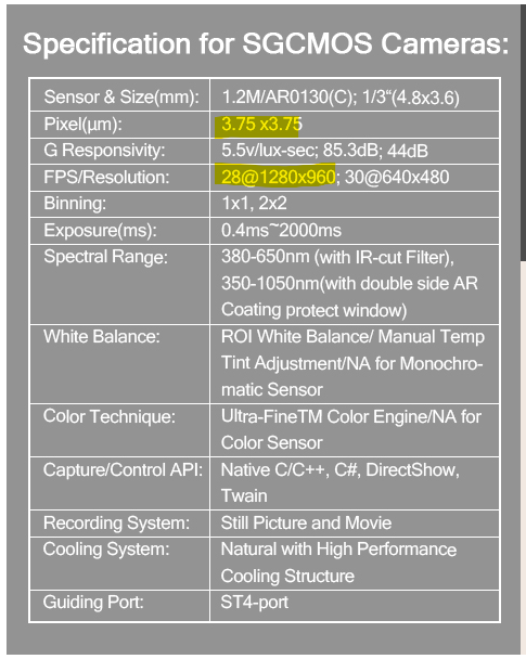

I hadn't thougt about taking Jupiters rotation into account, for my most recent capture:
Jupiter February 28th 2025
I captured 10k frames @ 28fps as shown in the Touptek camera specs above, this would equate to 10k/28 = 357 / 60 ~ 6min of video, which is above the rotation threshold as you suggest. I will keep that in mind during my next acquisition.
I have considered trying with a 2X Celestron Omni Barlow I have in my kit, however this would make collimation and focusing even more tricker. It's worth a shot.

A great start, Fabian, looks good! Glad if I could help.

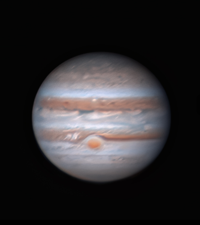

This is an example from my image with my C925 with 2 micron pixels and 1.5X barlow. I got reasonably lucky with seeing, though Jupiter was really moving around from frame to frame. Anyway, this is what it looked like at a 10 ms exposure, just one frame from my video. I could clearly see the bands with nice sharp transitions and the GRS, plus some smaller features. Note the edge is kind of fuzzy, I do not find the edge a good place to judge exact focus. In this case the resultant final image is on the right, which I was very pleased with.
What I do is move focus in and out and try to get the view the best I can. If I can see these details I am happy with that focus, it is probably the best I can do. I think the message is if you are still not sure of the focus after doing this, the seeing is not probably good enough, it will be really tough to judge anything. One night of good seeing will help you see what to expect.
