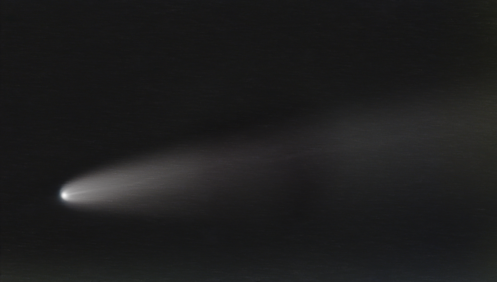

I used PixInsight to stack my best 100 sub-frames from the beginning of the session, used the Comet Alignment tool on the registered frames, Star Exterminator on the aligned frames, and integrated the starless images.
Then, I used DBE, SPCC, Blur Exterminator, and Gradient Correction, and finally, I processed the image using the HDR script.
This is what I got:
Needless to say, I was expecting something a little bit better.

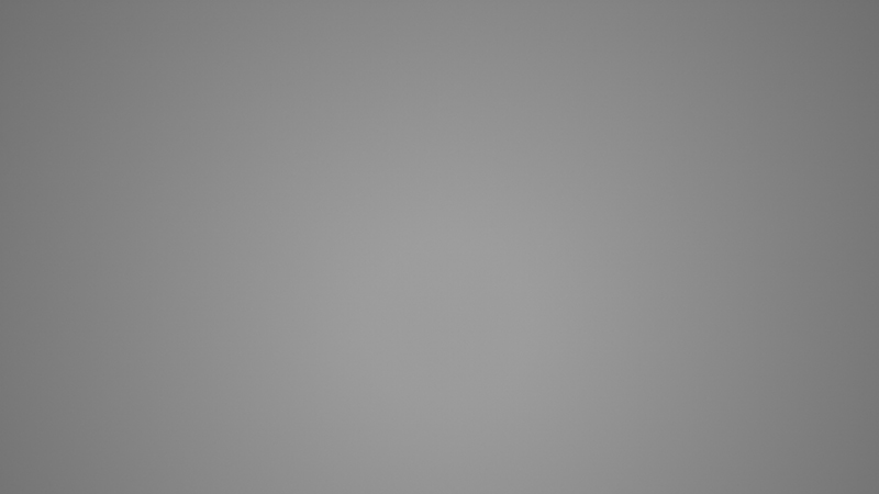

First, I have a nasty circular gradient at the center of the image that wasn't corrected by my flats.
It also doesn't really show on my flats:
Why is that? I took the flats at the end of the session when the telescope was almost pointing at the horizon.
Should I have raised the telescope to where to comet was at the beginning of the session to take my flats?

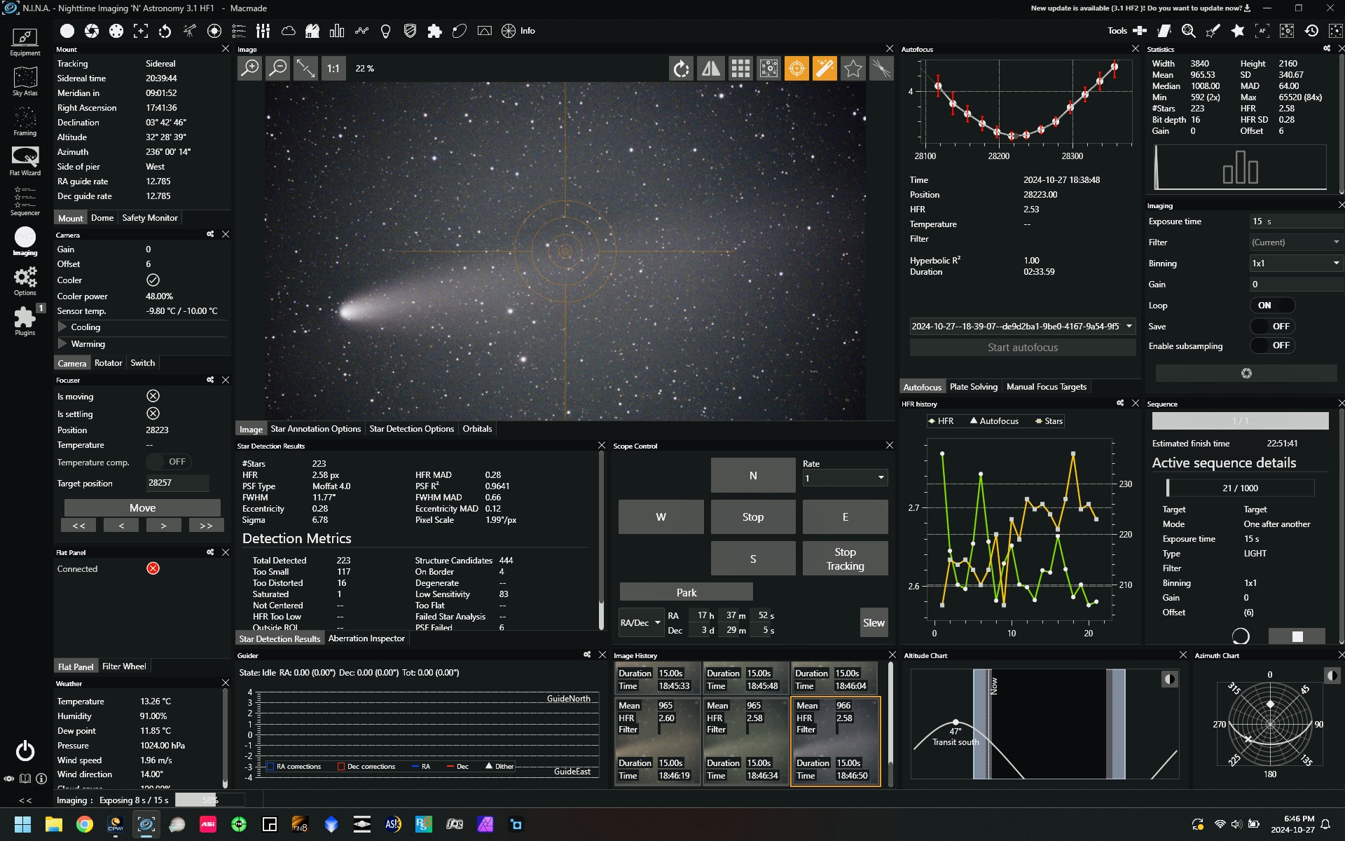

Second, it is pretty blurry. I used NINA's autofocus, but this was probably a mistake when I think of it now.
Should I have focused manually on the comet, like with a Bahtinov mask? How do you folks do it?

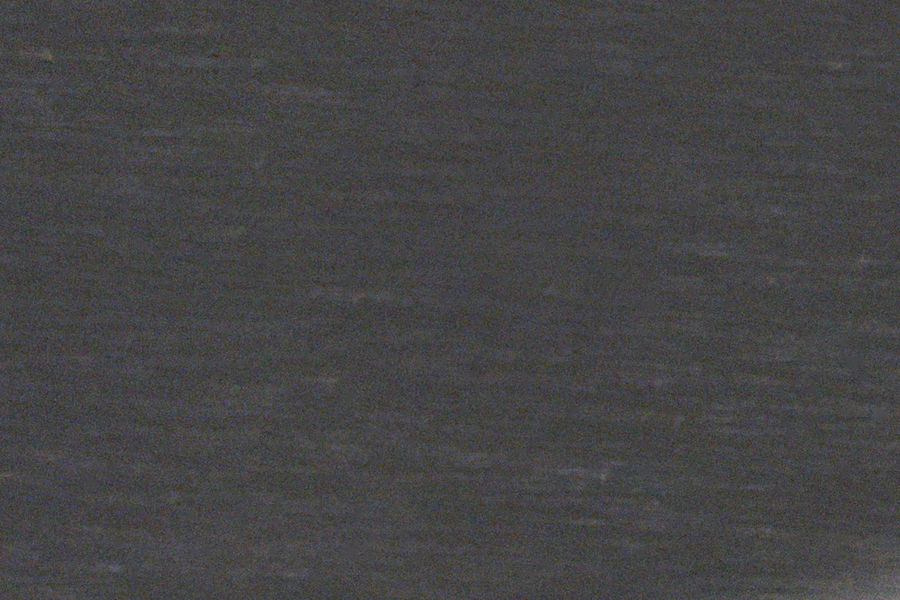

And last, I have a lot of horizontal lines in the final integrated image:
I guess they are leftovers from Star Exterminator since they are following the comet's motion.
This is more of a processing question, but how can I avoid that?
I used the same techniques in my previous attempt but didn't end up with such stripes.
